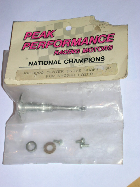

Any of you out there have the Peak Performance Slipper Elimination/Direct drive kit for the Lazer? I need the dimensions of the fiber disc between the two pulleys. Center hole I can figure, but thickness, and outside diameter I'm lacking.
Thanks for any and all help on this.

This is this part:

Yep, that's it. I have everything but the fiber washer, it decided to take a trip during a recent preventative maintenance episode.

Fiberglass plate:
Outside 11 mm
Inside hole 4.5 mm
Thickness 0.75 mm

I made a new spacer out of lexan, maybe it's not right, but it seems to work fine. :D
I'll be keeping my eye on it to see what it does, and how it wears.
