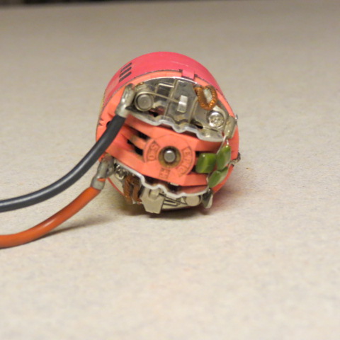

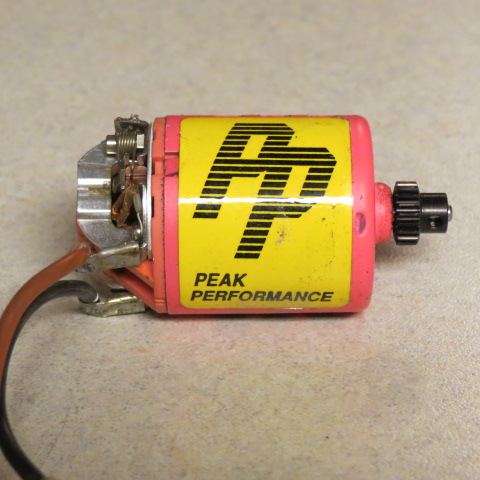

Can someone please identify this motor for me, along with specs? Thanks!!!

Pink can and lay-down (Slot Machine II) endbell = Trinity/Epic NORRCA stock (36*)
Should not say ROAR 91 on the can.
I think that the Monster Horsepower JR was a 24* ROAR, but with a pink or black standard slot machine endbell-
