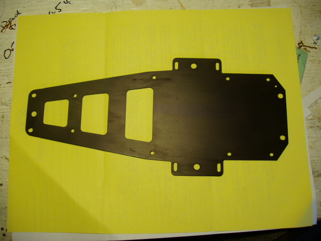

thanks bro . I sorced some shock collars. working on getting some JG radio trays to die. but I'm not sure what to use . Is it rit dye? Or fwill food coloring/dye work? I saw someone here with a black dyed JG radio plate that looked the beez kneez. I soo want to go to that track/meet but gota find the time. summers my $ making time ?;@)

bdrmbully wrote: working on getting some JG radio trays to die. but I'm not sure what to use . Is it rit dye? Or fwill food coloring/dye work? I saw someone here with a black dyed JG radio plate that looked the beez kneez.
Use RIT fabric dye. Available at Walmart, grocery stores or craft stores.
i just dyed my jg plate with two dye packs in half a gallon and simmered it for about two hours came out like the ace of spades

you boiled it for 2 hours? will it affect the shape of the plate?

it was as low as it could go i also placed mine on some flat stainless knives to keep it of the bottom the pan so as not to get the direct heat of the stove
