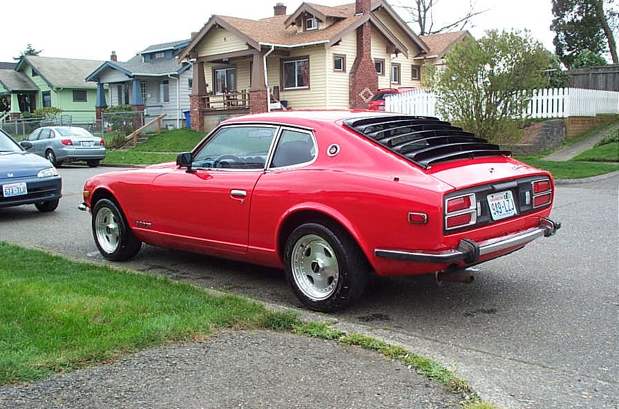

I had a 1982 280zx anniversary edition back in the early 90's... basically it was my first car. (this one's not mine, but it is similar)
My dream car is still a 1976 240z. One day I will have one!!
oops forgot to add pic. here it is.
