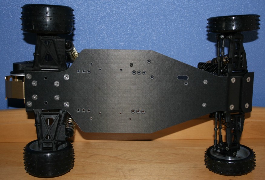

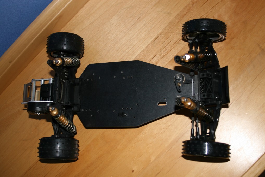

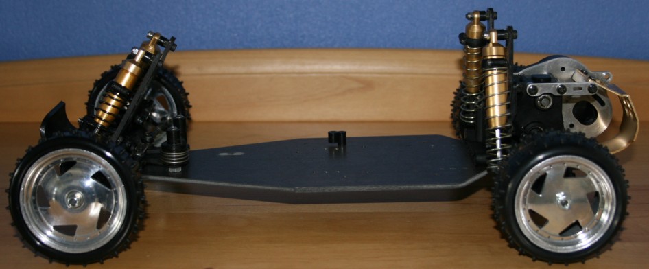

This is my Ultim Pro 1 as it stands at the moment, I originally planned to go box art with it but the arrival of a Duratraxs chassis has put an end to that idea. I have added a one off front shock tower made by Fibre-Lyte so I could use longer shocks and as you can see I found a home for my Sees wheels :D they look a lot better/shinier in real life.
The chassis increases the wheel base to around the same as an RC10 so the original body doesn't fit, does anyone have any suggestions what I should/could use :?: I might end up putting an RC10 shell on it :shock: I also need ideas for battery retaining the drilled holes in the chassis are too wide to use RC10 battery boxes :?

I'm surprised the body won't fit anymore: the pro2 was a little longer also but used the same body I believe.
Anyway : I just ordered me a desert gator body this weekend. I will let you know how it fits when it gets here. If that fits well, I'd recommend you a sand viper body. The looks are pretty similar to the original ultima 2 body.
Which wheels did you use originally?
They look like 4wd, 2.2's.
Since you live in the UK shumi battery straps should be easy to find.
Are you going to put the battery in the length?
I did that on all my ultima trucks: 10xbetter than sideways.
With the longer chassis and todays low profile servos it should be real easy. Kyosho made the same servosaver with the swivel arm pointing backwards. You might need that or an aftemarket saver.

Hi mr.ED, I think the body would have fitted if the previous owner had not cut the back off :roll: there must be a good 15mm extra on the wheel base with this chassis. I like the Sand Viper/Desert Gator shells that sounds like a good plan I will wait to here from you on the fit.
I think the wheels are Lazer ZXRs but don't hold me to that defo. 4WD wheels though, again the previous owners doing :roll:
As this one is only to be a shelfer radio instalation is no real issue, I want some form or battery straps to finish it off, I will try and get hold of the ones you suggest. :D
Thanks.

Yes, the Pro and the Pro XL (which had the same wheelbase as this one) used the same body, just the Pro XL had the rear body mount cut out further back.
Original wheels are Lazer ZX-R and the previous owner fitted them as the original ones were tatty and he never ran the car.
Having just tried one on mine an RC10 shell would fit just fine.

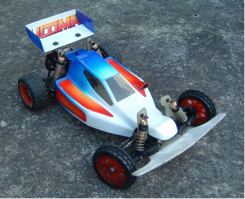

I also have a Duratrax chassis on my race Ultima, mine is the saddle pack version and it is also standard Ultima wheelbase. I use an Optima Mid Custom shell and undertray on mine, the body looks like it could fit a longer chassis. Excuse the horrible wide front bumper, you used to need a full width bumper to race to be race legal at BRCA Nationals.

Regardless of the width they would be no use for a runner, they had no bearings, mounted using a standard 4wd plastic hex drive.

Ed, those wheels are standard Lazer ZX-R ones and fit with a standard 12mm hex, makes the front end as narrow as it can get.

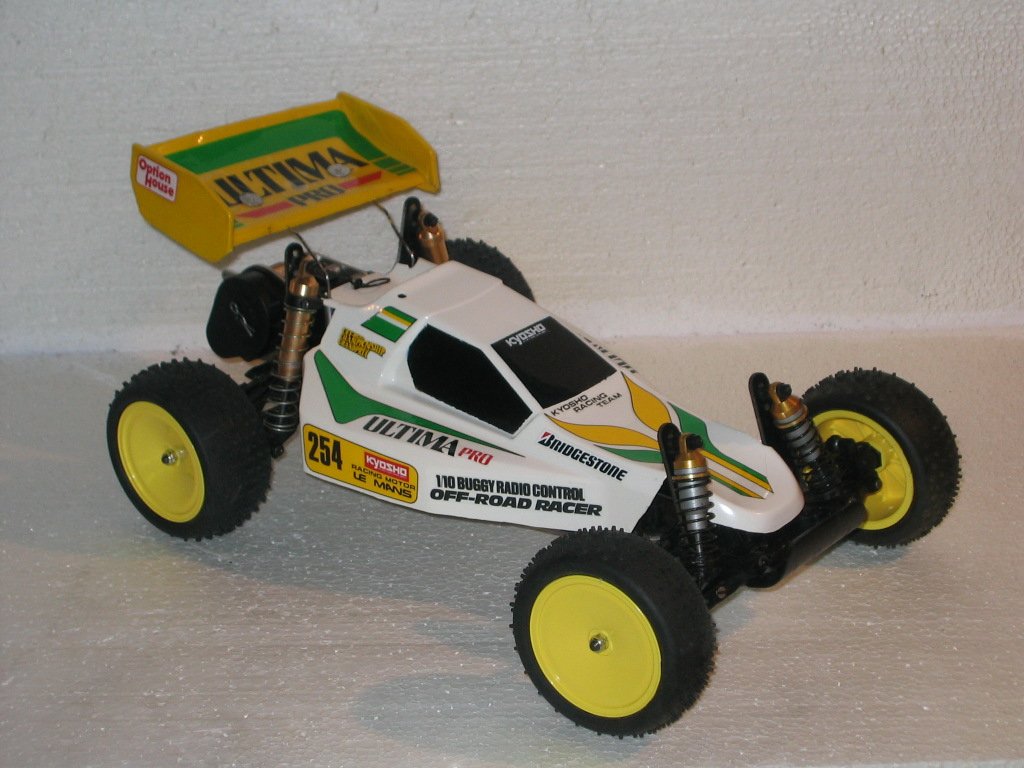

While I have the experts attention: who can tell me what was the difference between the PRO coming in a box with a white body pictured and the PRO coming in a box with a black body pictured?
Asso_man!
Posts: 3960
Joined: Thu Aug 03, 2006 11:49 am
Location: EU
Has thanked: 40 times
Been thanked: 82 times
Post by Asso_man! »
the Pro 02 came with the white body and the Pro XL with black body I think.
