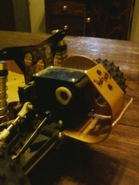

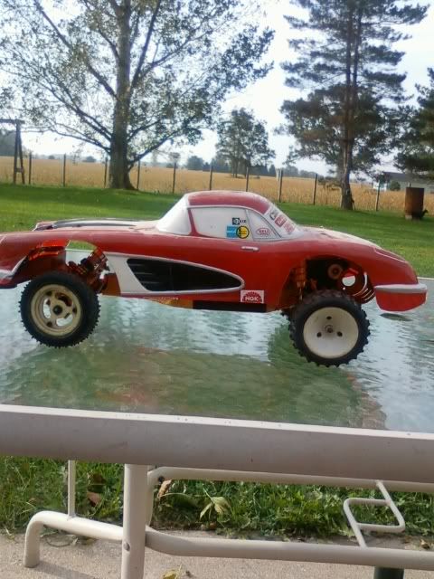

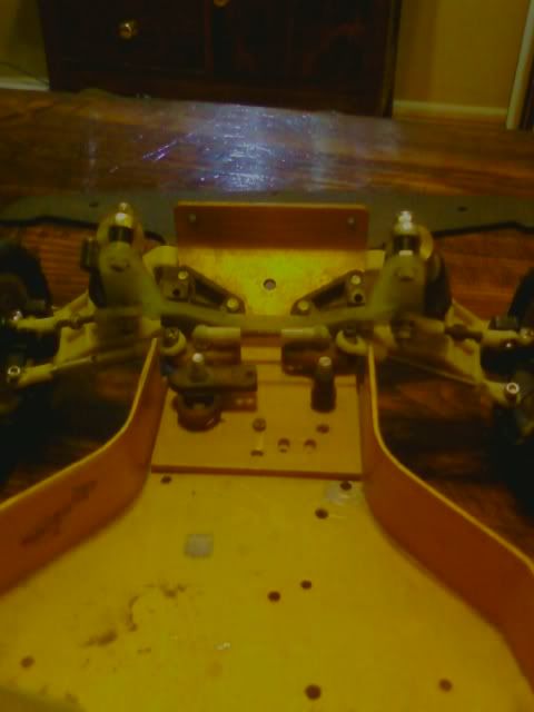

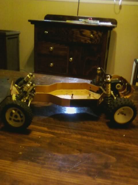

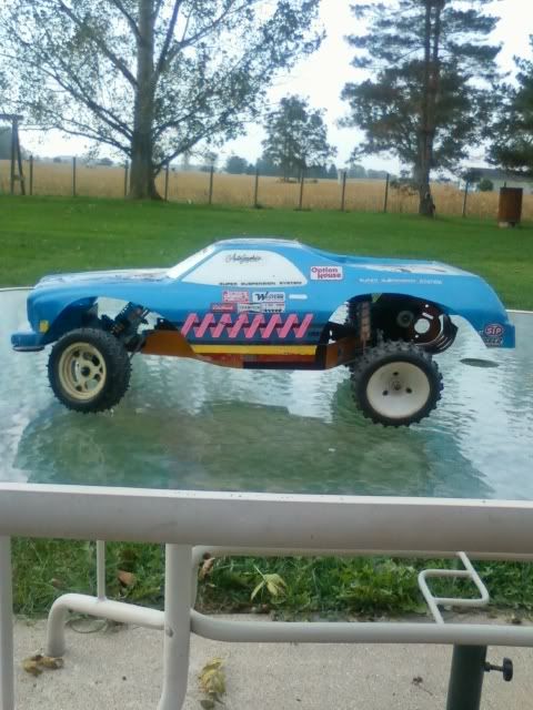

I just took 3 with my phone, since I have it rolling, and I have two from wen I was setting bodies on it to see how they would fit. The front bumper in the pics has holes cut so it'll fit other bodies, so I am assuming he didn't keep it as a buggy. Also, if it helps with wheels, the fronts say "Schumacher Reg Des 2002375" and the rear say "Kyosho sand super 340/30/20.m"

Man, that will clean up very nice. I would tare it down, redye the parts, clean and whiten those wheels, and put the el camino cover on it.
Download the manual from rc10.com (Associated's web site) and look it over to get an understanding of the car. There are a few screws missing from what I can see, but everything else seems to look pretty good...

Like TC said, just take it apart and keep a good count, and control (Baggies) of all the parts. I see that a few traxxas turnbuckles and Traxxas "Hinge pins" have been installed. Once you go through it, just double check the parts with the manual, and if you have a question, post a pic of what you are having trouble with and someone here will be sure to help out.

Nice catch with the hinge pin! Had to do a double take to see it.,...drbelleville wrote:Like TC said, just take it apart and keep a good count, and control (Baggies) of all the parts. I see that a few traxxas turnbuckles and Traxxas "Hinge pins" have been installed. Once you go through it, just double check the parts with the manual, and if you have a question, post a pic of what you are having trouble with and someone here will be sure to help out.

Those look like original 3piece front rims? - not sure you'll find tires except on ebay...the manual may say what diameter/width they are or somebody on the forums may know what tires would fit them and where to find them.
However on the front you can pretty much get any front wheel tire combo (probably be cheaper to get new ones anyway than to try and get vintage stuff) the only difference is you may have to get different bearings. I have set of RC10B4 discs (2.2") for mine on the original axles - all I had to do to mount them is change the bearings (3/16" x 3/8" - I think - unflanged but I think flanged work too). Avidrc.com has cheap bearings.
