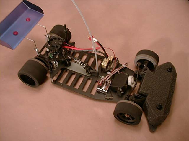

Fitting this car with a McAllister toyota body. Am I going in the right direction on the wing mount? I didn't want to drill any holes in the rear pod. So I made a mount using aluminum flat stock .

Looks pretty cool to me. I'd say you did the right thing. Looks more modified that way.

To make it more modified id put a row of holes along the rear edge for wing placement especially with different bodies.DON

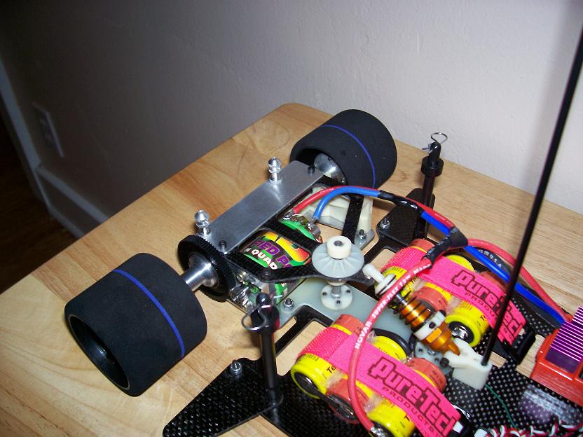

That is what those tiny holes were in the left and right Pod Axle mounts - for your wing (not the best method)
. But there were many manufactures that offered a replacement upper pod plates (HPI, CC etc.) with provisions to run a wing. I always ran one on my 235mm cars, especially with the Associated TOJ, BBR Lola, MRP Spyder and Bolink 962 bodies.

Everyone used a wing mount on the rear pod of an oval car back in the day. No one mounted them any other way, period. It wasn't until the last decade or so that people started mounting wings directly to the body.
2 holes in the top pod plate if they weren't there already. 2 Buds, TRC, Trinity or Tecnacraft wing bullets bolted to the pod plate directly, 2 square 1" holes in the rear window of the body and one Bud's wing poking out the back. We ALL ran them that way. Anyone who says otherwise wasn't there.

+1Eau Rouge wrote:Everyone used a wing mount on the rear pod of an oval car back in the day. No one mounted them any other way, period. It wasn't until the last decade or so that people started mounting wings directly to the body.
2 holes in the top pod plate if they weren't there already. 2 Buds, TRC, Trinity or Tecnacraft wing bullets bolted to the pod plate directly, 2 square 1" holes in the rear window of the body and one Bud's wing poking out the back. We ALL ran them that way. Anyone who says otherwise wasn't there.![]()

So thats what those holes are for . Looks off center that way.drbelleville wrote:That is what those tiny holes were in the left and right Pod Axle mounts - for your wing (not the best method). But there were many manufactures that offered a replacement upper pod plates (HPI, CC etc.) with provisions to run a wing. I always ran one on my 235mm cars, especially with the Associated TOJ, BBR Lola, MRP Spyder and Bolink 962 bodies.

Yeah they worked better on the 12L cars from which the 10L was derived from. With the 12L and the 10Lss it should be about right on centered.rctenracer wrote:So thats what those holes are for . Looks off center that way.drbelleville wrote:That is what those tiny holes were in the left and right Pod Axle mounts - for your wing (not the best method). But there were many manufactures that offered a replacement upper pod plates (HPI, CC etc.) with provisions to run a wing. I always ran one on my 235mm cars, especially with the Associated TOJ, BBR Lola, MRP Spyder and Bolink 962 bodies.
