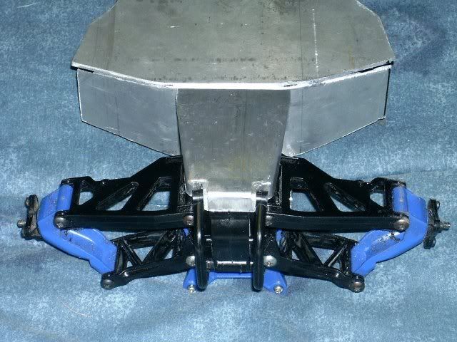

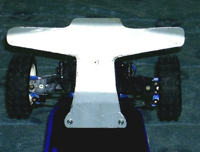

I 1st started by upgrading the fragile stock front bumper with a custom handmade aluminum one.

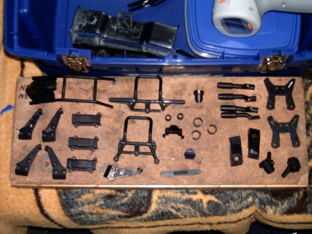

Then I worked on the shocks. The stock TAMIYA plastic shocks are not much to be desired. So upgraded to some TRAXXAS ones. :

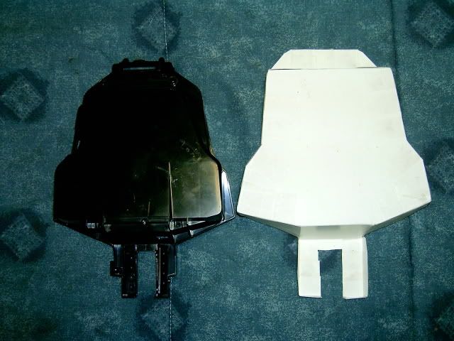

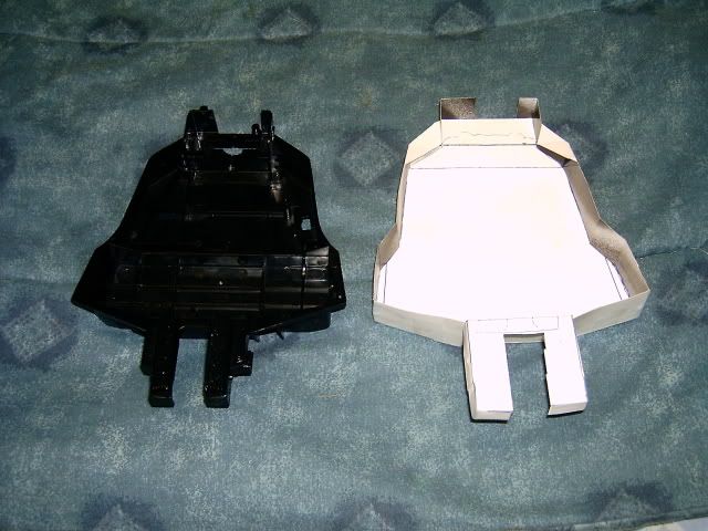

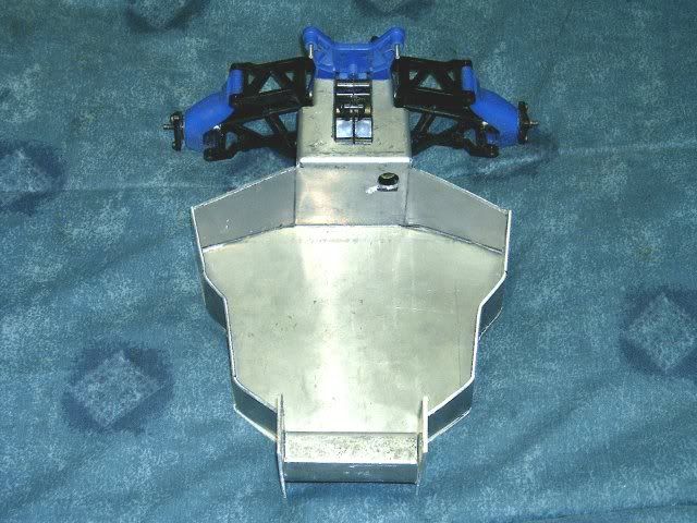

HI!... Well after breaking like 8 chassis's in 6 weeks I decided to build one from scratch out of aluminum.

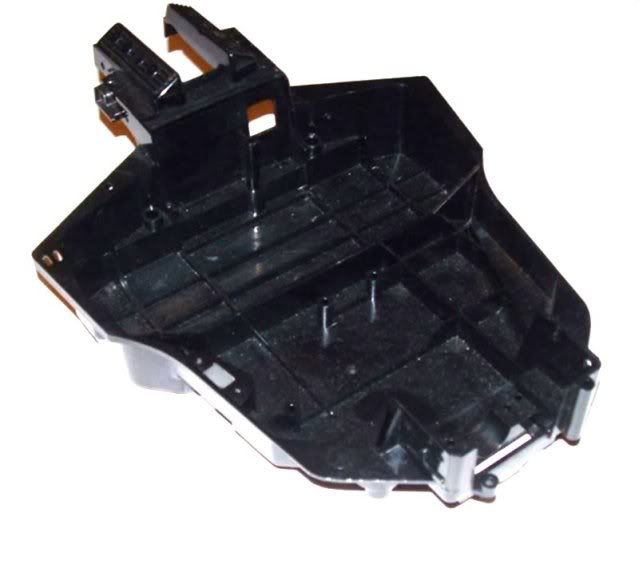

Here is what the stock chassis looks like :

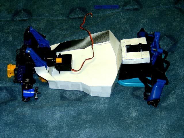

So I used some bristle board and started to mock one up :

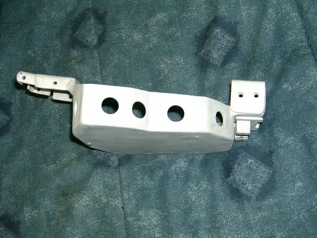

HI!... And aluminum fabrication begins. This was all done by hand. I do have a brake for the bends.

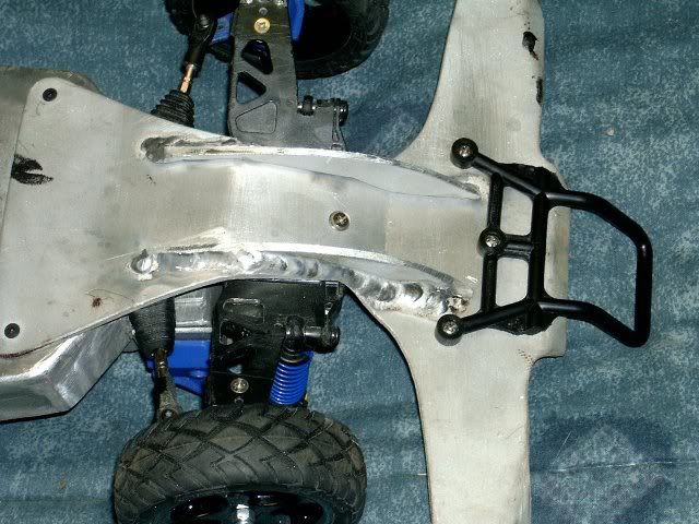

Post by THE H.P FREAK »
HI!... The chassis was all TIG welded inside and out. I then ground down the welds on the outside to make it cosmetically pleasing.

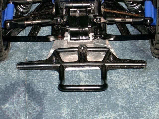

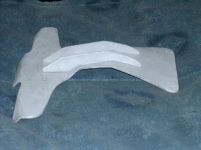

I made another front bumper. This one with some supports to keep it from bending on impacts. It is currently at my welders getting the supports TIG'ed on.

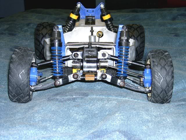

Picked up the tire/rim upgrade today. The stock tires are so hard, probably due to the rubber technology is 24 years old. lol! Getting the car up to speed is a challenge. It wants to go in donuts most of the time, even with the 4x4. So I looked around and found some TRAXXAS "ANACONDA" rims tires that come on the TRAXXAS "BANDIT VXL". I couldn't believe it! They are a direct bolt on. Same size as the stockers. Now I should be able to get some half decent traction on the road.

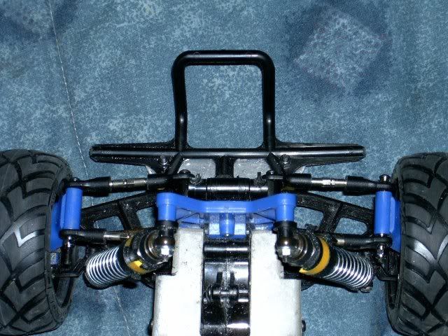

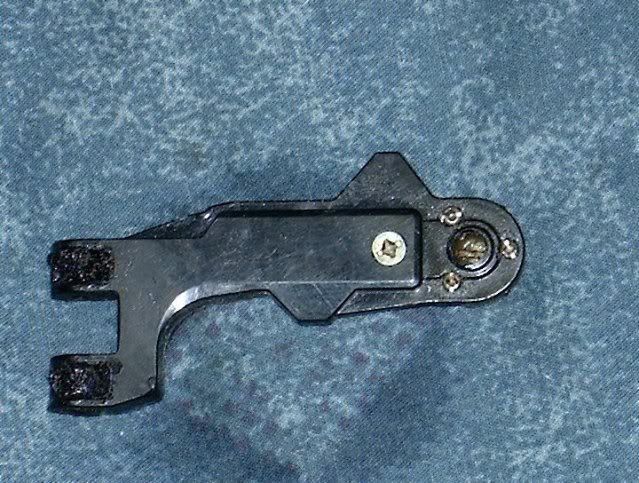

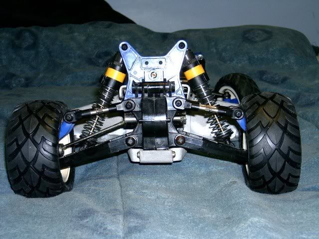

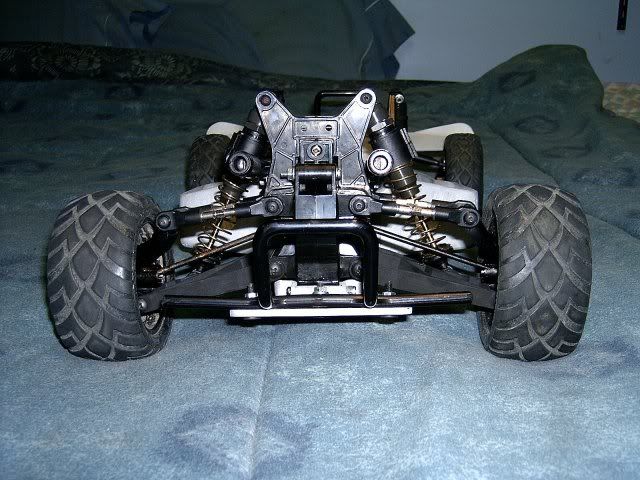

HI!... It's also been hard to find upper "A" arms for the front and rear. So back to TRAXXAS again and I got some turnbuckles. They had to be cut down to length but worked out perfectly.
Stock front upper "A" arm :
New fabricated TRAXXAS upper "A" arms :
Fabricated rear TRAXXAS upper "A" arms :

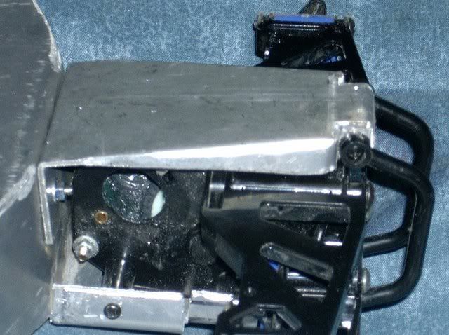

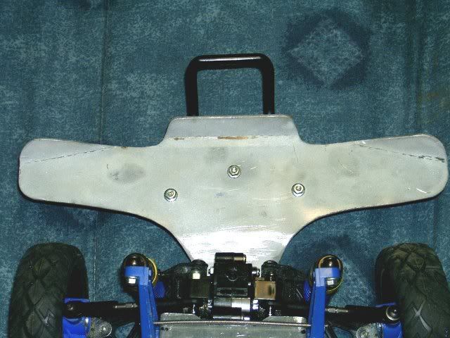

HI!... Well I got the front bumper tig welded up. Man is this thing strong! I also used two new "1984" TAMIYA "HORNET" front bumpers. These bumpers have a ton of flex in them and won't break. I trimmed both down and bolted them to the front bumper and made a aluminum plate to mount one on the rear. The BIGWIG rear gearbox does not like backing into curbs. lol!

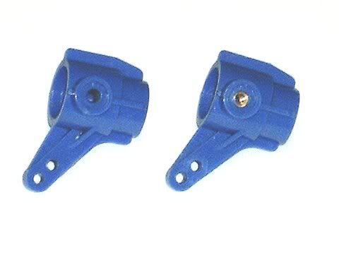

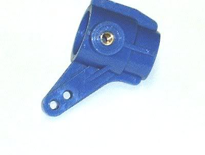

HI!... I also got the brass 3mm inserts installed in the front steering knuckles, so I can run my custom "A" arms made from TRAXXAS turnbuckles.

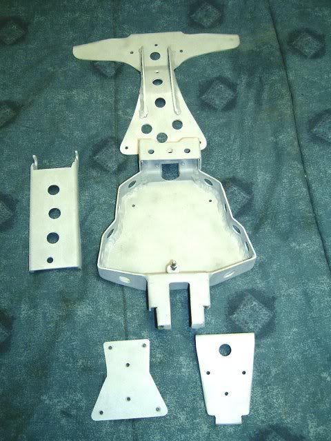

HI!... Well tonight I decided to lighten it up a bit. Surprisingly the "SPEED" hole lightened it by almost a pound! Then I sandblasted it to make it look pretty! LOL!

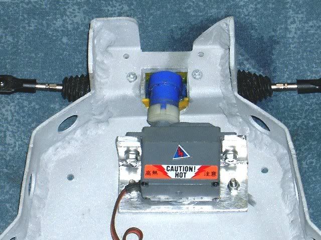

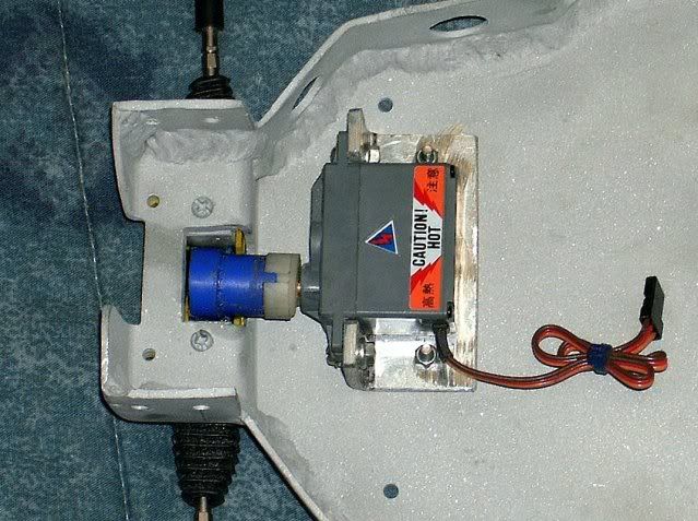

HI!... Well I got off work early today and decided to build my servo support. Got it all done. Here's a few pics :

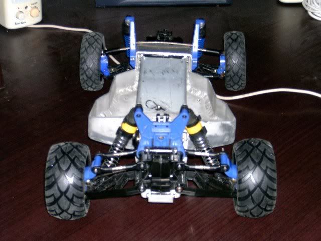

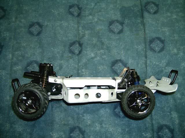

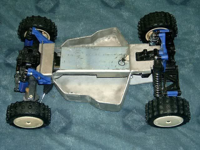

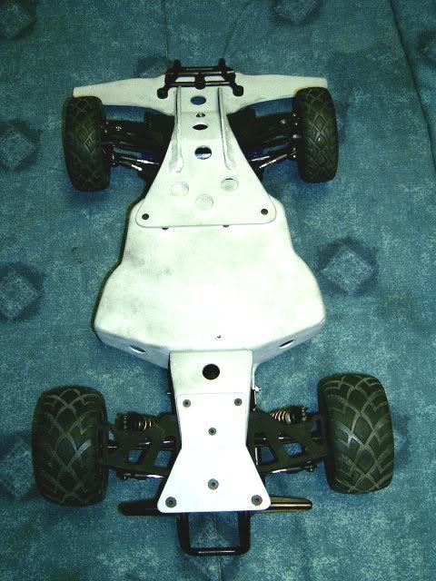

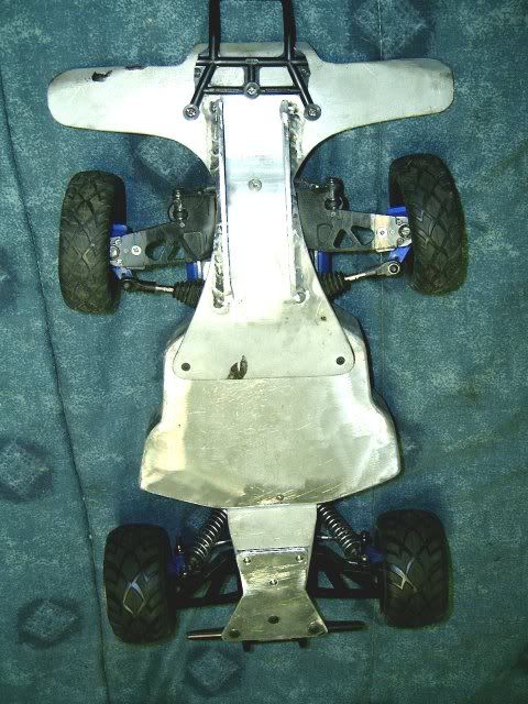

HI!... Well I got a lot of work done on the aluminum chassis "BIGWIG" today. I got it all put together, minus electronics. I'll work on that tomorrow. Plus I'm still waiting for my 20 tooth pinion to come in for my TEKIN brushless motor.
It's still in bare aluminum. I want to run it for a bit like this and see if anything needs to be modified before I send it out to be powder coated. The local powder coated said he could make it look like it was anodized but it would be powder coating. Thinking of a metallic dark Grey or a metallic anodized looking electric blue. What do you guys think?
Anyway, here's a few pics of what she looks like right now.

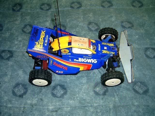

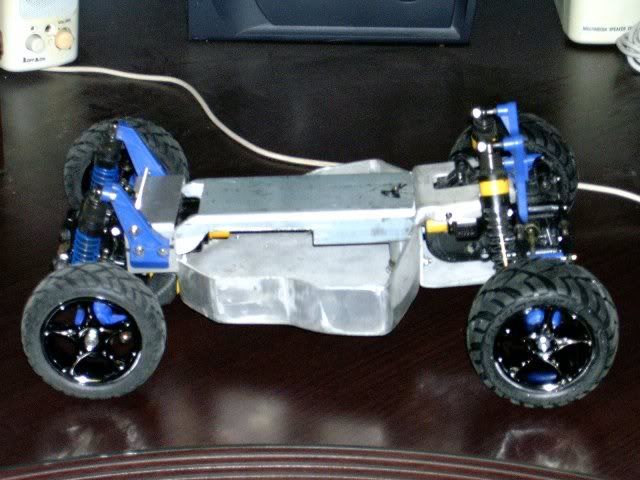

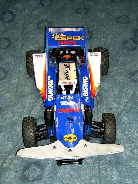

HI!... Well I took the aluminum chassis BIGWIG out for her virgin run last night. Everything went pretty good. She ran straight and true. Handled pretty good. The only thing I had to do was change the valving in the TRAXXAS front/rear shocks and go to a 60 weight oil. I also had to add a few shims to the springs. On hard deceleration the front bars under the front bumper would hit the asphalt and rub. Now they don't. She trapped 61KPH on the radar gun. Can't wait for my 11.1 li-po's to get here so I can try one in the BIGWIG.
Here's a few pics. The body is old. I've got a new one I still have to cut out and paint.
