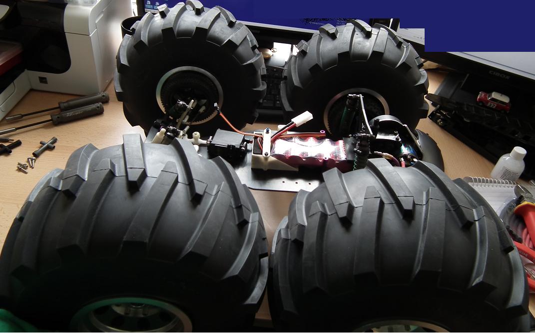

Well, must say for the amount of info and talent on here, I'm gob smacked no ones done or has pics of a "Monster" RC10.
Guess I'll be the first then!!!

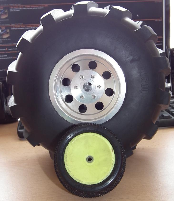

Got a huge set of wheels and tyres, that take a 14mm hex, so the rears should be easy.
Fronts, I'll have to think about, first option comes to mind is using 2WD Traxxas monster parts, we'll see.
Think I may need a longer chassis!!!!!
Well enjoy the shot next to a B2 2.2 wheel with Minipins.....

Hate to say it, but those tires are too big for the chassis and suspension. They look like quarter scale?
I would think something like a custom crawler chassis using link suspension would be better suited. By the time you modify what you have to fit those tires and build it strong enough to last, there won't be much left of what you started with.
