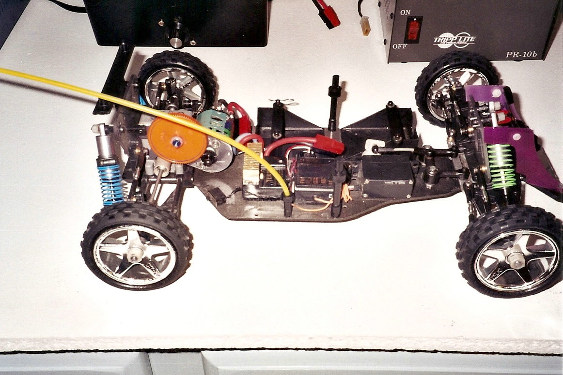

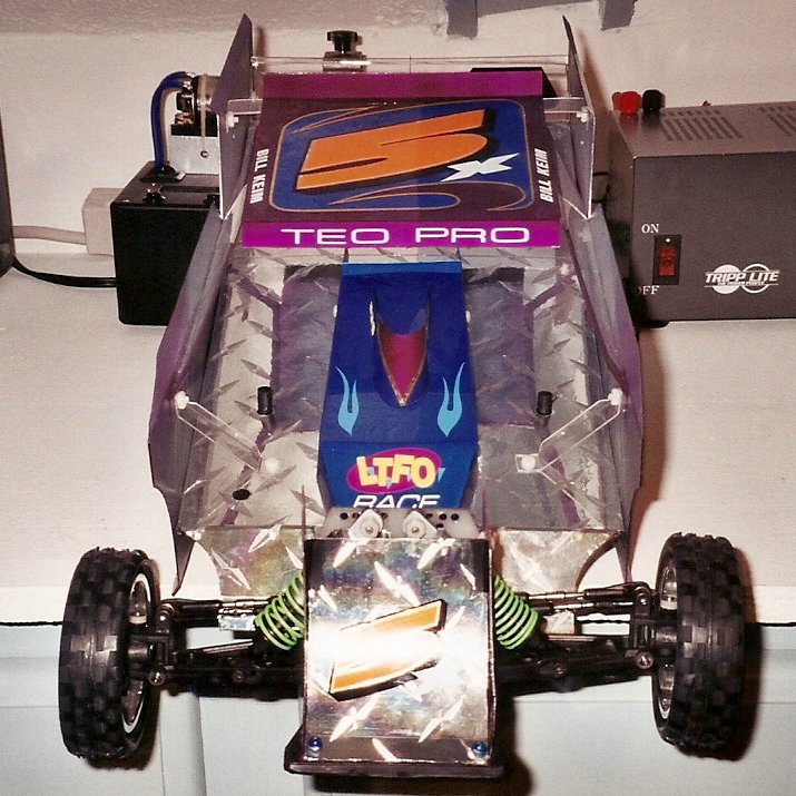

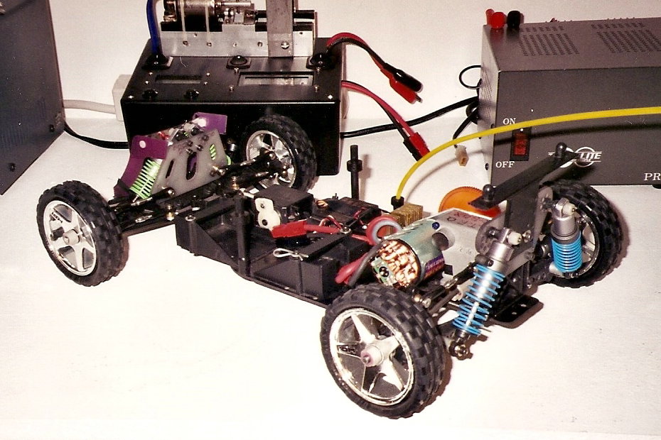

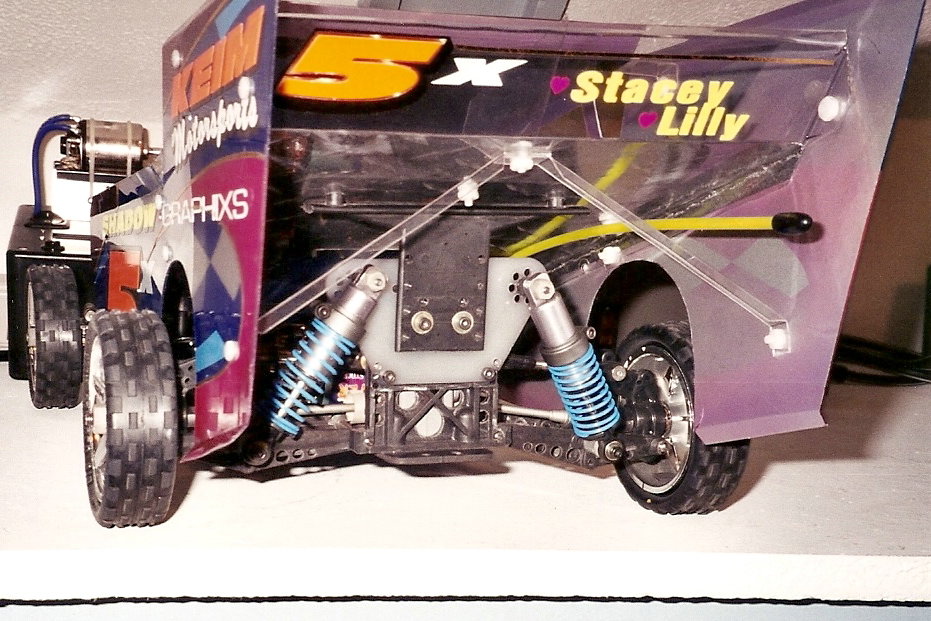

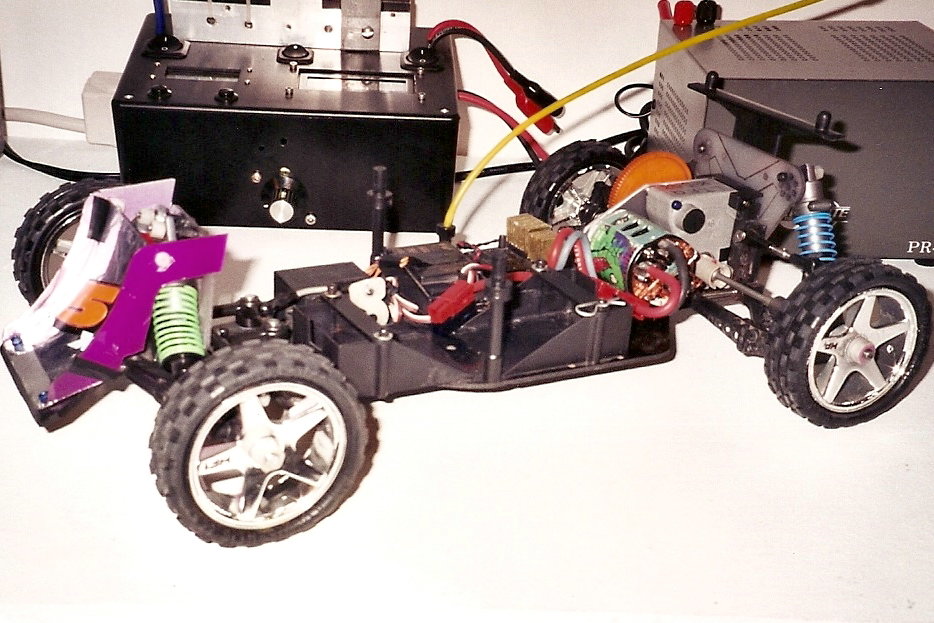

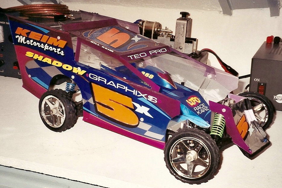

here is my losi jrx mid motor conversion. this car was raced competitively until last year when i finally built a terminator car. it started out as a car that was given to me and after no mid motor chassis could not be found i made my own. the stagger ribs on the rear are no mistake, that is the only tire that works on our polished concrete track. as with the truck pics i dont have the most recent photos. but not much has changed except for dynotech custom works front arms and a new nosewing, enjoy

Takes me back to my old oval days. I had a Jrx2 with a Bolink lowering kit. We had stock car bodies though. Incredible that an old Losi can stay competitive for 17 years. That paint job is slick too!

thanks that was the first edm body i made. the purple, blue, silver, and pink are paint the rest is vinyl.the car is built with all losi parts except for the associated battery cups, it even has factory works plastic outdrives.the hardest thing was trying to get the rear toe to zero after the bulkhead and tranny were reversed,since now the rear arm mount was now in the front and gave me reverse toe. so what i did was take an old bulkhead and cut off the buttom part where the arms mount so it looked like the stock rear arm mount. then i stuck 2 washers under it for anti squat and wala instant zero degree mid mounts. too bad i had to sacrafice a bulkhead to do it. all of the stock losi rear end parts have been drilled out look closley and you can see. since they weigh more than associated parts this thing is still heavy in the rear but not like it was.
