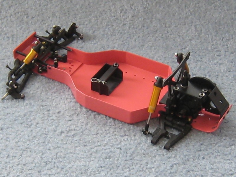

i painted this tub and nose plate sometime last year, around the same time that i did mrlexan's "pepto tuber". hence the PB (pepto bismol) 10. :wink:
it's been hanging hanging in my basement, with no real plans to do anything with it. well, late last year i got a graphite team car from a member here. the chassis was pretty much shot, but the stealth was decent, along with some of the chassis components (bulkhead, mip bellcrank, hinge pins, ball studs). so along with some pieces off that car, and new parts that i had laying in parts drawers and ziploc bags, here it is so far. it's been sitting like this for a little while now. i need to pick up a couple things for it at some point in time.....

Looks like a superb project base... still, the match between the shock bodies and the chassis/nose is a bit, er, puzzling, let's say ;)
Any chance you could de-anno the bodies and match their color with the chassis? now THAT would be killer!!!

those shocks are just on there so i knew that i had a set for it. they're gonna get stripped, then i'll rub over them with a red scotch brite pad to give them a brushed/satin finish.

Ugh, I hate Pepto Bismol! Looks good on the car though :wink:
What kind of front shock tower do you have on there?

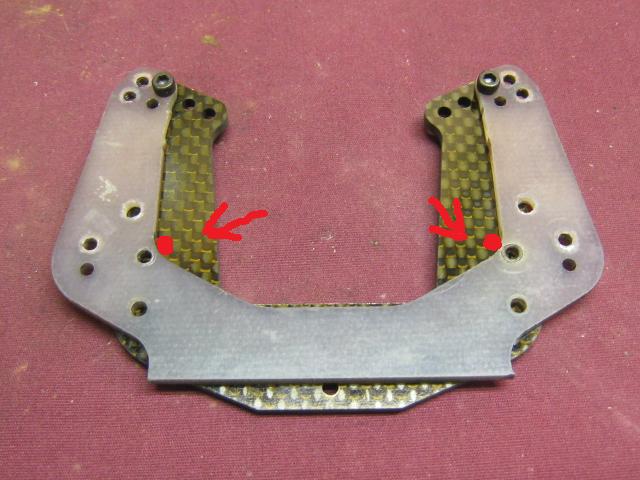

looks kind like a B2 tower special modified.

SofaKing wrote:What kind of front shock tower do you have on there?
jwscab wrote:looks kind like a B2 tower special modified.
pretty much. it's a modified FT cf b3 tower. it'll be coming off in favor of a ae worlds tower when i find one.

I'd love to know how you got the holes in the tower in just the right place for the nose tubes. I had that idea a while back, but after measuring and eyeballing and measuring again... I ended up just butchering a tower. :(

here's a little write-up i did a few years back when i altered the tower:
http://www.rc10talk.com/viewtopic.php?f=1&t=3369
now using the same process, you know where the nose brace tubes are going to pass by the original tower. so i simply bolted them back together, marked the b3 tower, drilled a 3/16" hole, and opened it as needed with a file/dremel.

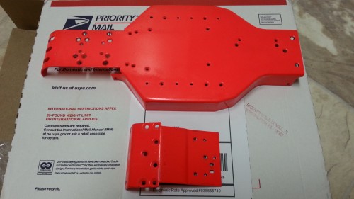

So, I picked up this super nice used factory flourescent red chassis set from noony (thanks again ron).
I've never really been happy with the pink chassis I painted. I spent no time doing any kinds of repairs to remove gouges or scratches because I thought I was gonna use it. Never happened. So, unless I find some replica I could do using this chassis, the pink tub is getting swapped out in favor of this.

wow, now were talking 8)

Much better! Now you have to start a new thread or re-name this one to Tomato-10. :mrgreen:

Awesome chassis in neon red!
This car will look awesome with white nylon :mrgreen:
