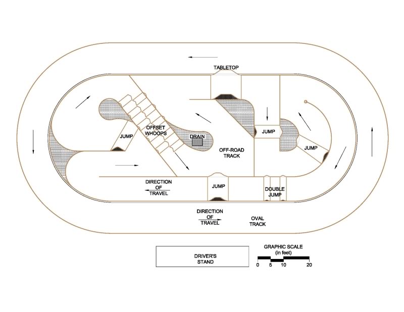

I am prepping a Losi JRX Pro with the XX Retrofit trans for a vintage class at my local track. We are allowed to run period correct tires with a tamiya 540 silver can. So with my 2.19:1 trans & stock Losi tires on the yellow dish wheels, what can I expect to gear this thing at for a track that has a half tight technical portion & a sweeper with a decently long straight leading back to turn 1. Track diagram attached. Oh yeah, 6 cell NIMH batteries only, I got a Pro-Tek 4200 pack enroute.
