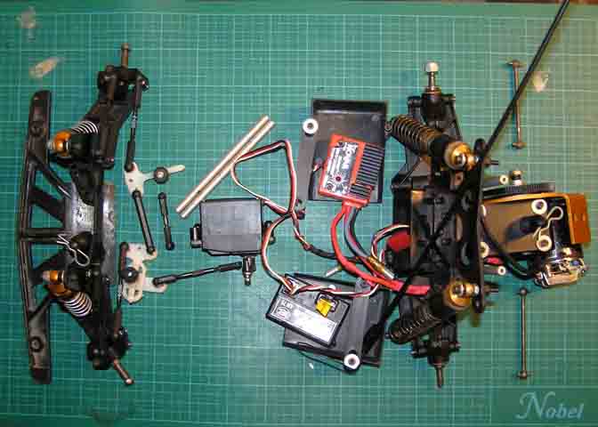

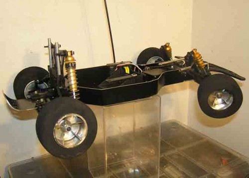

My 2nd build, nothing really set in stone. The direction of the project will be determined when the chassis I bought shows up.
Team Buggy? Worlds Buggy? In any event, here's where I'm at:. :mrgreen:

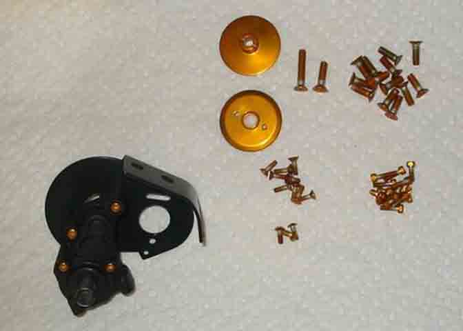

I haven't received the chassis yet, but I think it's a team car from the photos.
I bought lots of other cool stuff for this car so I'm really stoked...
-nice gold anno hardware
-Stealth transmission with full ball bearings & black motor plate

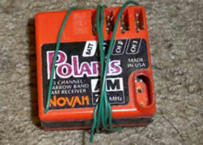

-Novak AM 75 Receiver (Polaris model)
I still need...
-viper body
-1 piece white wheels/tires
-Motor
Possibly a better Novak ESC
I should have most of the items later in the week 8)
-Kevin

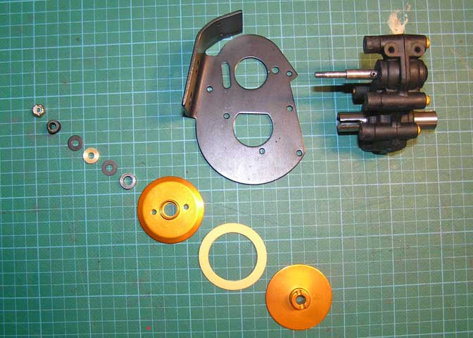

Photos...
-Kevin

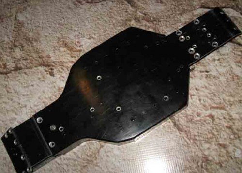

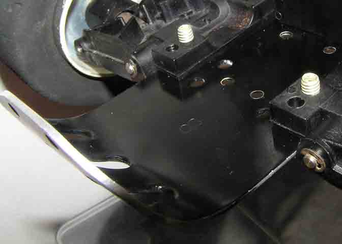

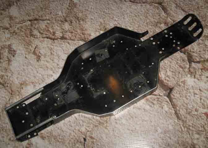

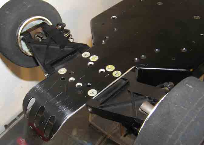

I have the chassis in my hands now, it's a B stamp. I cleaned it up and it looks pretty good - minimal scratches etc. Can anyone tell what ballpark year it was manufactured? I'm just trying to find out if it's a T chassis knock-off or an actual "team car" chassis? Nose and chassis does seem to sport the original black anno. Please heeeelp!
-Kevin

More photos in hopes to solicit a response :wink:
-Kevin

Pretty sure the 10T chassis were all c-stamps.

If all the T's were c-stamped, this might be an actual team car. The team car came out 1990ish just BEFORE the T's came out so that would make logical sense. I figured it was just a T chassis with a buggy front piece :lol: and in that thinking I could use all the extra dyed parts since it wasn't original to begin with. However, if it IS a team car it kind of changes my build plans as I would rather restore it to what it was and should be.
Any thoughts/suggestions?

Posts: 16816
Re: "Back-IN-Black" RC10 #2
everything that had a stealth trans was a B stamp, as well as the real late 6 gear c.e. C stamps started with the worlds car.
Posts: 9284
Has thanked: 356 times
Been thanked: 470 times
teman wrote:Thanks for input guys!
6035 and 6036 Team cars were released in 1991, as was the 7001 RC10T- the early B stamps are identified by offset inline battery holes-

Thanks for the reply. I'm not sure what you mean about the holes, but I guess you're saying it's not a T chassis?
Well in any event, I think I'm going to build a team car with white parts. The shopping list will be a little longer, but I'm game :mrgreen: I'm going to get started tonight, the black parts will used in the near future for my sons "build a model" Cub Scout project. haha :twisted:
-Kevin
Posts: 16816
teman wrote:Thanks for the reply. I'm not sure what you mean about the holes, but I guess you're saying it's not a T chassis?
he's talking about how on A stamp and early B stamp tubs, the 2 holes for mounting the battery box were offset to the right. yours are inline, so it's not an early tub.
it doesn't matter if that tub started life as a truck, because it's the exact same one they used on the buggies.

OK, gotcha :D I'm glad I grabbed it, but unfortunately I see the rest of the team car being auctioned off - IE the alternating colors of mounts and hubs with RPM arms etc :roll:
I did manage to get most of the car swapped, popped in new bearings for the rear hubs, bought the Viper body, wing mounts/wire and a decent set of wheels/tires for it. More photos later in the week when I have it rolling.
Thanks for everyones help, much appreciated. :D

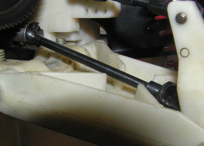

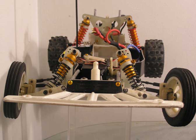

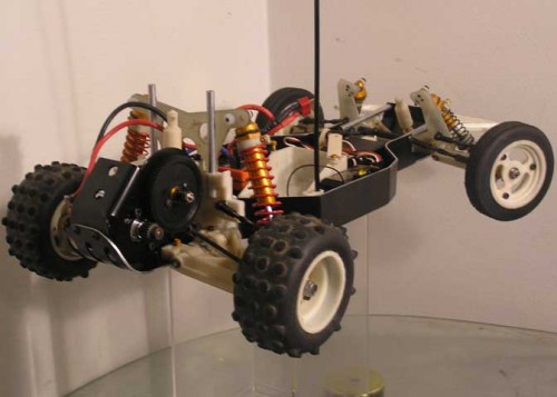

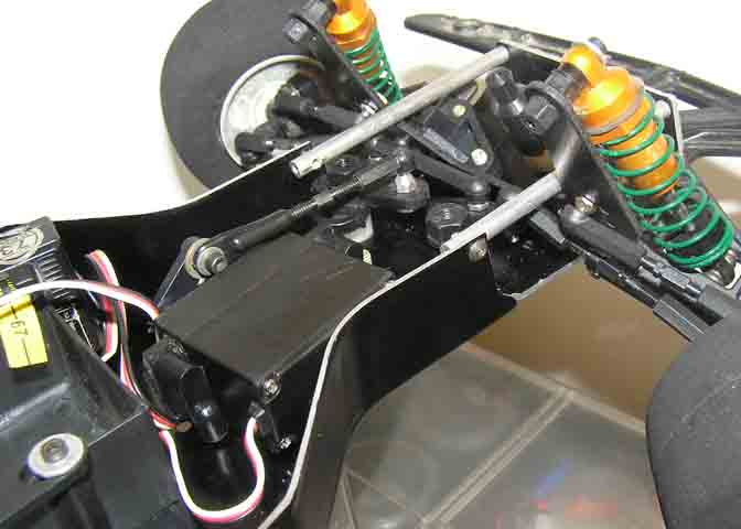

Well a lot was changed since I last posted, mainly due to not liking the black parts on the black chassis :roll: so the gold pan donated white parts to speed up the build of this car. The black parts went on the gold pan which will complement what I plan to do with that one soon (I'll update that thread today also).
I sourced the front shock tower and the missing transmission slipper parts, only a few missing items now - gear cover, the correct shocks, 1 piece wheels, universal CVDs and the wing that goes along with the viper body - If I overlooked something, please let me know. I put the Novak 410 in this car and the T4 in the gold pan. I'm still waiting on the Novak receiver. I think I'm making good progress, but there's still much to do. Photos :mrgreen:

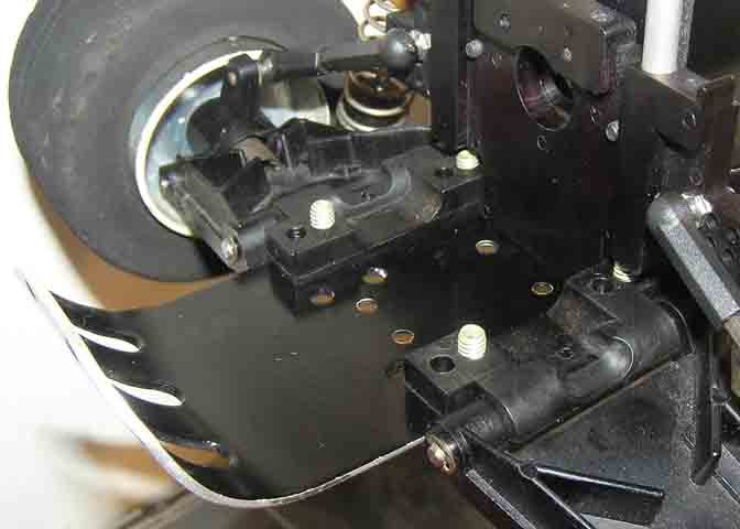

My NIP universals arrived so I'm quite pleased that I can cross that off the list. I'm doing my best holding off 1st run time untill I make another skidplate :D Still more to come I'm almost finished, well kind of lol :wink:
