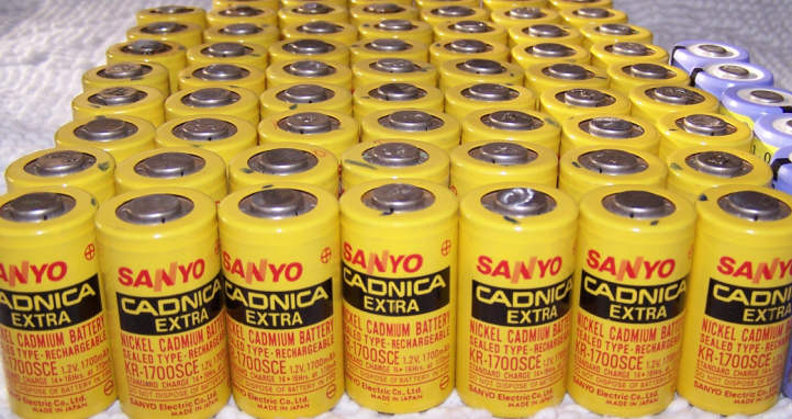

Finding vintage batteries for use in projects has been a tough go for me. I have been looking for years. They didn't seem to survive well. The 1200SC is the toughest to find, followed by the very temperamental 1700SCE (both from Sanyo). When I find them, I buy them.

1700SCE: Sanyo yellow label with black logo, came out in 1987 or so. Higher mAh capacity, but very expensive (like $10 a cell) and could only be used once a day.

A lot of those guys would either have pre-production cells (trinity was famous for this) or would remove the shrink wrap and re-shrink them so that no one knew what they were using/testing. When I was racing, I saw cells of all different colors, but they were all Sanyos of one form or another.
There was a while when Panasonic had a plain lavender purple 1700 cell that a lot of modified drivers were using, but they were one of the worst cells of the 80s, IMO.
