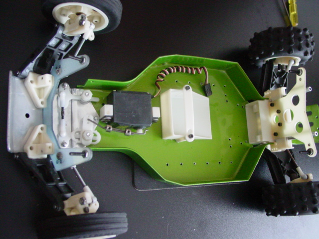

Had a quiet day at home , I was thinking about putting something together came up with this. Old gold pan chassis I had sandblasted and painted a while ago, also polished the noise plate. Then i had a mixture old black and white parts that I fitted to the car, it's a start. Also started a jrx project .

ooo, I like that green. Is it metallic?

It's not metallic, its a green base coat with three light coats of yellowish pearl then clear coat.

So if I understand the glossy finish came with the pearl coating? I was thinking about sanblasting a chassis but I thought it would leave the metal kinda rough. Did you sand it or something before painting?

The glossy coating came with the clear coat, if you sandblast it , then a quick scuff with the 3m abrasive pad then your ready for epoxy or a etch primer ,before paint of course.
if your going to leave it sandblasted you might be better off using oven cleaner to remove the gold coating, because then you won't have a pitted look to the alum.

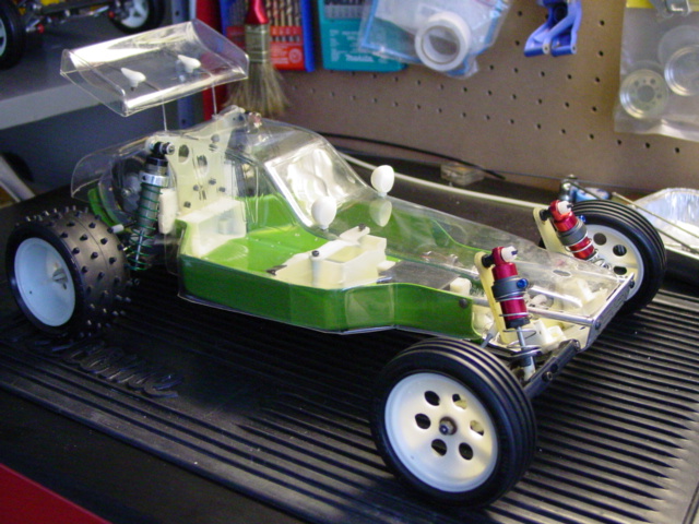

been working on the buggy got the body on it now , i guess its coming along.also got some proline wheels on it now. take a look.

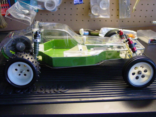

side view

That's cool, Nice job

I like it, nice scratch build mate 8) . I dig those Pro-line rims and have still not managed to find a pair of rear ones :shock:

cool looking rig sk7, love the colour. what's with the noseplate? is it white pearlescant? i cant quite tell.

sk7 wrote:also polished the noise plate
:wink:

and what a noisy front plate you got there :lol:

sorry, what was that? i can't hear you with all this noise :wink:
i know he said he polished the nose plate but it looks all glossy.

the nose plate and motor mount are just polished a little,thats it.

That is a great looking rig - what tranny do you have in it?
