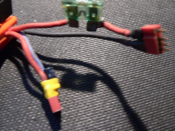

Hey guys, what can you tell me about this one from Novak?
In the pictures, look for a short bit of wire that is located at the receiver and switch output area. There are two wires, both red, soldered together. :shock:
I don't think that part was a stock feature. :lol:
Also there is a capacitor or resistor where the yellow shrink wrap is, no idea why. I have not had the chance to look up the value on it yet.
What style/brand of battery connections are those? I remember seeing them years ago, I am not new to this, but I am stumped.
Thanks for the input.

Thats great, I read the other posts on the Novak 4, But that explains it all.
Now to clean it up and redo most of the soldering. I was able to pick up a JRx2 from a buddy over on Clodtalk many months ago. I am just getting to it now.
Going to try and clean the whole buggy up, replace the body and wing, some new tires and wheels.
Thanks again RC10resto.

I love the Deans 4 pin connectors, they were nice and small.

I had wondered if they were Deans,I honestly had no idea though. The only thing that made me think that was the red shape and the thin indent on one end.
I missed many things over the years that I was not as into the R/C addiction. I have nothing that looks like that connection in my collection amassed over the years.
Not really sure what to do with them, But I do want to use the ESC in the rebuild of the buggy. New ends I guess.

Why not use the Dean's plugs?
The red ones are a little bit "new" for a Novak 4 but I would stick with them.

The Deans 4 pin would be correct to use on the JRX2. The short red wires soldered together are for 4 cell use. If you use a 6 cell, they should not touch each other! :wink:

That means I had better unsolder them if I plan on using any 7.2V or my lipo batteries with it then.
Thanks Rod, I also read the instructions that RC10resto posted the link for. Amazing how much you miss in a short time.

Aha! I have a bag of those plugs, something like 20 different ones plus one unopened package. There are black plugs and red plugs. They both have 4 pins each but the red plugs have the fourth plug a bit offset from the other three which you can see in the pics above. The black ones are spaced evenly. Any ideas about the differences? They're small and dainty, I decided to use them on my RC18 build .8)

The black one's came before the red ones - Deans plugs

Molex is essentially what Associated had. The Tamiya is proprietary to them. The red Deans 4 pins had great polarity protection, were easy to wire, and didnt take up any room. I still like them better than the Ultras.
