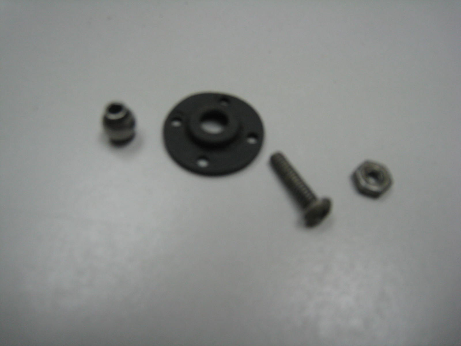

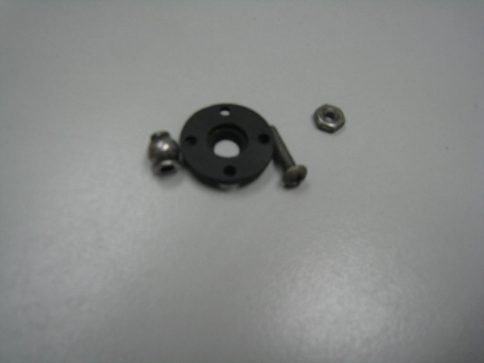

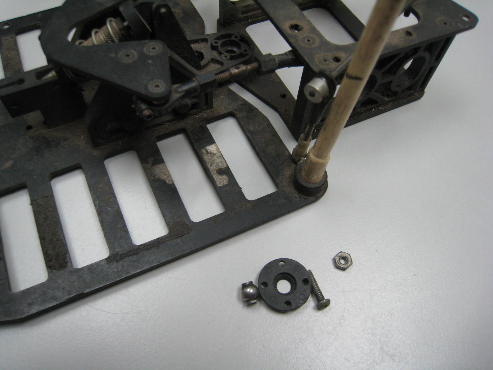

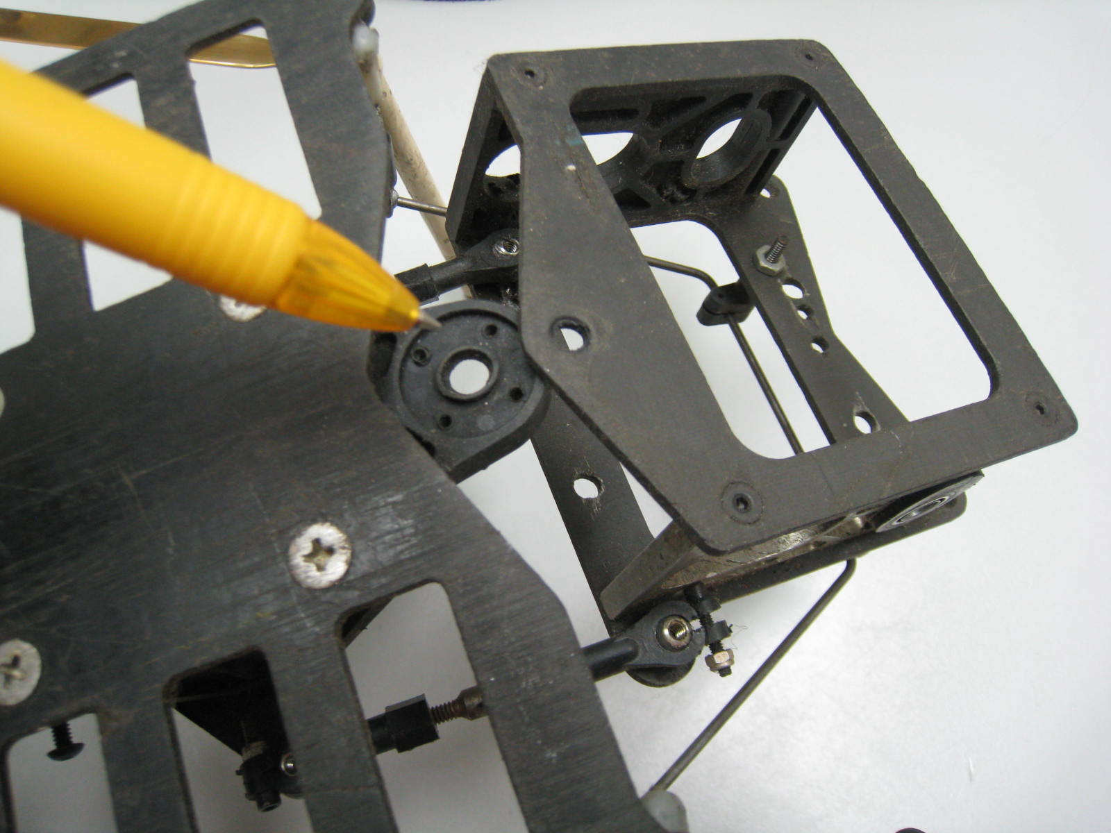

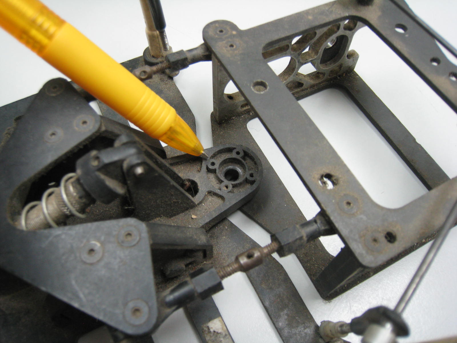

Hi, I got a used TRC Lyxn , but the rear end pviot ball is pull out by the seller. It seems something is missing. Can anyone show me how this pviot ball be put back togther ? Tks for help !

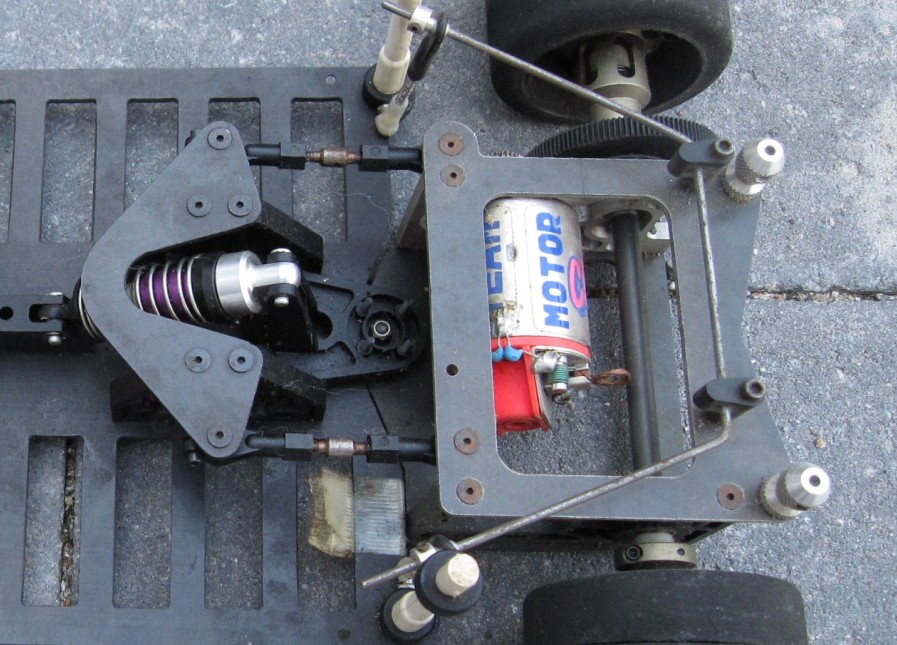

Chris, there is nothing missing I think. I have a picture from my Lynx where you can see the rear pivot from the top. Just the screws are protruding from the plastic.
You have to insert the pivot ball from the lower side and mount the plastic cover also from the lower side so the rear suspension can move afterwards. If you mount the cover the wrong way the suspension can´t move. That´s it.
jwscab
Posts: 6580
Location: Chalfont, PA
Been thanked: 505 times
Re: TRC Lynx Help !
Post by jwscab »
yes, it looks like the only thing missing is 4 screws to attach the ball retainer ring.
