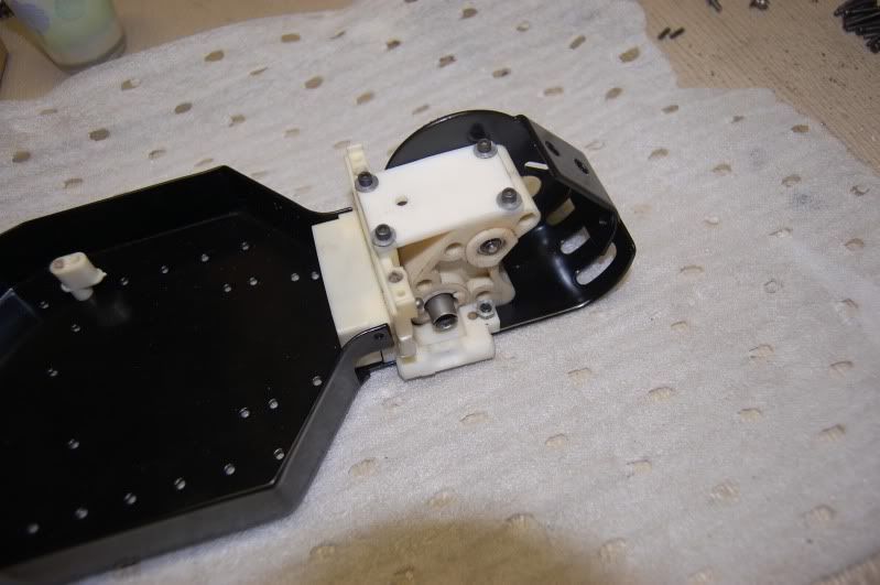

If you can see the bottom of the chassis...here is what a 6 gear chassis looks like (no holes for stealth tranny), and normally ALL A stamp 6 gear only chassis are gold. I had this one powdercoated black:
Here is a 6 gear transmission:

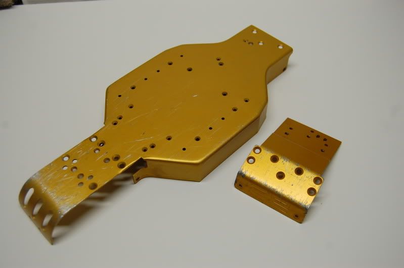

Here is a B stamp (gold) chassis, you can see the extra set of holes for the smaller stealth tranny:
Here is a stealth transmission:

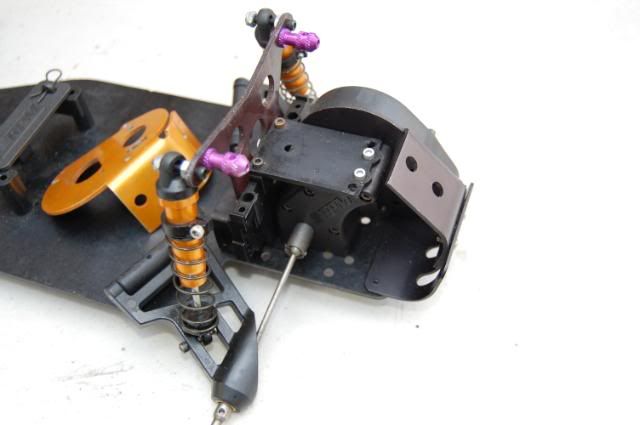

another way to tell, if you can see the tranny brace across the top (say the car you are looking at has no bottom pictures), the stealth bolts are narrow & 6 gear bolts are wide:
Here is an RPM conversion tranny for the Stealth, a little different looking than the 2 above:
