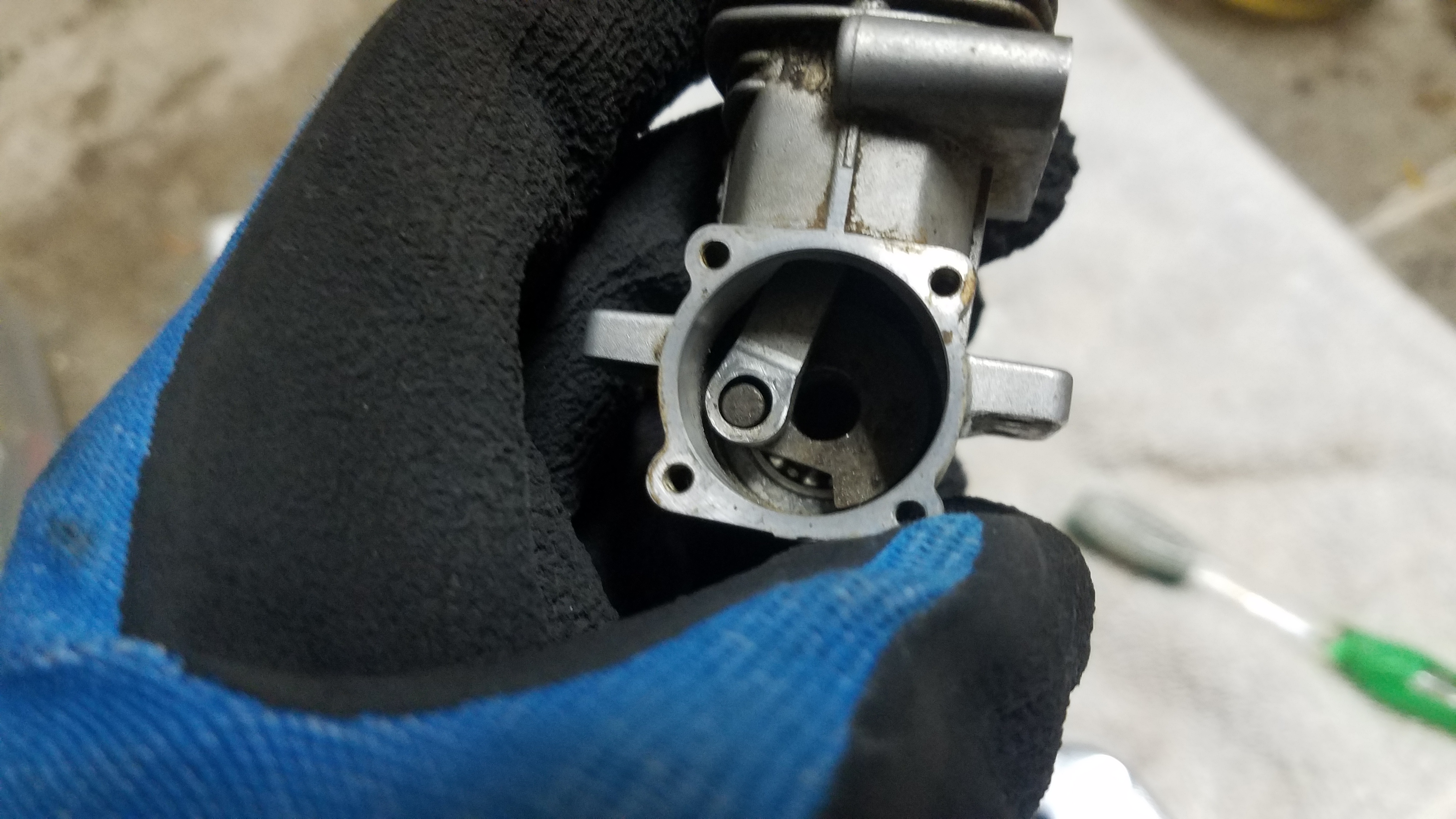

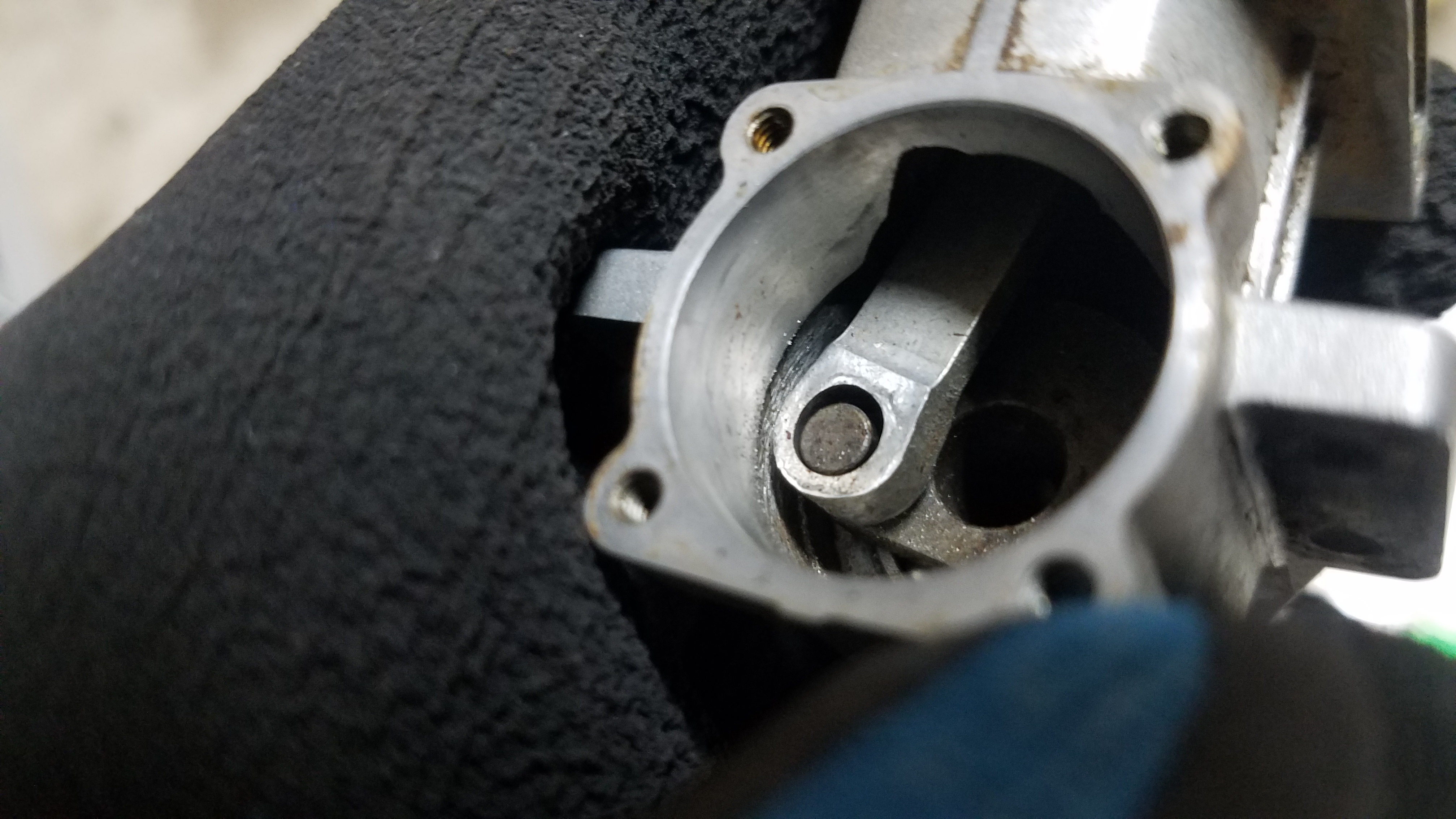

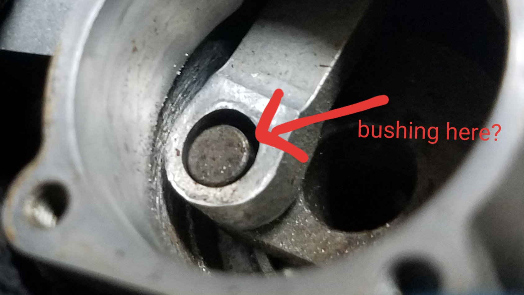

So I freed up my stuck nitro engine. (OS Max CZ .12 i think) Noticed that the piston rod was very loose on the crankshaft and has A LOT of play. The bottom of the piston rod also hits the inside of the block. Should there be a bushing where there is currently just a big gap?

Yeah, that's not good, the bushing is gone. What do the bearings feel like and what does the combustion chamber in the cylinder head look like? Also is there any scoring on the piston/liner?
A new rod should be easy to find, but it depends on the condition of the rest of the motor.

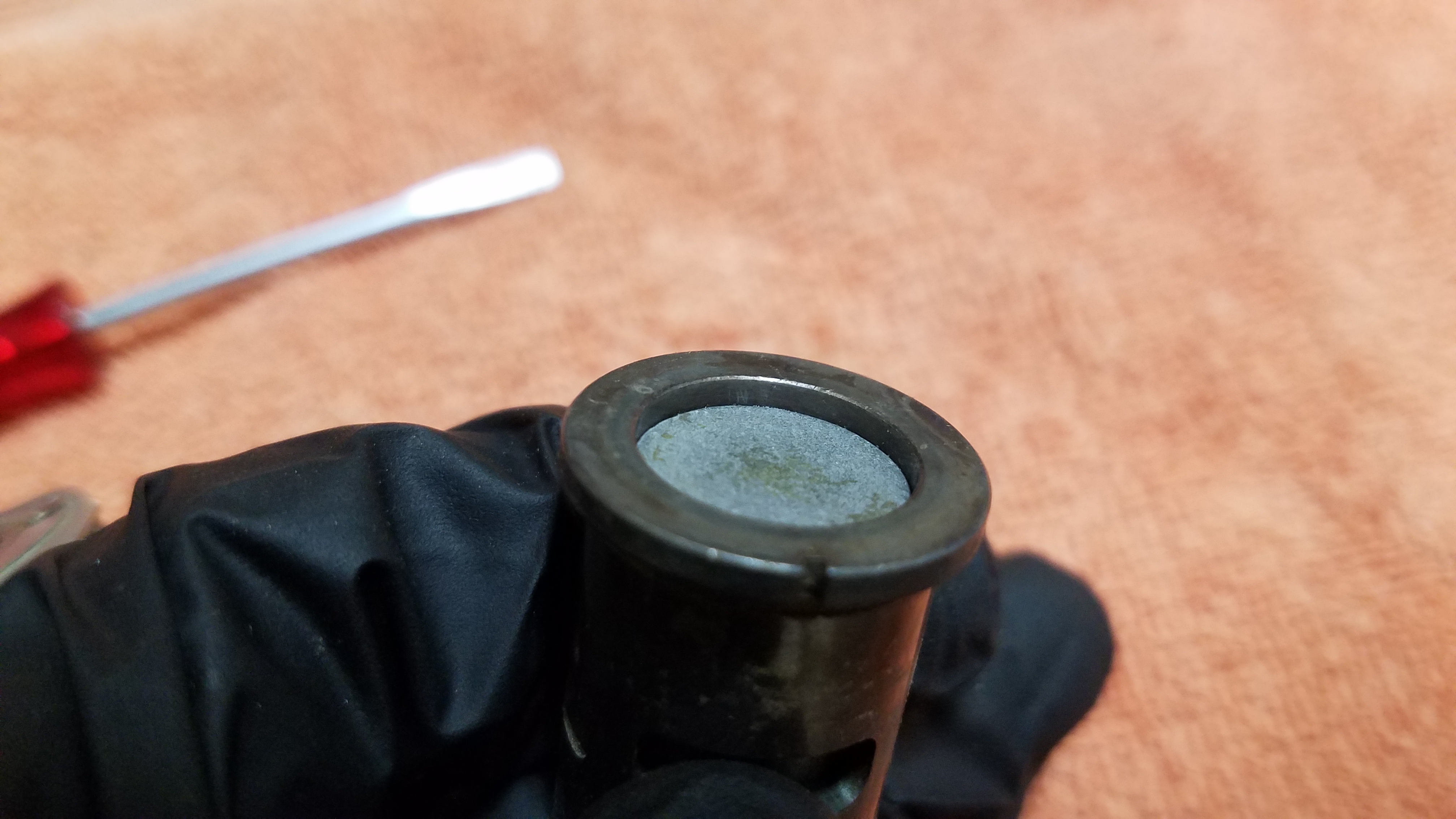

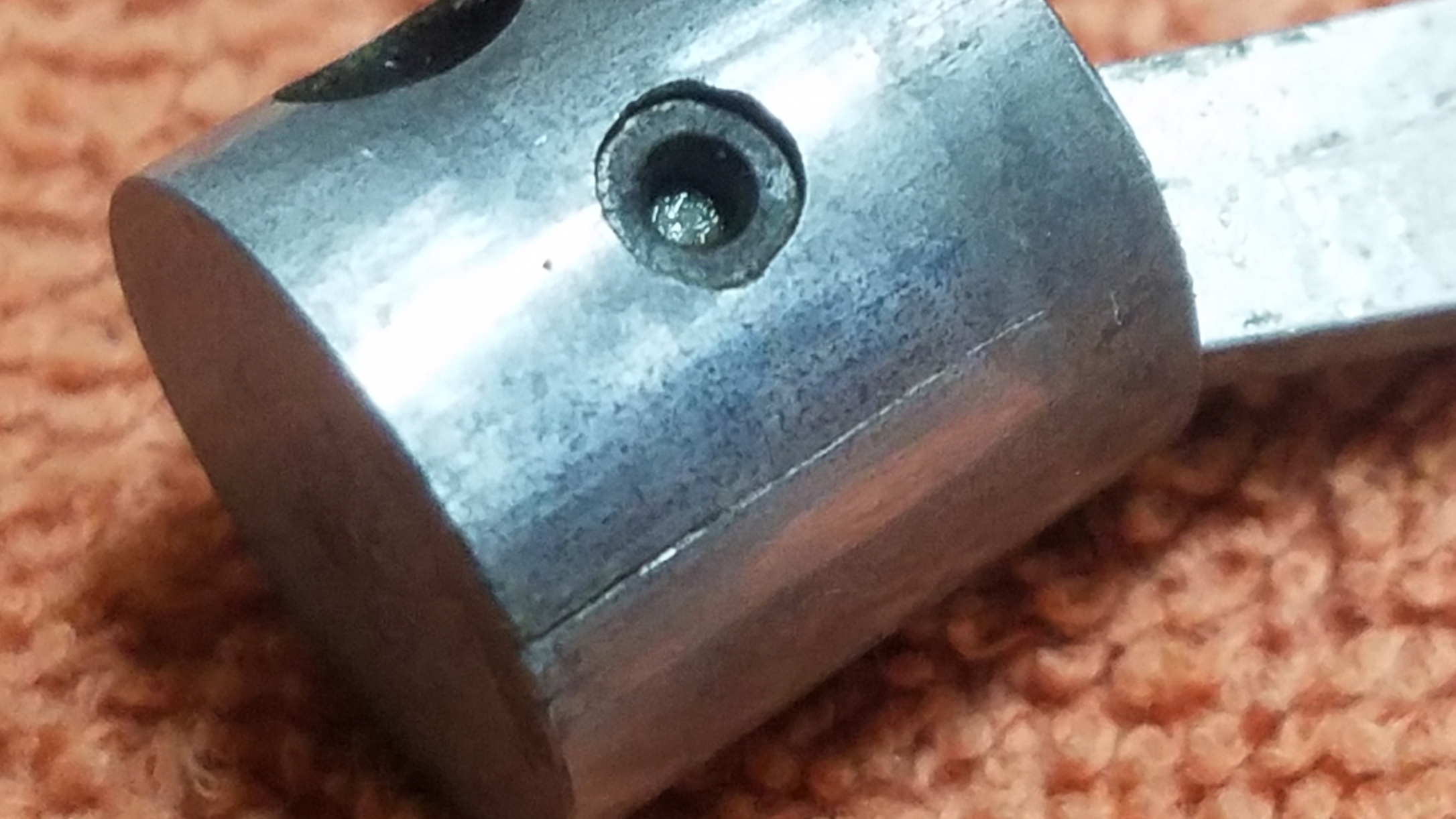

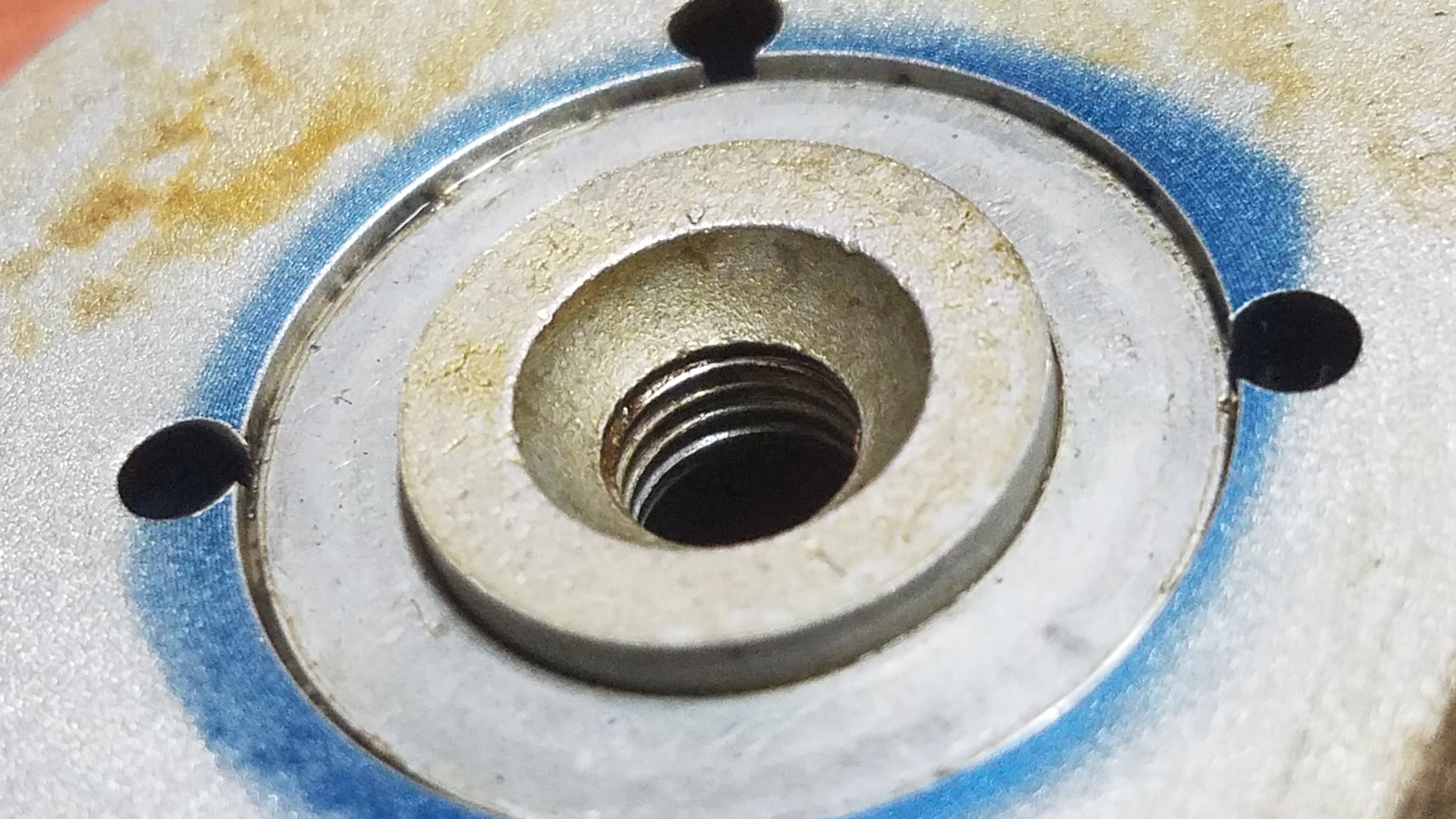

So this isnt good, is it. Is there a way to refinish the head? Got the piston and liner out too. I cant see or feel any score marks in the liner. The piston, on the other hand, has this huge mark in it. I am assuming that is not great either?RC10th wrote: ↑Sun Jan 14, 2024 9:51 pm The cylinder head combustion chamber should be nice and smooth, if it's pitted or grainy then it's no good.

The head doesnt look great but is probably OK, but man that thing must have been hot if the anodizing is that discolored.
But no, that piston doesn't look good. In the correct orientation how far up the liner can you push the piston?
You may be missing the Teflon wrist pin caps too.
If you can't push it all the way to the top maybe replace the rod and see if it runs.

The piston does not come out of the top of the sleeve. Stops just before. It was almost certainly getting too hot. The cooling fins in the head were completely filled with mud when I got it, the person who previously owned it didnt take very good care of it and I wouldn't be surprised if the tune was way too lean. I'll probably get a new rod and send it. Might as well.RC10th wrote: ↑Mon Jan 15, 2024 1:47 am The head doesnt look great but is probably OK, but man that thing must have been hot if the anodizing is that discolored.
