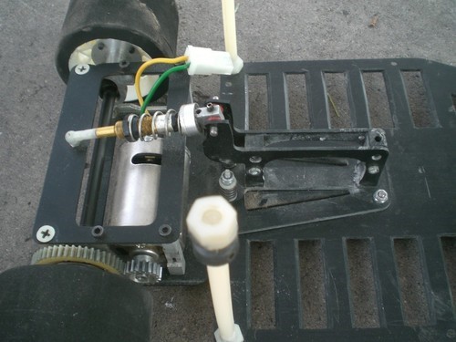

Hi, I know the TRC Pro 10 /12 had a "Springs Tweak" system , in addition to the original 3 O-rings tweak system. Anybody can share a close-up photo of this "Springs Tweak System " ? Tks for help !

The TRC Pro12 didn´t use this but the Pro10 car, also the Twister Cyclone.
Actually you just need longer screws at the outer o-rings then some larger OD springs like the C-Car or Corally frontsprings including springcups and the locknut above this.
