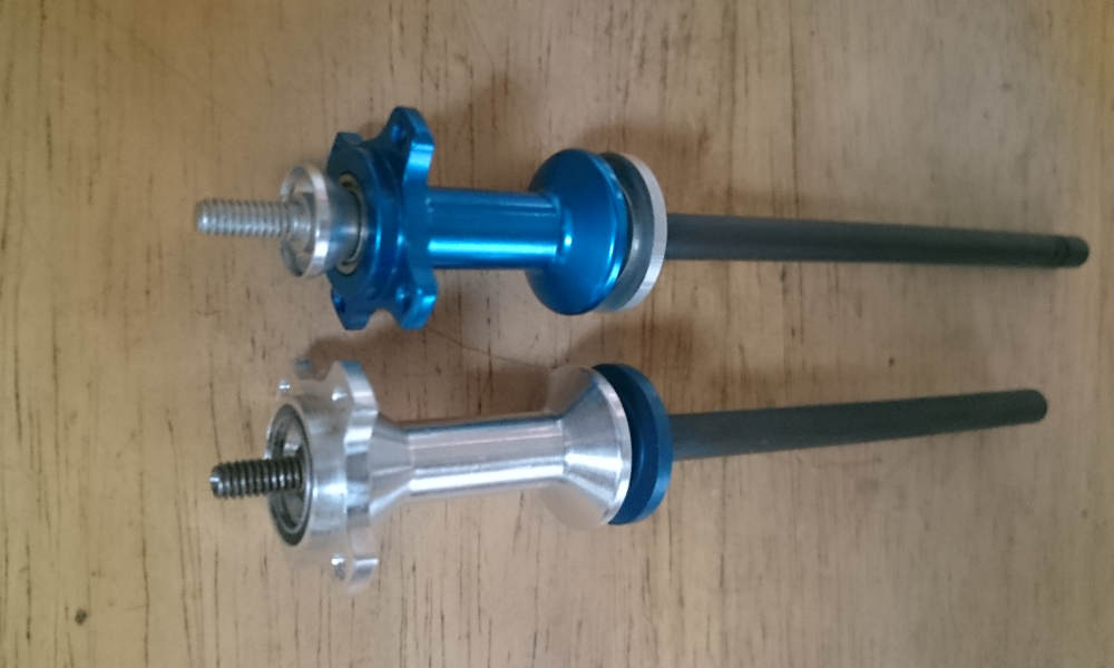

Re: RC10Lss Narrow TRC Pro Lite rear radials.
10LSS hub on a 10L axle and a 10L hub on a 10LSS axle:
The spacing between the bearings on a 10L and 10LSS diff hub are the same...but the end of the hub that the wheel attaches to is moved. On a wide 10L hub the wheel end is out past the outside bearing while on an 10LSS hub wheel end is just inside the outside bearing.
So if you use a 10L hub on the right side with 10Lss axel you only need to space out the left side to obtain 200 mm with the narrow pro lite wheels??
- Phin
- Posts: 2818
- Location: NY²
- Has thanked: 87 times
- Been thanked: 248 times
I'm suggesting you use the 10LSS hub on the 10L axle. The extra length gives you the room to add spacers behind the diff on the right side and behind the wheel hub on the left.
The 10L hub on the 10LSS axle might work without spacers behind the diff but I'm not sure you wouldn't end up wider than 200mm.
