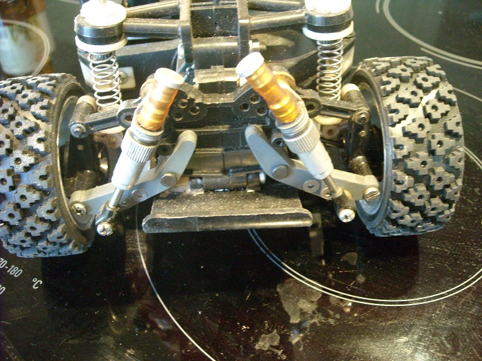

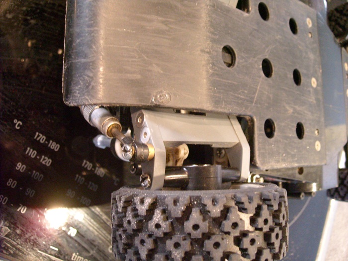

DennisM
Posts: 2405
Location: Denmark
Has thanked: 30 times
Been thanked: 62 times
Re: 959 cracking away??
Post by DennisM »
I had broken one of the rear arms on my runner and the other had a bad crack - so I searched ebay and found only one set and that was priced a bit over the edge for a runner. Ended up bying TBG rear arms (their first run) and the carbon they´ve used, was so thin that it was impossible to assemble it in an usefull condition. Binned the TBG arms and ended up using a day in the shed with axe, hacksaw and grey plastic. It´s not the prettiest but now I´ve got rear arms that holds.
The 959 is a mean rally machine with it´s Technigold motor. :D

tiger1
Posts: 783
Location: Singapore
Been thanked: 7 times
Post by tiger1 »
did you notice any crack on the pivot point over the gearbox side??
