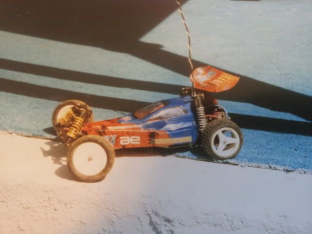

Thanks guys for all of your help. I figured I'd share a picture of my Cougar 2000 from 93 or 94 I'm guessing. I'm going to paint the repop body just like this..

Looks great! I can't wait to see this car get the treatment it deserves. Glad you got it.

I wish i still had a picture of my original race cars. It looks like a 95T body on it, is anyone repro'ing these yet?

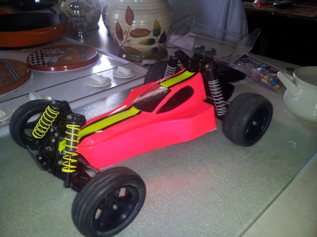

When I got this car I noticed that something in tranny wasnt right. Turns out that the diff gear is just spinning. What is the absolute easiest way to remove the telescoping driveshafts? I looked at the instuctions and during assembly I show that you have to use a vice to assemble it....but I have no clue how to take them apart so I can get it out of the transmission housing. I'd REALLY like to not break anything...
Here it is as if now...

You need a pinion key, and the hole in the outdrive is a screw unwind it and pull out the driveshaft.

Just an interesting point to keep in mind with regards to choosing a Lexan shell for this car. It would seem you have a genuine 2000 model and the shell of your old car is that of the 95TEAM car. I tried fitting the 95 shell and undertay to my 2000 and the chassis wouldn't allow fitment of the undertay.
You might want to check this for yourself. I had no idea till I tried it myself and it was a purchase which at that stage was too late.
