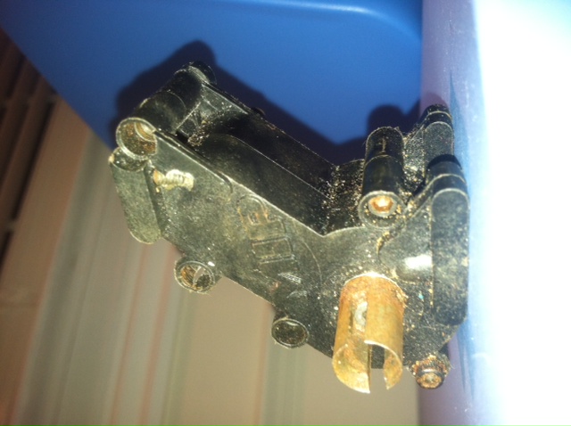

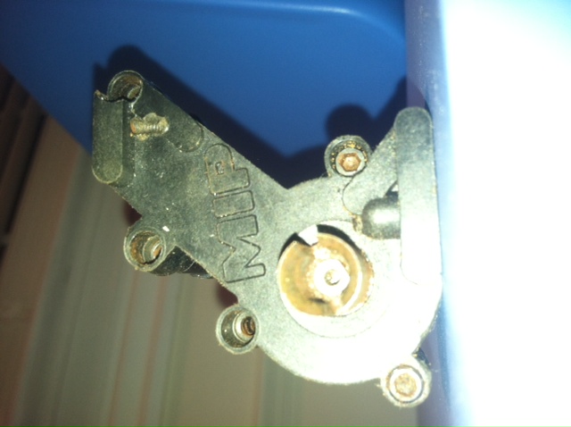

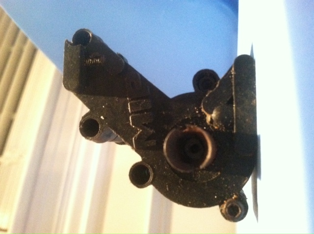

enough with the blah, blah (sorry :D ). what im trying to get to, i found my old MIP transmission i was looking for, to add to my build. only to say, "what the heck? i cant believe i did that". i must have driven a longer screw into it than needed and ripped through the side of the plastic :oops: . there goes the "nice" factor for that :x . wel, im not one to be embarrassed. are you? is there anything you found and said the same thing? probably something you'd never do being older and wiser? :lol:

BTW, if anybody has any idea on a fix, other than find a case, id really appreciate any help.
THUNDERSTRIKE1
Posts: 2022
Location: Cape Carteret.NC
Re: "I can't believe I did that"
Post by THUNDERSTRIKE1 »
Soldering iron an some of the same style plastic like that.Gently melt some plastic to the spot enuff to sand down smooth and flush.
Or file some plastic shaving off black plastic and then mix with ca.and apply to that spot smooth it let dry.
MOST all of them have that threaded look lol DON

Maybe this trans had a Tork-thrust top gear slipper and the hole on this side of the trans is there to adjust the slipper. I can't tell from the picture if this is what happened but here is thelink to the instruction sheet in the Scans section, you can see what it looks like and judge for yourself. http://www.rc10talk.com/viewtopic.php?f=82&t=20422

a01butal wrote:Maybe this trans had a Tork-thrust top gear slipper and the hole on this side of the trans is there to adjust the slipper. I can't tell from the picture if this is what happened but here is thelink to the instruction sheet in the Scans section, you can see what it looks like and judge for yourself. http://www.rc10talk.com/viewtopic.php?f=82&t=20422
this is great!!!! thanks for the reference :D

THUNDERSTRIKE1 wrote:Soldering iron an some of the same style plastic like that.Gently melt some plastic to the spot enuff to sand down smooth and flush.
Has there been ay tutorials on how to do this. I couldn't find any on rc10talk from a search?
