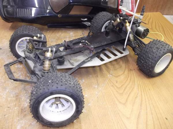

Time for a topic change: New project (as if I needed another one... :roll: ): Ultima ST on crack. See post five for what I'm starting with.

EvolutionRevolution
Posts: 1494
Location: Netherlands
Has thanked: 17 times
Been thanked: 34 times
Re: Ultima ST on crack
Post by EvolutionRevolution »
What I got.
- Scale Car Ultima converted to Ultima ST, with original Scale Car Porsche body (butchered).
- Gold shocks (front ones with shot o-rings, possibly no oil either, Tamiya hi-cap square springs).
- Ultima ST rear wheels x4 (rear tires shot, front wheels are rear wheels mounted up front with no bearings and original :roll: assembly)
- a lot of dirt and dust :lol:
- partial rear tranny without gear cover, intermediate gear pretty chewed up (is it supposed to be mounted to a screw?)
- no ball bearings whatsoever from what I can see.
- a steering servo (whether it works remains to be confirmed)
- apparently no broken parts except for a body mount that looks cracked and the trashed body.
What I'll keep:
- Chassis plates, rear bulkhead & hinge pin mount
- gold shocks
- body mounts
- body, will need to be fixed up
- Arms, possibly
What I want:
- A&L steering
- A&L Lethal Weapon tranny w/ slipper
- full ball bearings
- adjustable links
- frp or carbon shock towers
- Proper truck conversion (on the other hand...I have vintage Ultima buggy tires...)
