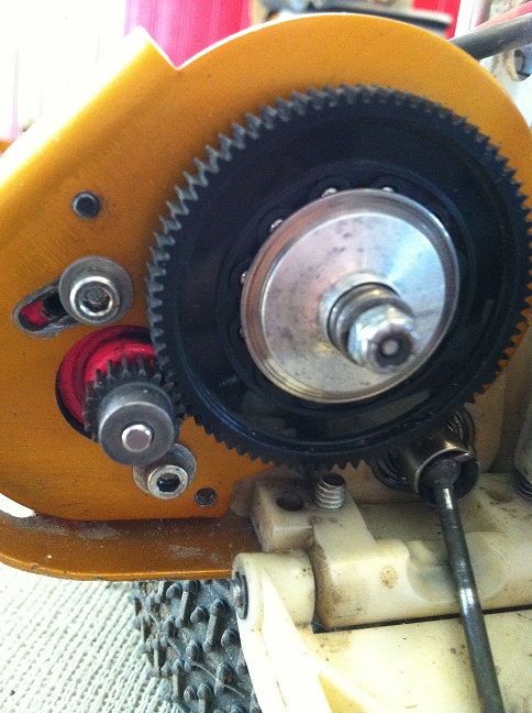

well its been awhile since i have bought any but the ones i have,mark in wi wrote:Thats a big help. I have 32 pitch but I want to switch to 48. Where/what gears are you using.... are they rc10 or something else??
Thanks again
Mark
are kimbrough (<---sp?) if i rememeber right. i always ran 81 so they are the only ones i can show pics of
if you have a real torque'eee motor step up your pinion
if its a high rpm motor step it down
one way other than heat and batt time to see if you are in the ball park! is on your track go down the straight at full race speed and listen to when your motor whinds out if about five to to feet from the end of the straight its topped out you are just about right
if its still trying to gain speed you are to tall in the gearing
if it topps out real quick coming onto the straight its to short
now this is just the way i do it and may not work for your track i ,i have been to tracks where the straight was only a small shoot between a set of doubles so you have to gear for torque for getting up to speed real quick
