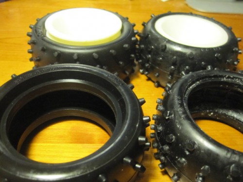

The attached photo shows a TQ-22 tire from an RC10 Champion edition (right side), which mounts correctly. On the left side is the TQ-21 (#6821H), on the same wheel - The tire bead is too narrow for the wheel, and doesn't come close to fitting. The second photo shows how the tire bead is wider on the TQ-22 tire.

Here is the tire on the wheel.

now grab that tire and pull it into place - don't be shy

Pull/stretch the tire to meet the outside lip of the wheel. The tire will be wider than the wheel which is normal
Posts: 16805
Re: Help - RC10 Graphite Wheels/Tires don't fit together
you don't have the bead seated in the rim. the tire is wider than the rim.

Ok, not having any luck using just my hands, and screw driver was putting quite a bit of stress on the tires. I searched my garage and found the perfect tool - I used a paint can opening to gently coax the bead into the right position and It WORKED!!!!!!!!!!!!
I really didn't think it would fit. Thanks very much for the advise and photos. One Mystery solved......
