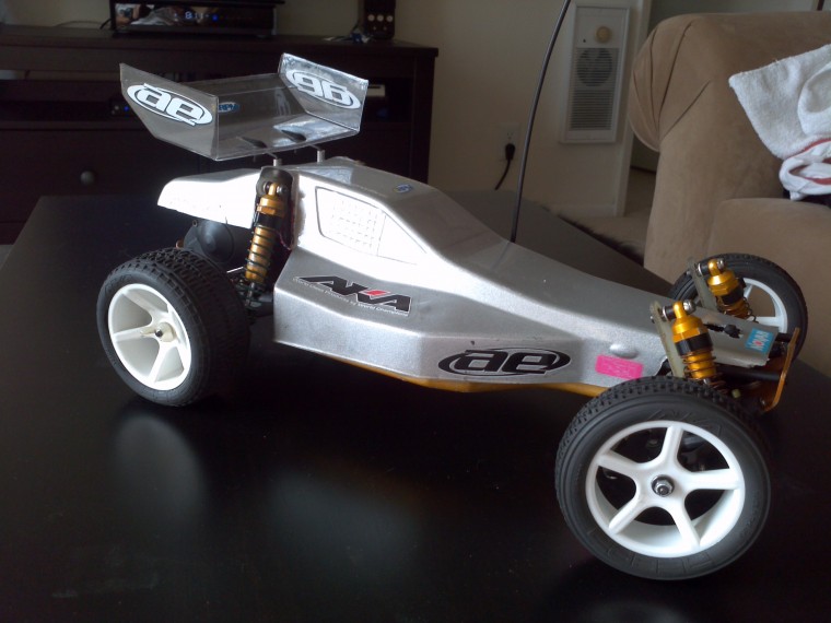

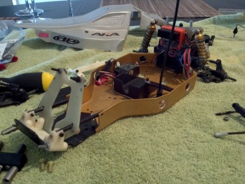

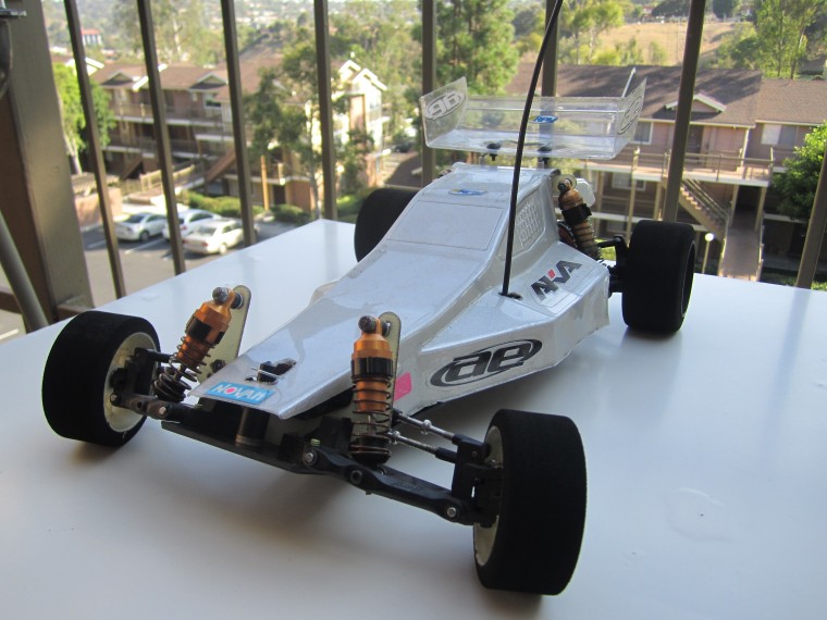

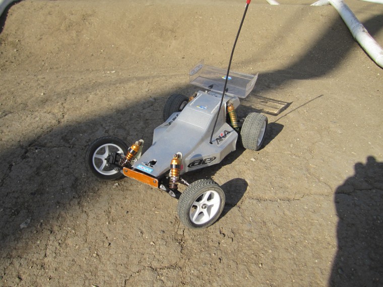

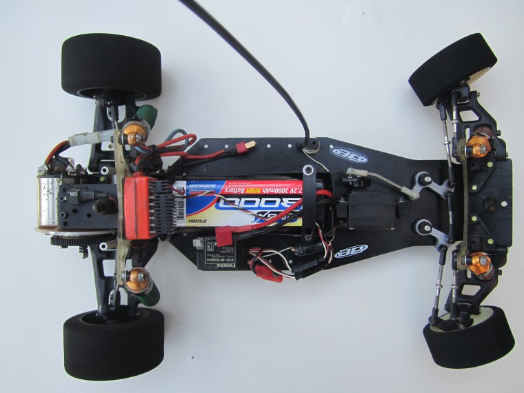

Hello to all my fellow rc10ers. I am currently working on a OIN build. I have parts on order. I have a question though.
1. Will using this http://rccarbonworks.com/store/index.php?route=product/product&product_id=108 give me the same total width as if I was using the usual Dynotech Klein rear arms, b44 cvds, RPM RC10GT hub carriers, B4 rear axle spacers, 3/16” axle shims and JConcepts Rulux B4 rear wheels rear set up? I will be using Andy's rear a-arms. Any help with this will be greatly appreciated.
Now on to pics of my A stamp RC10.
