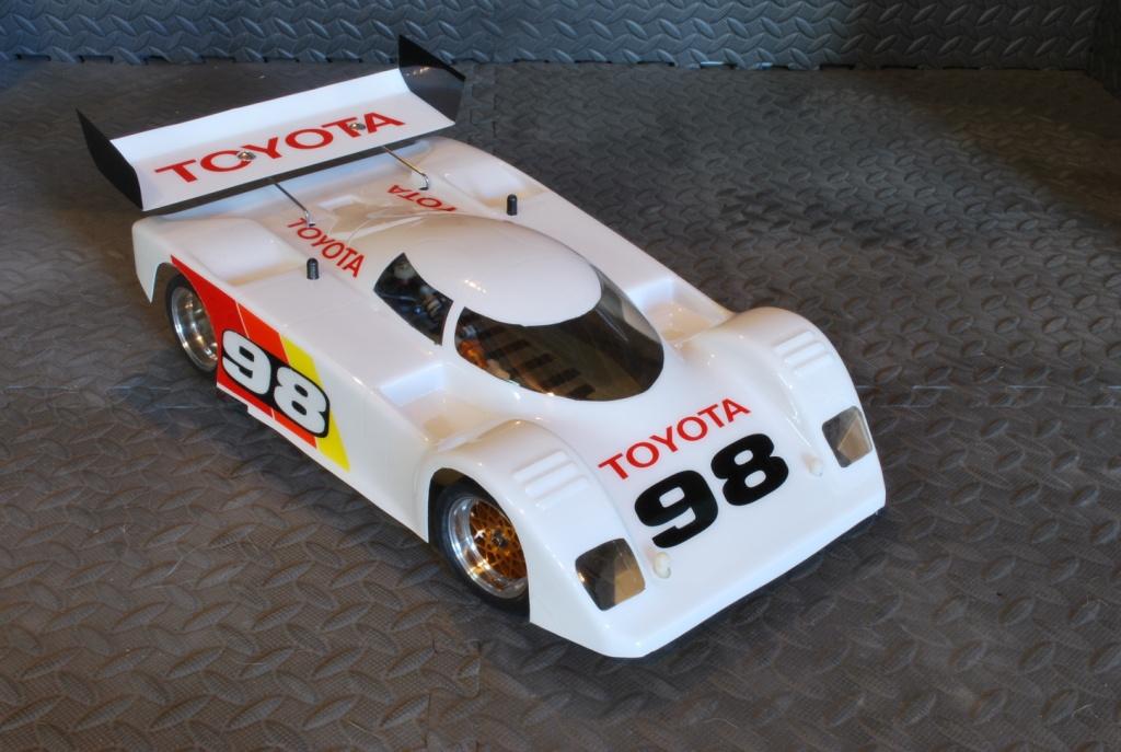

I've painted a 10L body with a Toyota GTP scheme for the member and being a Toyota guy myself, I decided to one of my own.
Here is a shot of the one I just painted....I must note, this is my first try with an airbrush. With some more experience I think I will be able to be decent at this, not amazing, but capable

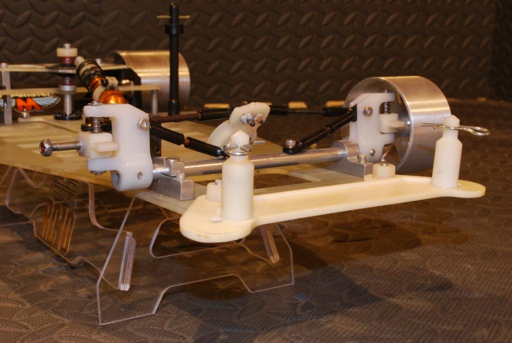

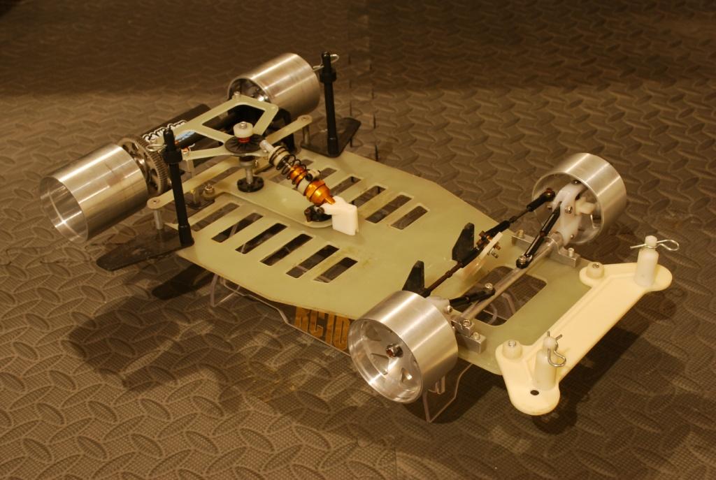

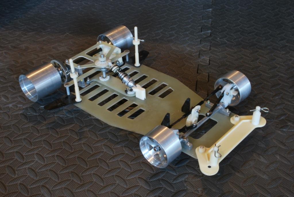

The 10L is a fibreglass chassis version with some added stuff, here are a few questions I have
I would like to know what the front end is all about...make, etc?.
I've never sanded a fiberglass chassis before either and need to know what grit to use??

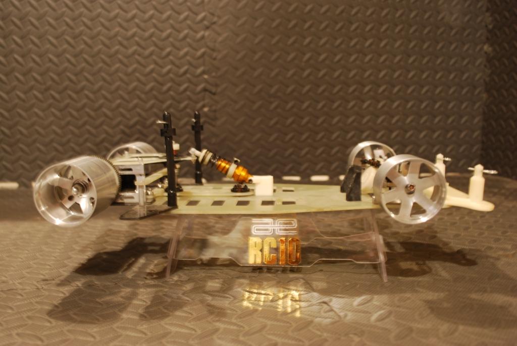

I received the aluminum rims from Reg. I forget what make they are so if anyone knew, I would love to know.
Where can I get foams tires for them?
Front setup

The front end is made by cheetah racing fully adjustable,the rims are made by a rc10talk member bigjeep...? Forget the exact spelling :? You can get foams at rc4less
Ryan

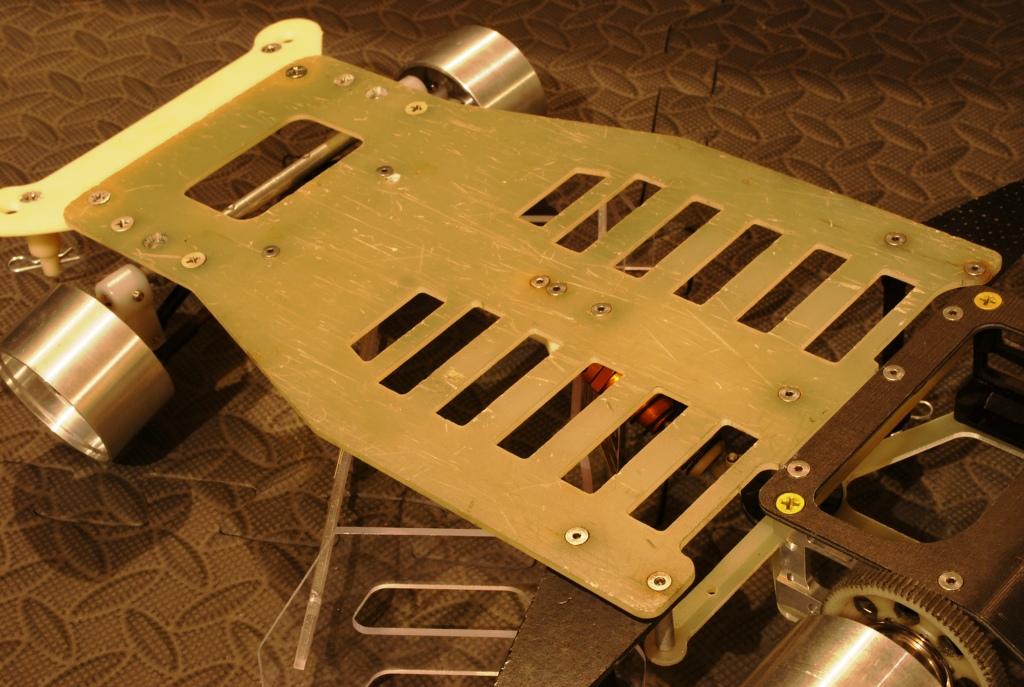

I'm not sure you will be able to remove the deeper scratches on the bottom of your chassis ,but you can certainly lessen their appearance by smoothing them out. I would hit it with 3M wet 600 grit then down to 1200. You could go with 400 too ,but use caution as this could add to the scratches with more aggressive grit. Use water when sanding and a sanding block or a block of balsa wood to keep it flat. Sand in one direction only. Get a pack of Micro Mesh polishing cloths for a final smoothing as these go all the way down to 12000 and will really bring out the shine. Check page 3 of my rusty RC12E resto thread to see the compounds also I use. That's going to be a sweet car. 8)

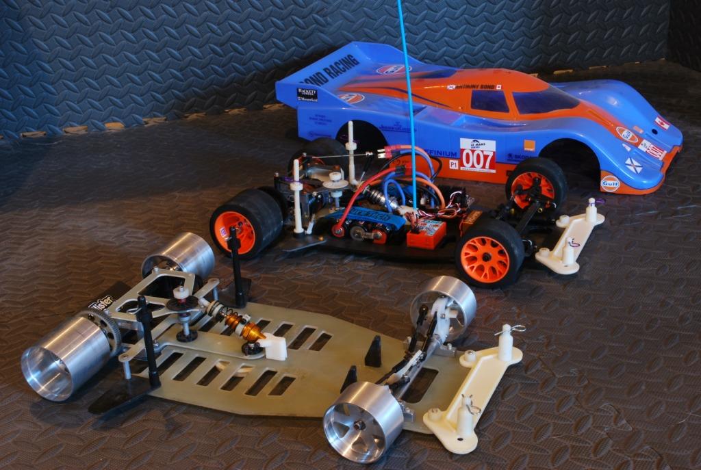

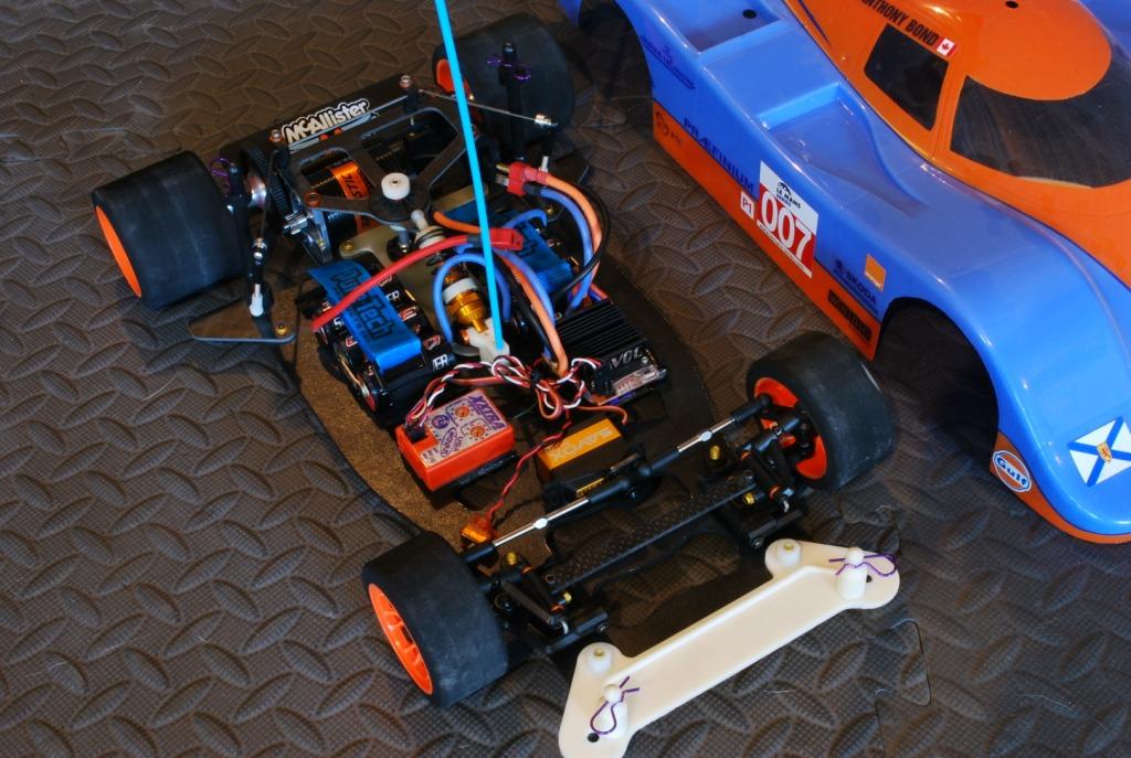

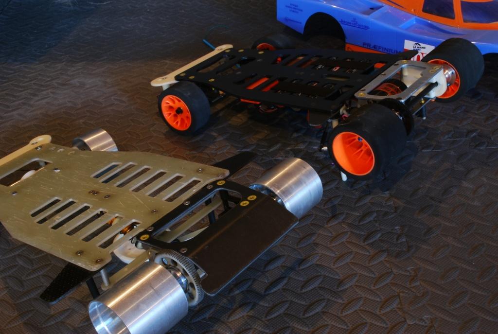

Some of you have probably seen my other 10L build and for those that haven't, it the Gulf car in the photos below. I wanted to swap out some parts on each of these cars to better suit the other one. So far I count about 6 or 7 things I want to swap out, the shock and the bottom plate being the main focus, but also the pivot sockets, rear body posts, left hand rear bulkhead, damper washers and springs, and the plastic axle bearing adapters.......I think that's it, lol.
Here is what I'm working with.

Got everything sorted :D Black parts on the black chassis and white parts on the fibreglass chassis. Everything on the Gulf car looks great and I'm liking how the Toyota car is coming together.

You can wet sand the chassis and polish it with simichrome polish. That's what I used on mine. Look up a guy on here named durb69, he has several posts about refinishing these fiberglass chassis.

unclemikey1978 wrote:You can wet sand the chassis and polish it with simichrome polish. That's what I used on mine. Look up a guy on here named durb69, he has several posts about refinishing these fiberglass chassis.
I've been looking for the method you guys used but am coming up short so far. Ive seen the result of one of his chassis on one of you threads and that chassis looks sweet. I've seen all the sand paper in your photo too, but no details. You got any links?, I'll keep looking

For now I'm going with a 400 grit due to the deep scratches in the chassis. Then I'll probably proceed with a 600 or 1000 grit and then a 2000 grit before I spray it with Future (an acrylic finish) for the final coat. I'm going to do the same thing with all the aluminum parts to the 2000 grit and then use Mothers aluminum polish. I think the car will be nice and shiny once it's done.
