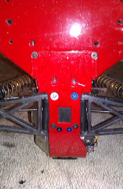

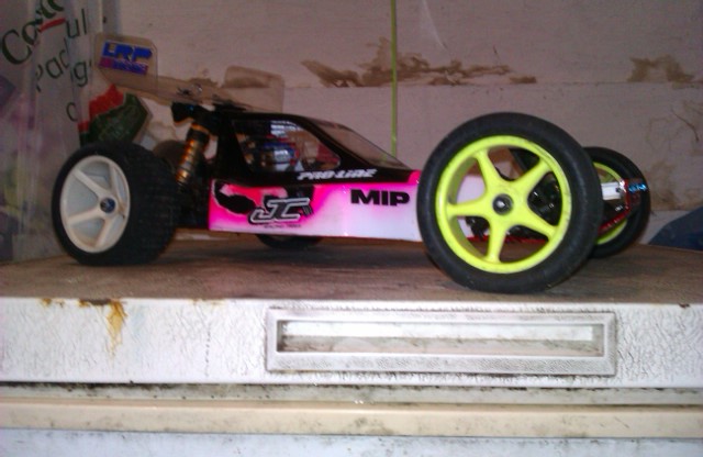

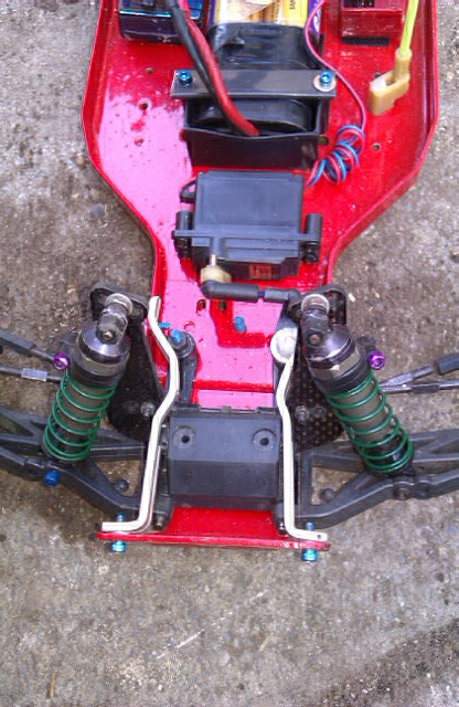

Hi all, has anyone out there fitted b3 suspension on to to a tub chassis ? Got a spare tub and loads of b3 suspension bits, don't look to hard, has anyone tried it ? Thanks all, have a good one.

im not sure about b3 but if its the same bulkhead as a t3 then yes it will work on the front.. you must trim the inside of the arm to fit it on the mount. i did it with t3 arms on the front of my buggy for my mega wide project. (still did not finish this project but i did mount the arms)

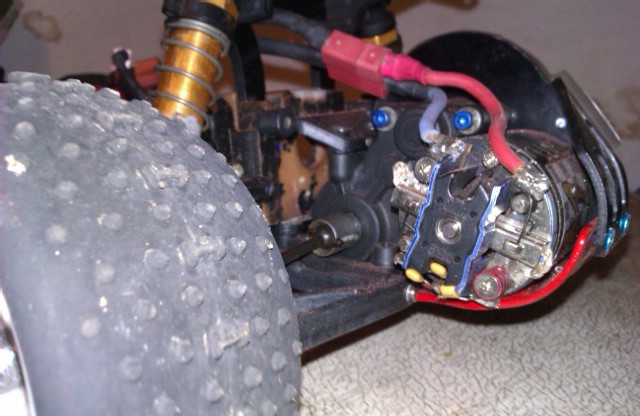

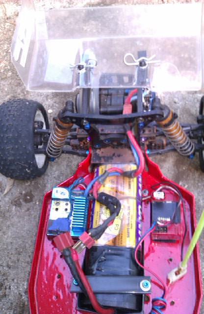

Please post more pics!! Under side and tranny area, bottom, front, just more and info on how ya mounted the tranny please.what axles or cvd's did you use? How it handle?

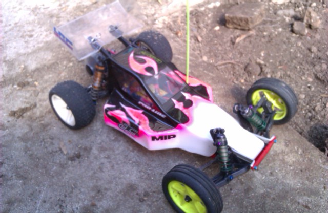

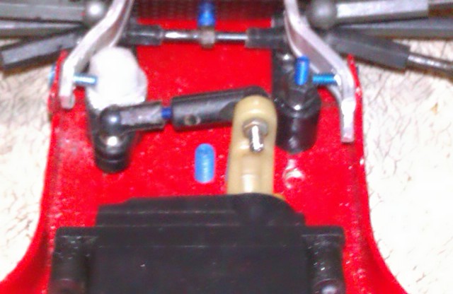

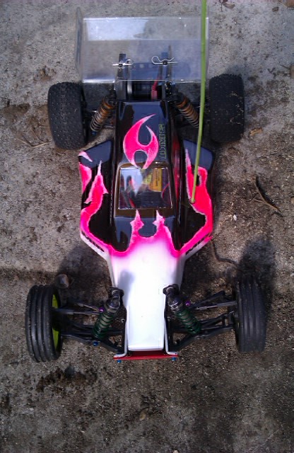

Hi, will take some more pics later, handles like b3 but its got loads of steering, goes very well with brm 12double in the back, front was easy to do all b3 bolts right in, rear was harder, tried to redrill tub but no room for b3 arm mounts, had to cut tub behind bulkhead and use b3 rear plate, everything behind bulkhead is b3, more later folks, have a good one.

Kool..to make the rear work you had to cut off the back to mount the new section to use the tranny.I have a b4 and I want to run it in my rc10 runner plus I like the long arms.I tried the rc10 t with buggy wheels but its just not right.and handles even worse.lol.I had a b4.1 I used for my graphite woin build but sold what was left but the tranny.I like the better ratio it has.(wish someone would make a alloy case to put b4gears in).thanks for the pics it gave me some insight nice runner !
