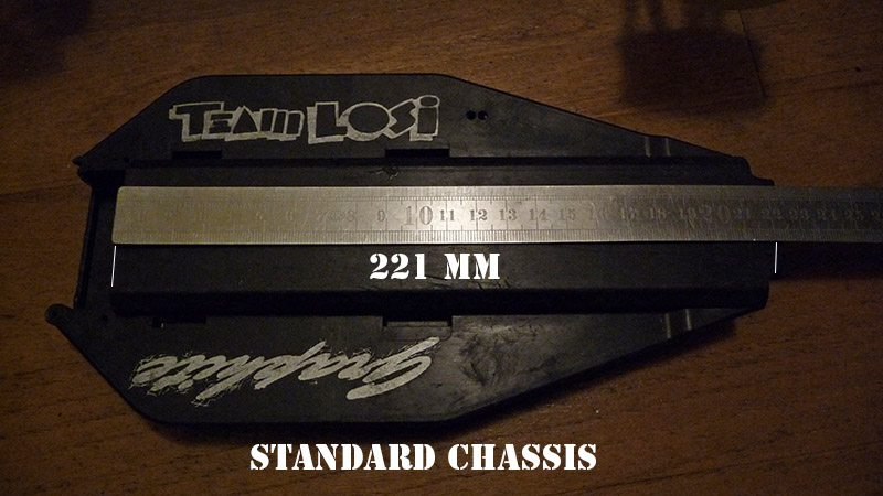

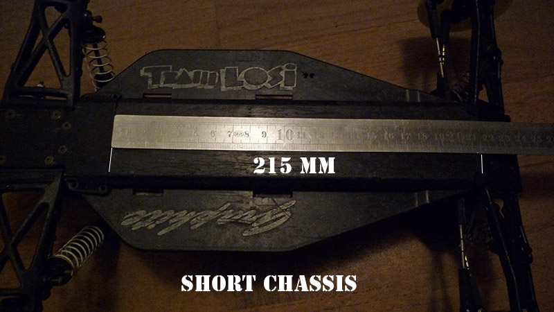

Interesting question! My track is also an old 1/8th scale design.
I measured short and std on the flat part, not including front hinge, if someone can measure the long chassis we will know!

I just measured it the 9903 Chassis vs the 9904 vs the 4102, there is only 1/4" of difference in the length. I don't have the 4100 chassis here to measure, but I don't recall is being all that much shorter than the 4102 XXT chassis.

232mm on the 9903 I have at my desk.
