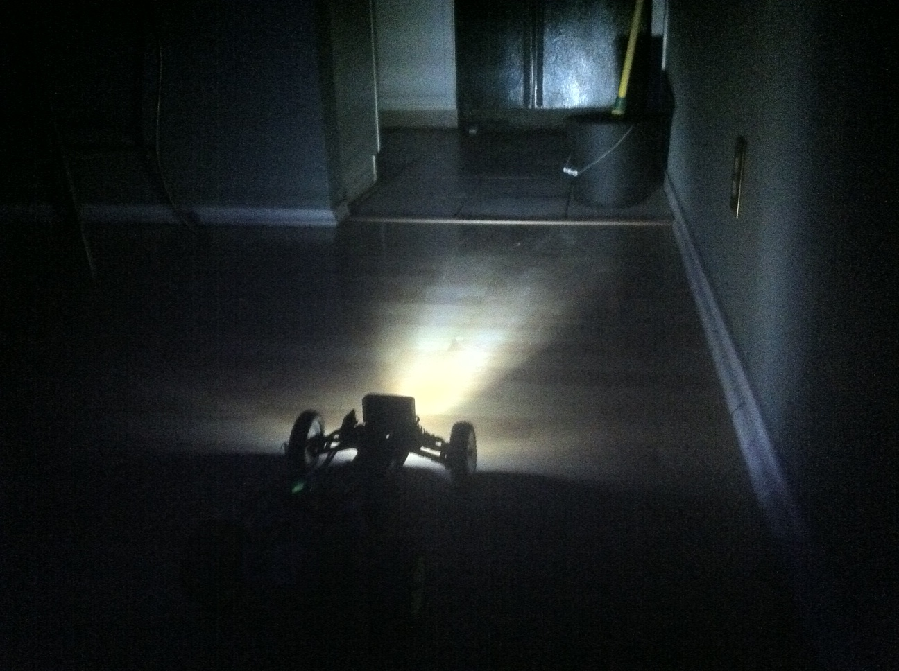

I went ahead and made an aluminum skid anyway just for grins, and got a little carried away with it...
Serves as good just-dicking-around protection, and is attached via the steering screws and front body post screw. Light pattern ended up being absolutely perfect for driving around in the street at night. First soldering/EE job in a long-ass time... Finished up the light controller (for use with channel 3) last night using an old stripped AE servo.
While the paint fully cures on the skid ('tis but a beater thing, after all), I've finally been fitting the V2 shocks, new shock towers, and a whole bunch of other crap to the car.
