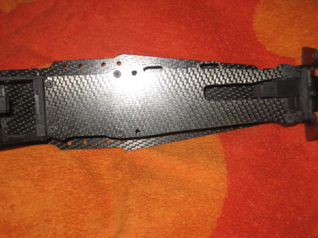

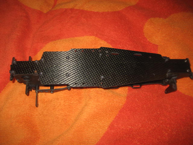

Those paying attention may recall that I wish the SWB Mid chassis was shaped like a saddle pack chassis. So, rather than resort to cutting out pieces of tin again, this time around the heart of the build is this custom SWB chassis I had Fibrelyte make for me
And hand in hand with the chassis is the Carbon Fibre upper deck, keen eyes may spot the difference to the standard upper deck.

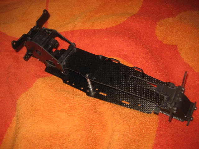

Now for the exciting part. I got to break the chassis out of the plastic, along with a few other parts
I actually had a second front plate made which was a different shape, but I decided to use the standard looking one on this build, this one is probably stronger and I plan to put it on my LWB Mid runner build at this stage
So all of that brought me up to here

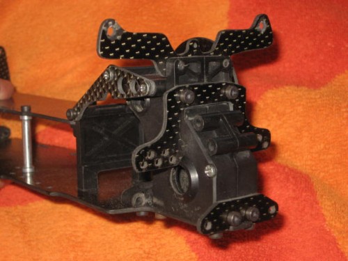

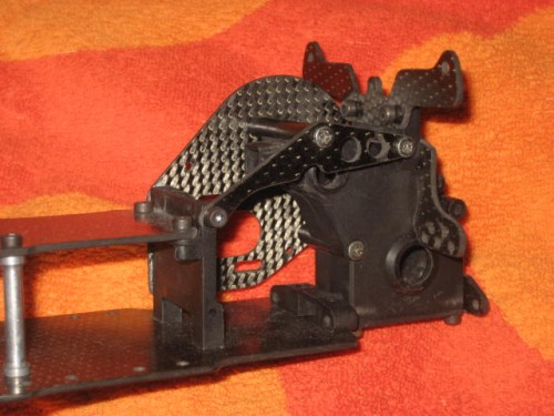

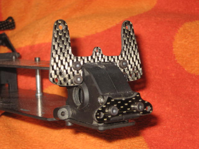

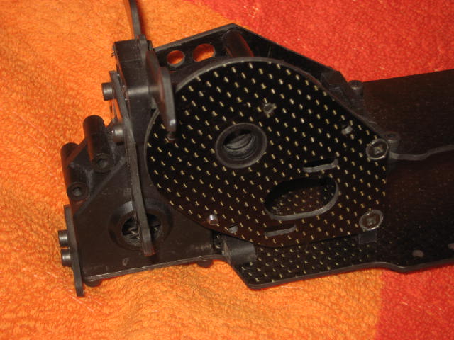

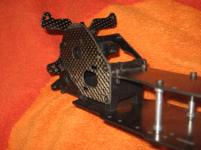

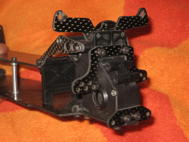

OK so time for a bit of an update. I'll spread this over a few posts as there are quite a few pictures.
First up was to bolt up these ( I had to mod the front shock tower to clear the bulges on the gearbox cases where the outdrive bearings sit)
And these
I remembered A&L Ballraced bellcranks from back in the day so when I found out you could buy them new I ordered a set right away
So, that lot got things to here
When the Lazer came out, I noticed the new design of the wishbones and the outer link and always thought it would be great if you could have those arms on a Mid. I didn't know at the time that they did indeed fit. I also got the MPP rear arms as they were on eBay, they are period correct and only having a rear pair made them cheaper and they are a closer match to the Lazer front arms than the stock Mid rear arms
