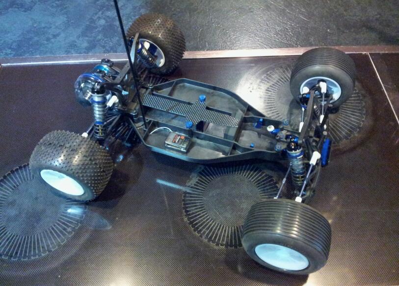

I know this will probably be a dead end but what non forward cab bodies fit a T4.2 ? The front shock tower is the tricky part as it is taller and wider than a "standard" tower which wont fit in a normal stadium truck hump.
I was hoping to use the factory T4.2 tower but hate forward cab bodies so much that I'd put a older tower on it just to run a normal body. I was hoping for an old school look.
The T2 body fits with an old tower and swapping the shocks to the front of the rear tower. The T3 body fits with the older T4 front tower.

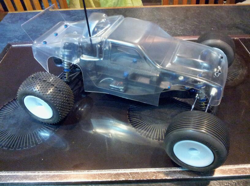

Re: What bodies fit a T4.2 ? (Problem solved)
After playing around and a bit of luck with front body mounts I managed to get a T2 body to fit. I didn't think it would fit properly due to the rather different front shock tower.
The front shock tower is a fair bit wider and wont fit in the hump of the body. It touched the top of the fenders before the body would hit the posts. I thought I'd have to cut and extend the stock front body mounts. Luckily I had some SC10 body posts which fit in the stock location and were longer.
I was also able to leave the shocks on the back side of the rear tower although they would fit the body better on the front side. I'm pleased all the factory geometry hasn't been altered.

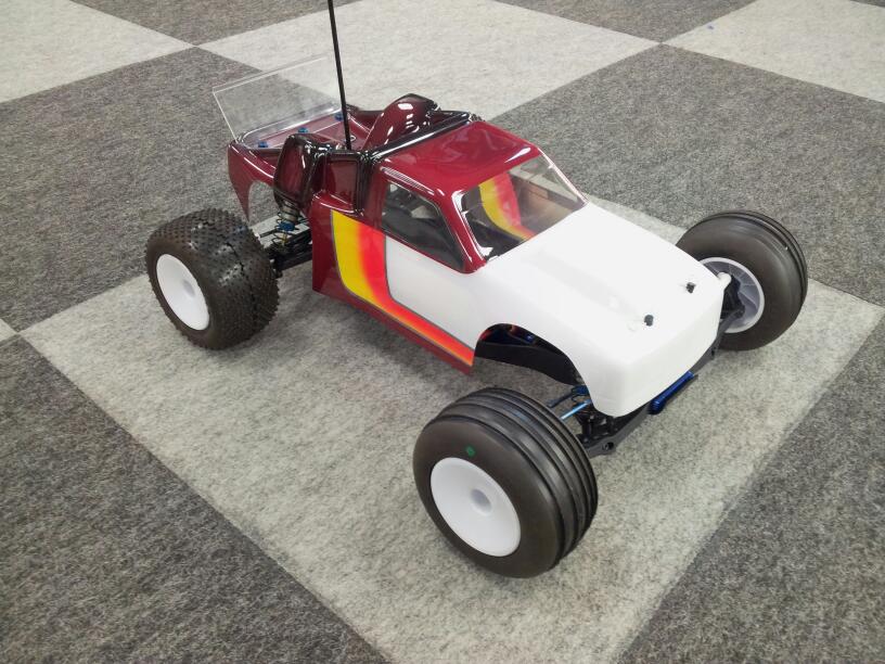

Here's my retro rendition. I was hoping to have my stickers made by now but they aren't ready so here is a teaser.
