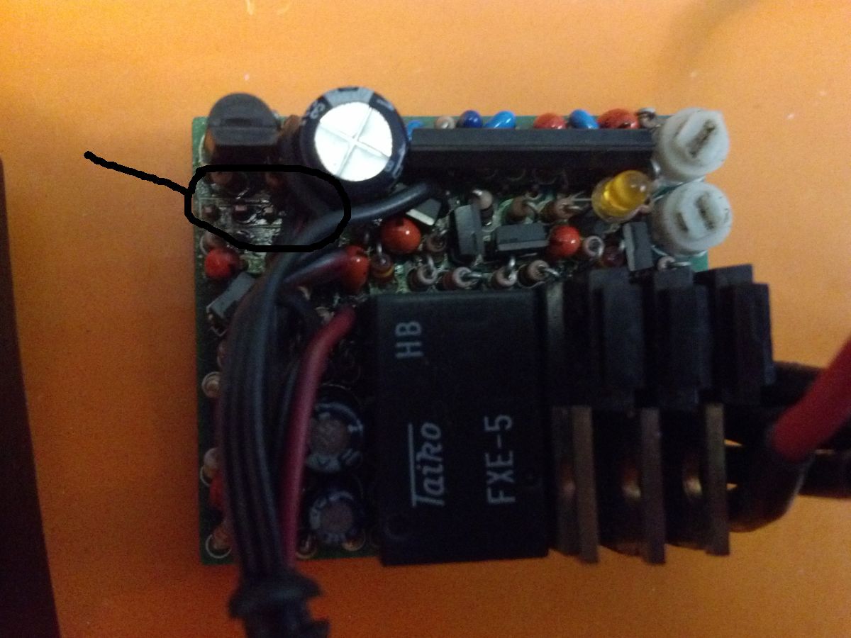

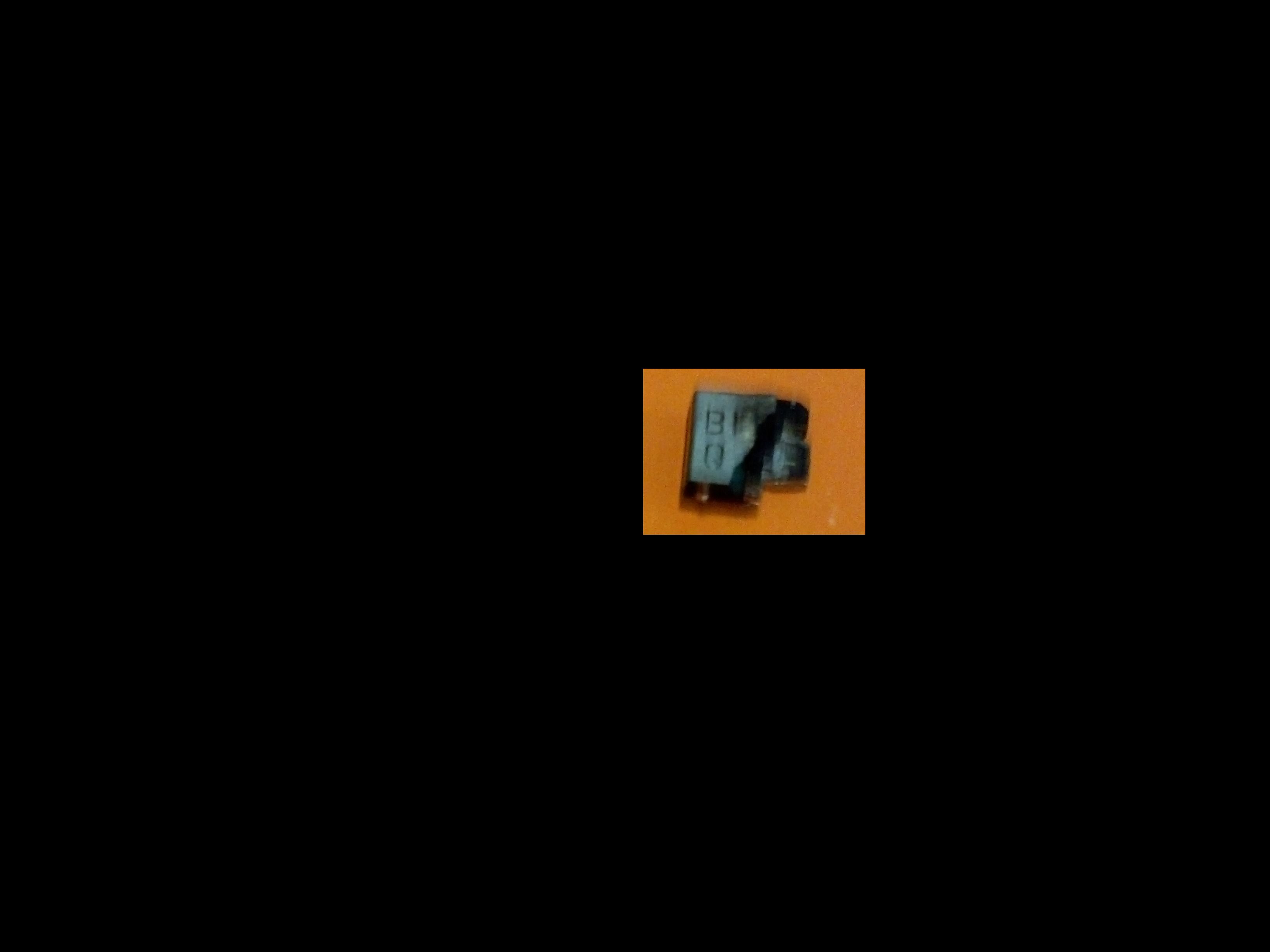

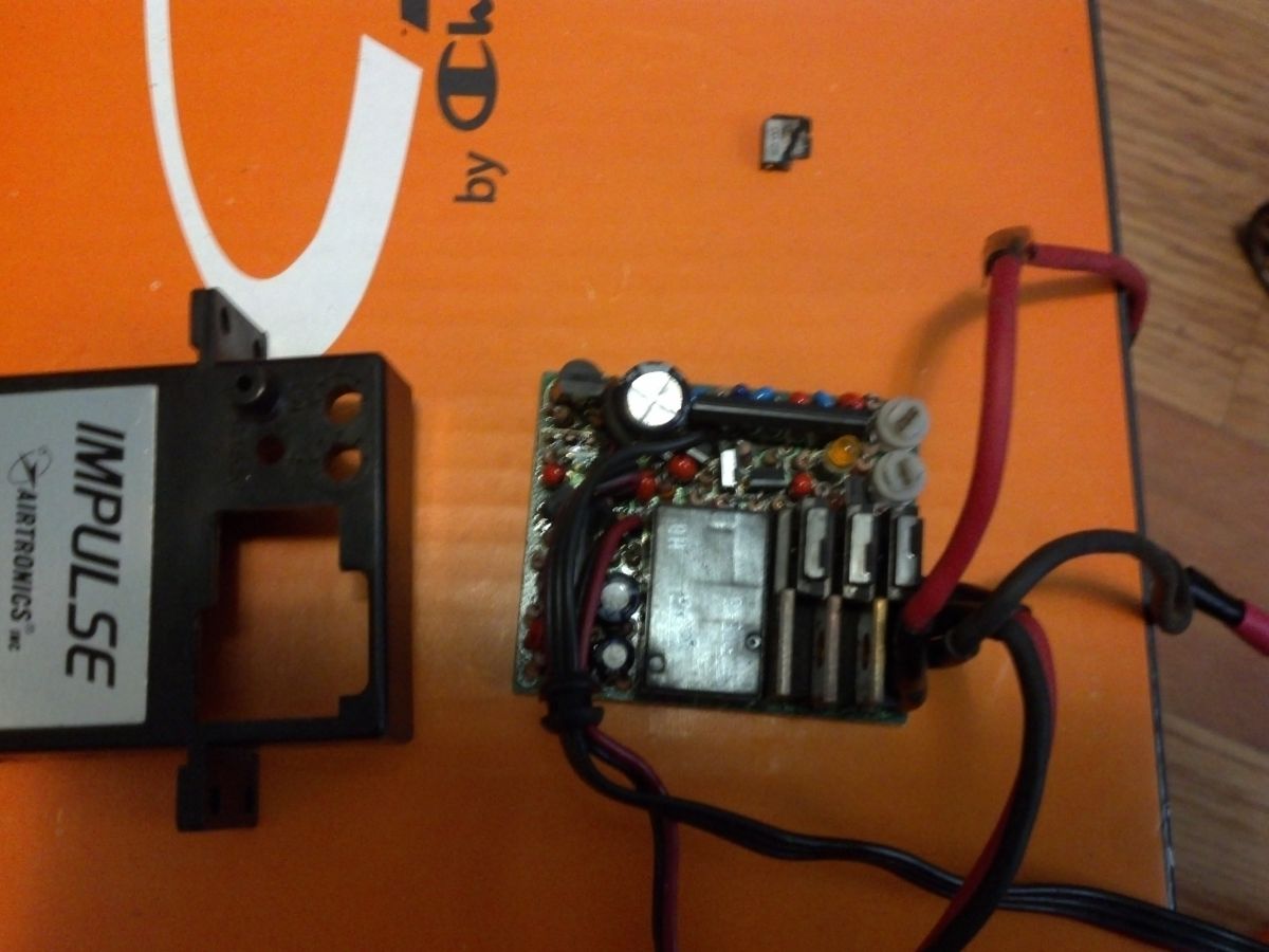

I opened it up and found a fried transistor. Attached are pictures of the whole ESC board and the pitiful remains of the transistor. It had 3 wires going to it, and the place it was attached is circled on the board.
Any idea where I can get a new one?

Did you look at the picture of the blown transistor? I can make out a B, and a Q underneath it. I think there was also an R somewhere. Can anyone help me narrow it down? I don't even know what categry of transistor it would be under.

From the pictures that you posted and position in the board it is most likely a voltage regulator not a transistor. If you reversed it you would have blown out a cap for sure. Sometime you can use a substitute modern part but the specs have to be rather close.
Can you post a good photo of both parts of the blown part.
But before you go though a bunch of trouble do a multimeter check of the fet bank. If your fets are gone you may be out of luck.

No, I am saying that you did not reverse it. If you reversed it the first thing that blows up 90% of the time is a capacitor. In your pictures there is no capacitor damage that I can see. That does not mean that a capacitor is not bad. The first thing that you should check is the MosFet. There are six of them in your speed control. Make sure that they are still good before you go and start chasing parts that surely obsolete. I have successfully repaired many ESC's. The most common problems are pots and fet's. If either of these are bad it is not always easy to get an equivalent spec part. They have to be a very close match or else it will not work properly or not at all. The voltage regulator is used in the BEC built in the ESC. Most of the time it is used to drop the voltage to something between 4.0 and 6 volts and keep it stable. The function varies with the spec of the speed control. The little bit of metal is a heat sink. Just because it has a heat sink that does not make it a power transistor aka MosFet. There are lots of components that look similar but have completely different functions. Once again you have to have an equivalent part that has a very close spec or else it may not work or burn up something else like your receiver when you plug it in and try to test it.85Edinger wrote:Hang on, are you saying that I ran it in reverse, blowing the transistor?
