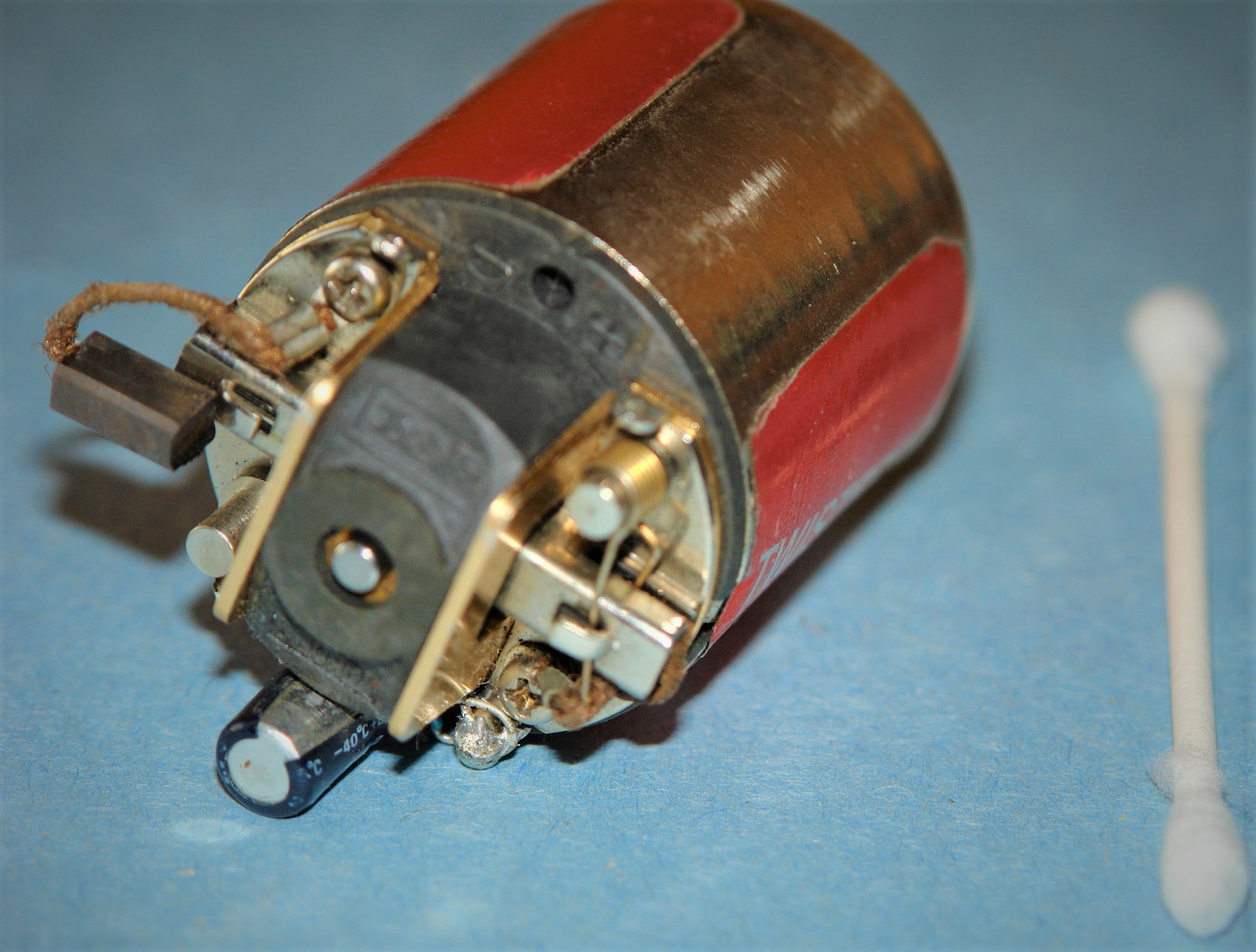

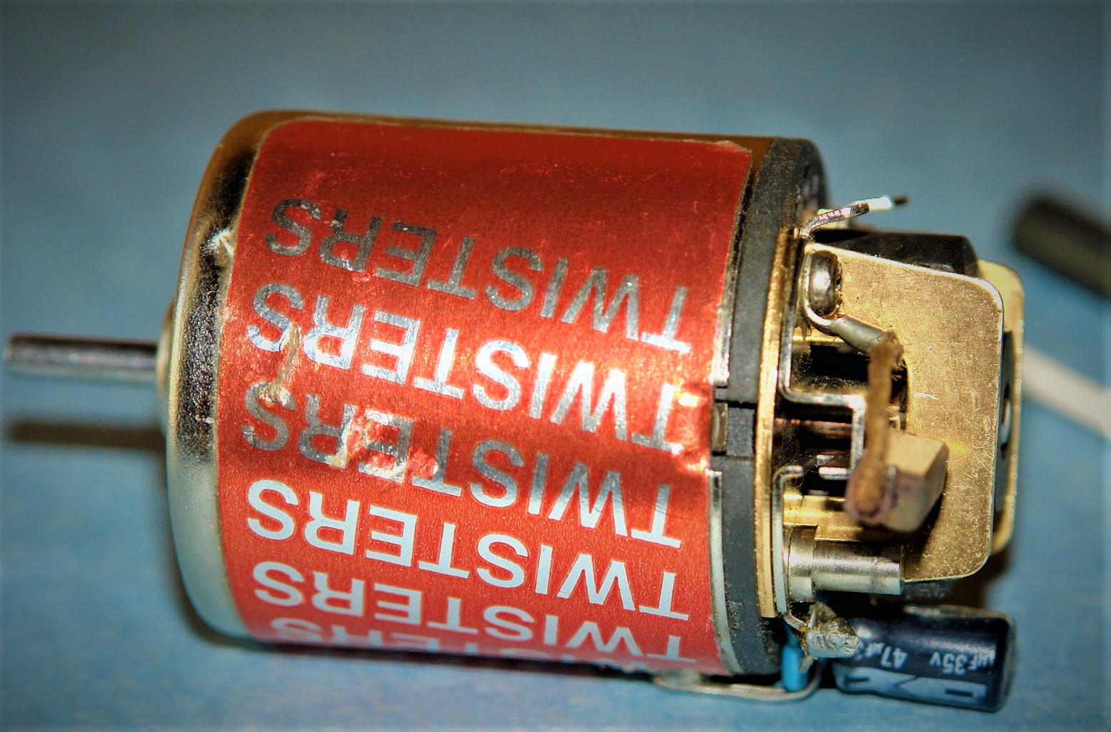

Before you apply a full 7.4v try something smaller. If the motor is bad, that is probably way to much power to put through it. If it is OK it will spin like a whirling dervish, way too fast! Slow and easy does it.
Disconnect it, rotate the motor in the correct direction with your fingers. Does it turn freely? Does it feel gritty, scratchy or just plain wrong?
Put a lube on the bearings, both ends of the shaft.
You can carefully, carefully remove one or both brushes by unclipping the brush spring and visually checking the brush for wear.
When you reinstall the brush put it back in the exact way it came out!!! The brushes wear in the direction of rotation. Putting it in backwards will probably chip the end of the brush and will not do the commutator any good at all.
If after checking for bad bearings you carefully remove a brush, look carefully at it for wear, chips or anything odd looking. Also look at the commutator and check for dark or burned marks.
The top pic shows a brush that is used but not completely used up.
The bottom pic looks into the motor to show the comm.
The least aggressive cleaning would be a Q-tip with alcohol placed down the brush hood and rotating the motor by hand.
These brushed motors need to be cleaned and lubricated regularly.
Chuck
