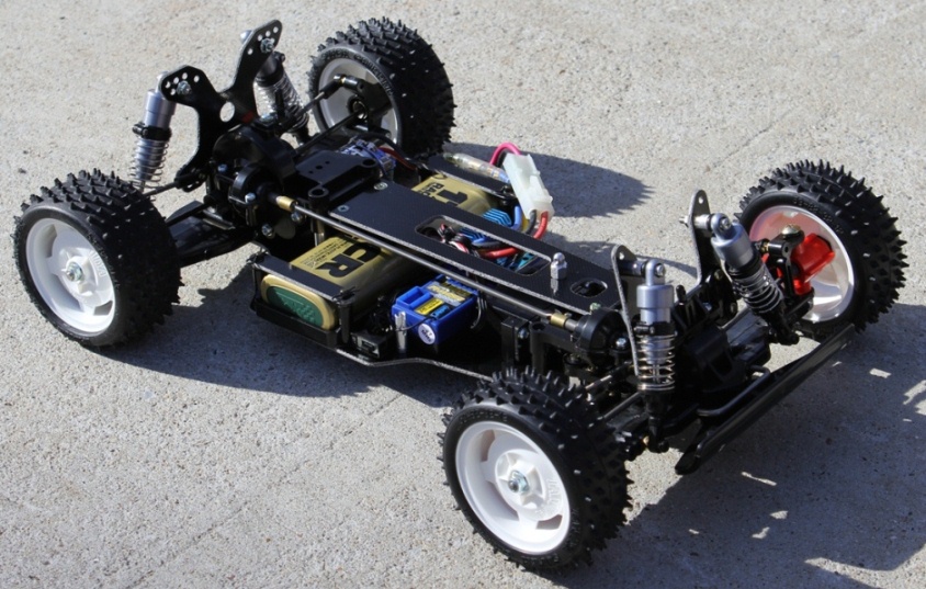

Yup, been busy building....
Top Force with Hi Caps, full bearings, full electronics. The fronts are the minis when they need to be shorts. Got the short bodies on the way....
I will have some serious paint work ahead of me when the weather warms back up!

I think the Top Force would do okay in 4wd buggy at the VONATS, but there's too much plastic that can break, in particular the steering knuckles. Also, the mounting points for the gearboxes (the front in particular near the steering rack) tend to crack/break.
You can certainly pimp it out with alloy goodies (as I have done to mine), but something this pretty doesn't deserve the abuse of hard racing. If I were to run this platform, I'd run a Manta Ray or Dirt Thrasher in the classic class and then take a CAT, YZ10, or Lazer into the 4wd class.

the plastic holds up just fine. the only alloy upgrade i'd do is a propshaft.
"alloy aint for race cars"

I agree with Dan, minimal alloy, prop shaft, motor mount, maybe hub carriers, that would be about it.
Whether the car could race hard and reliably with a 10.5 I don't know, but it'd probably cope with a 13.5 ok
Bear in mind that the top force qualified 4th in the 1992 Euros in the hands of Lee Wright so it has the potential to go quite well

the drive train will hold up to a 10.5 no problem, i've run hotter in mine for long periods.

Some things to consider when racing a top force or any ta01 based buggy: The drive train is extremely draggy. The slower it spins, the more efficient it is, so big race type 2.2 tires are best. I liked mine best with a 1 way in front. Several different ways to do this, with the Tamiya torque splitter, or aftermarket 1 way bearings. Back in the day, we would boil our Tamiya plastic parts to soften them up. This would help them to flex a bit more before actually breaking. Its kind of like annealing metal.
