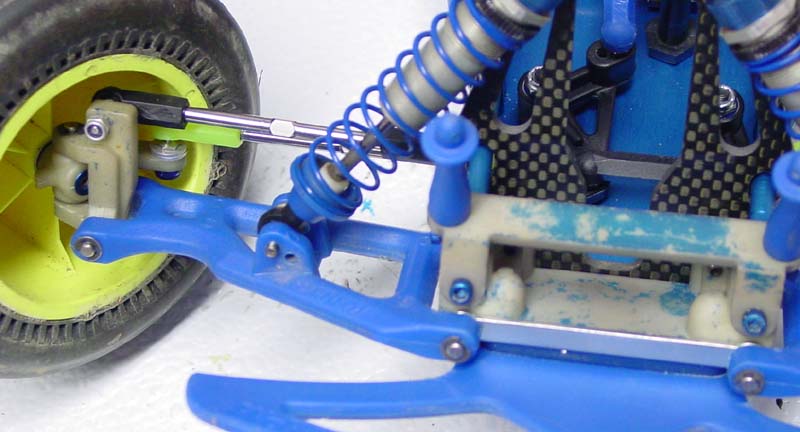

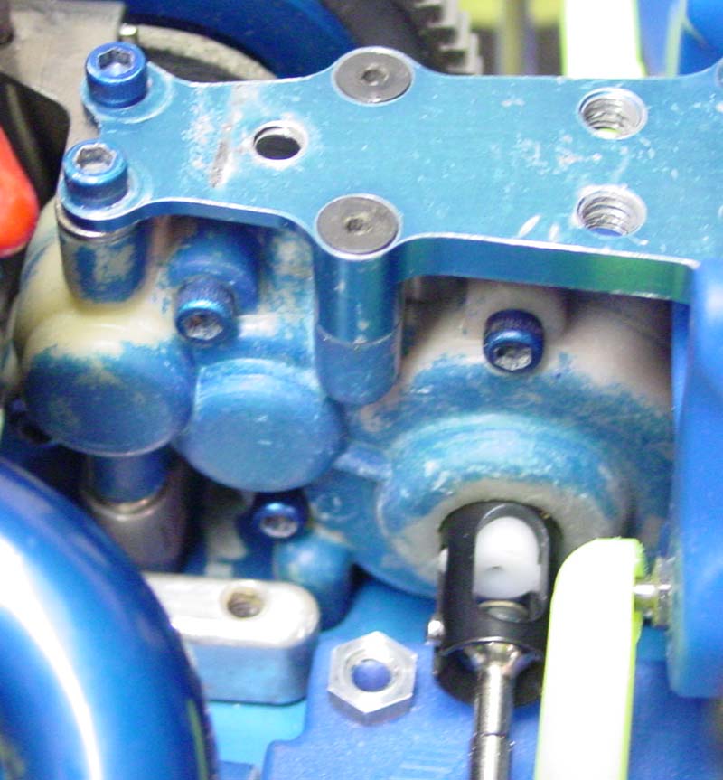

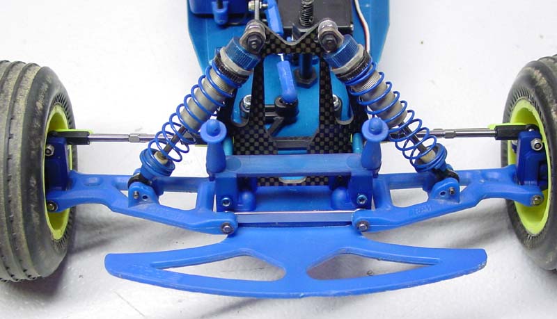

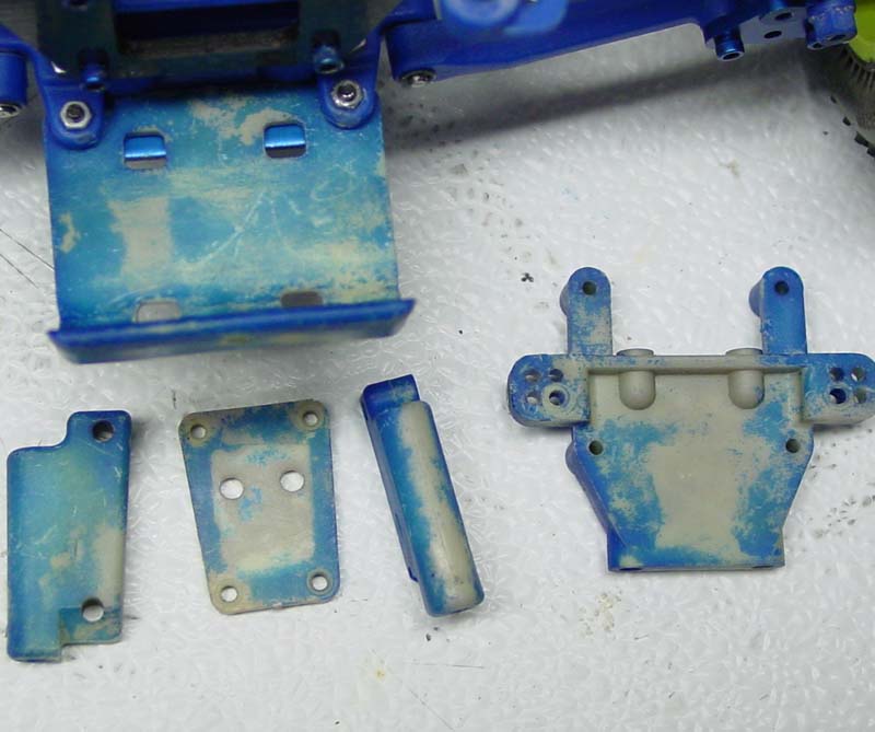

I went to get some parts out of the GT parts bin and noticed that the ones dyed blue recently were splotchy blue and white. took a look at the truck, and my gt turned back to white!
it went from this: to this: Any Ideas why?
I used the Sharpie marker for a dye source, I guess I gotta use good ol' rit when I re-do it.

I'm gonna guess that there was so much oil in the plastic the the sharpie didn't really penetrate. Try soaking in acetone first, and then soak in denatured alcohol. Finally do the detergent (oxyclean, or some such) soak and rinse. Either re-dye with the sharpie (don't let the kids see...
) or use real dye.

The parts that the dye job failed on came from a GT I parted out... they were oily green from being soaked in Blue Thunder nitro fuel for the majority of their life...
Another round of cleaning and they should take dye. The 'hoopty method makes sense but it may take a few attempts, maybe a few days apart, to be sure it takes.
