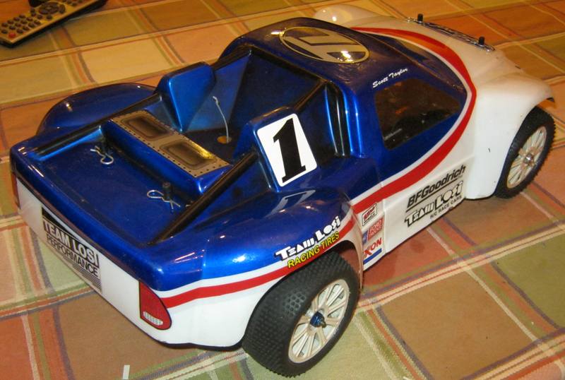

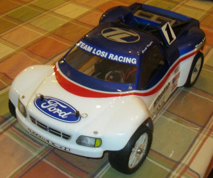

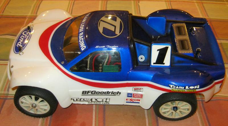

Hey everyone,I hope all is well.
So,I finally managed to score a non Hot Weather body for my restored XX4,only to find the front of the body doesn't fit through the front shock tower. :?
Do I need an early one?
I have a new Graphite one on there,right now.
Got my XX4 runner lookin' good and going well.
It's running the Mamba Max and Orion 7.5 from my old B44.
I re-decaled the body,too...It hurt cutting that NIP sheet up,but was worth it.
Just need some white 5 spoke rims,now,those Rulux rims are not the go. :roll:
