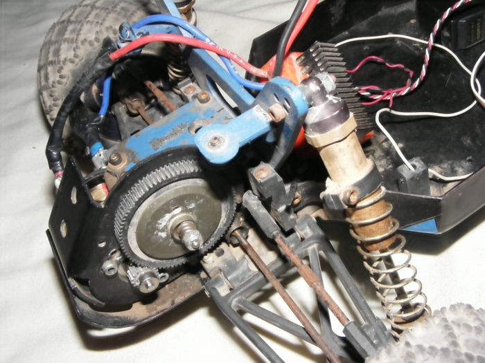

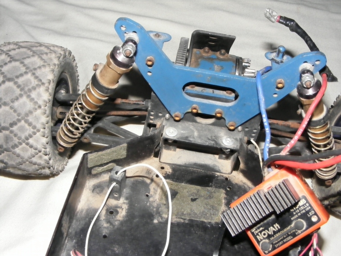

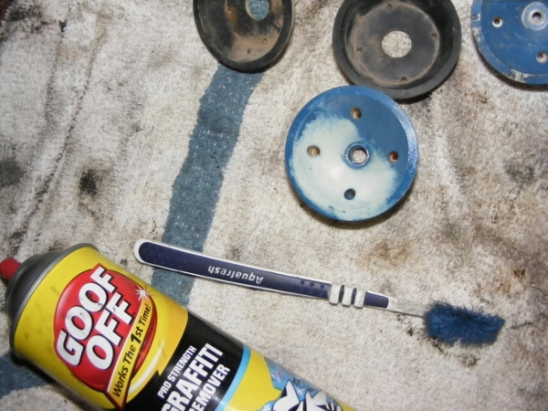

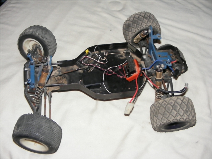

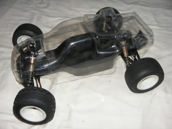

I recieved the truck today. Like 36 hour shipping. Oh boy. It's definately a diamond in the rough. Put a crystal and battery in the truck and all the electronics do work. Has a Novak 410-ms esc, Kyosho super stock motor , futaba 148 servo, and a futaba reciever. The gears are meshed real tight. Check out how they have the slipper clutch setup. Diff seems pretty good. Look at the antenna mount. A first for me. Going to go with the 3 piece wheels. Appears that goofoff paint remover is going to be my friend. Even the chassis is painted. The body has dried tape residue bad. Maybe I can get it off. worst case I'll paint the body on the outside. I'm feeling a bit lazy tonight so I'm going to start with the wheels.

Well this might be easy enough.

I use methyl ethyl keytone or m.e.k. To remove paint. It does no damage and wipes off with a rag. Stay ventilated though. Nice score!

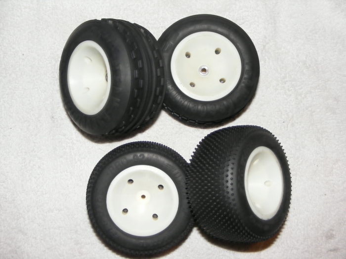

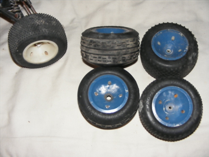

Ok, should be all down hill from here. About 3 hours to get them clean. Not perfect. Still a little paint in the pits and scratches but still pretty nice. I cleaned all 4 of the painted wheels. I used the proline 92's with foam inserts that were on the front of the truck. The front tires are pretty soft too. I'm going to set aside the white 3 piece front wheels that were on the truck. They are minty. not a scuff.
Thanks for the advice on the solvents. Probably a little cheaper than the goofoff too. The goofoff works pretty good. I even use it with a wire brush and clean up turnbuckles and hardware.

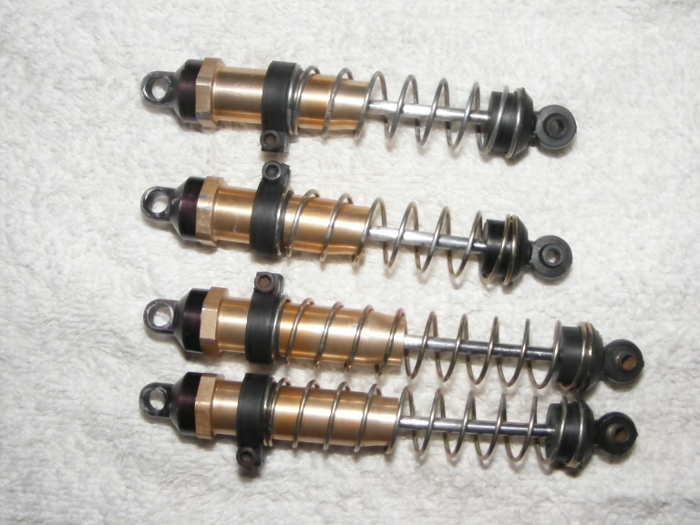

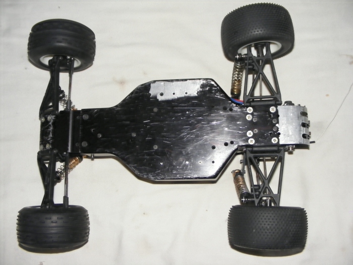

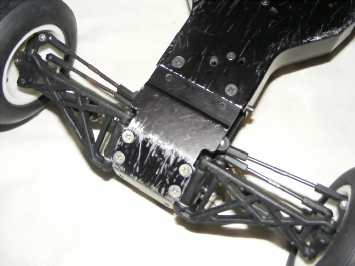

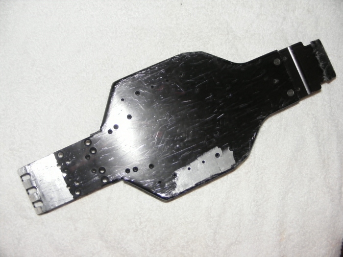

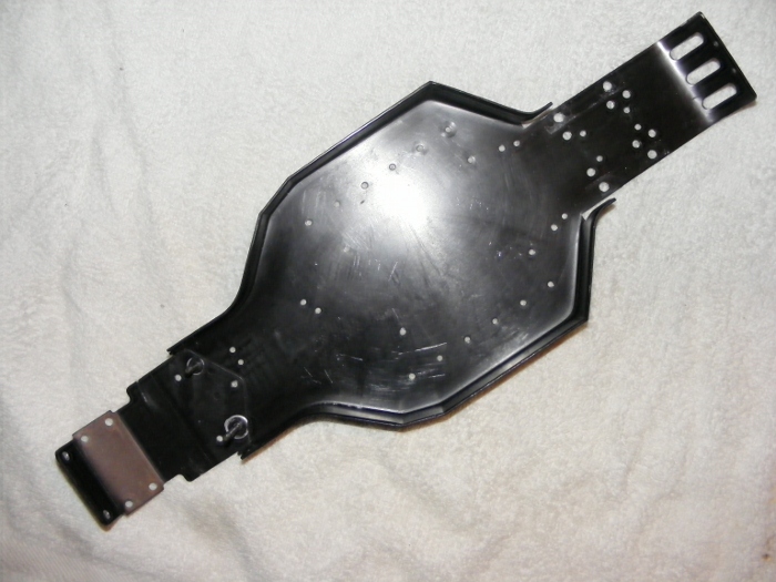

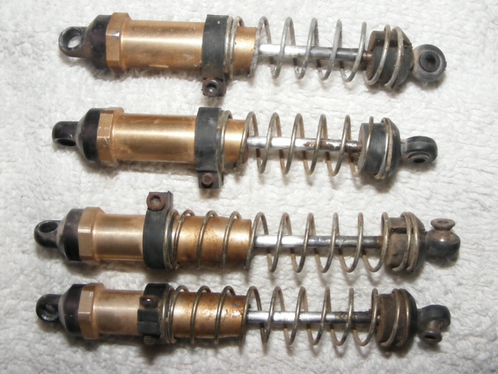

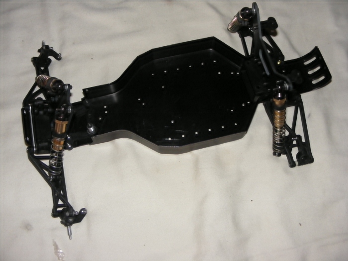

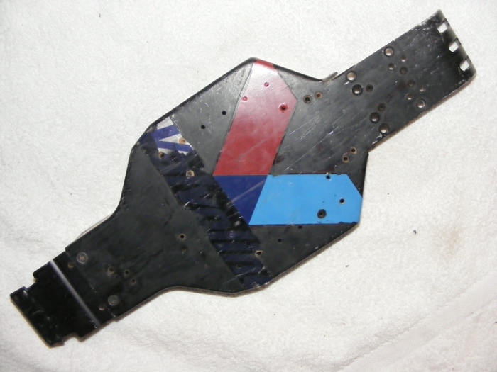

Been busy this weekend but squeezed in about 5 hours of wrench time. I have the truck mostly apart. I cleaned up and out the shocks and filled them with fresh 40 wt. silocine oil. After uploading the pics I noticed I missed cleaning out the insides of the rear pivit balls and one of the screw heads. I cleaned up the chassis and got the sticker and paint off of it. I'm a little bummed about the sanded spots but would rather leave them and not paint over them.

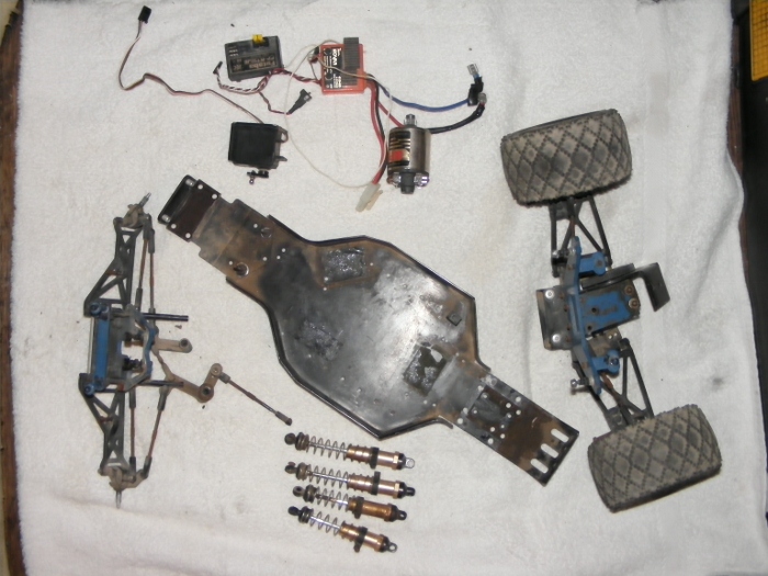

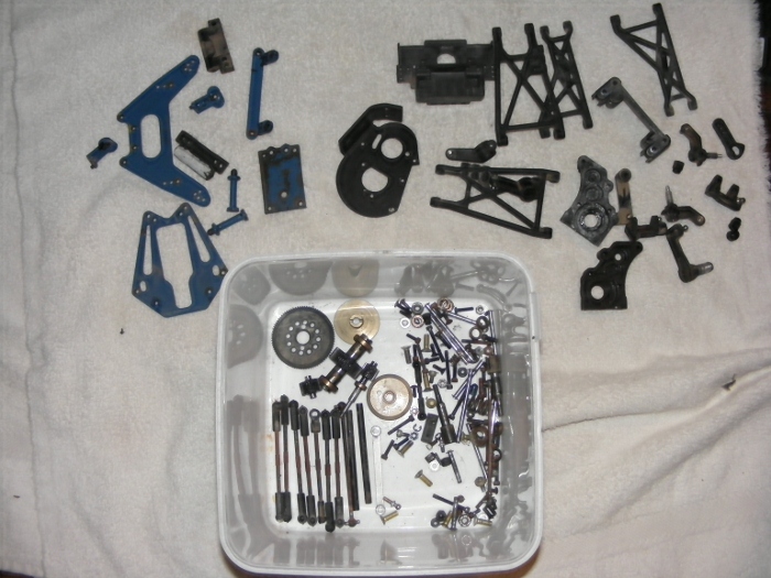

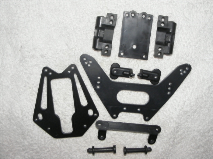

Thanks dude. 8) I finished disassembly and cleaned up the painted parts.

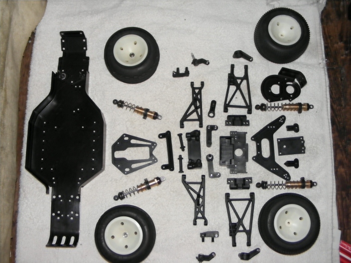

Finished cleaning up most of the parts. everything but the stealth. Most of the hardware is gross so its going to be slow going building the truck back up.

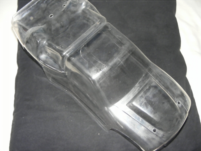

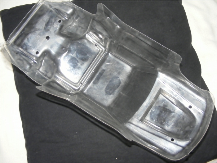

I got a little further on the build. Still have to do the transmission and electronics. The body came out pretty good. I used Traxxas 33% nitro fuel on a soft towel to remove the crusty glue residue. Still a few hazy spots but definately better than what I started with.

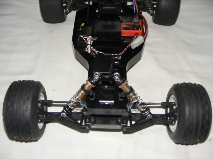

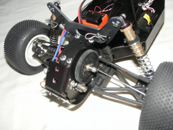

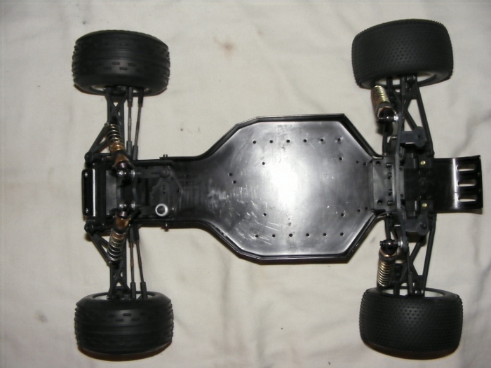

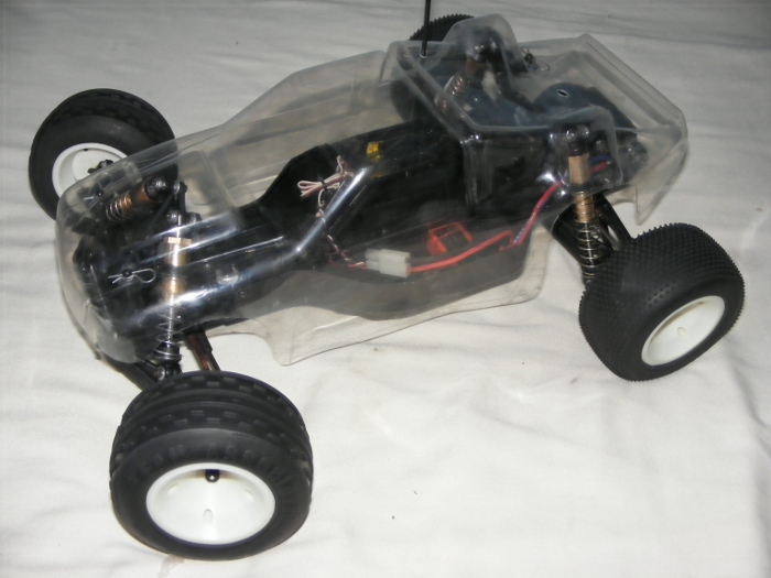

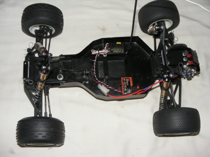

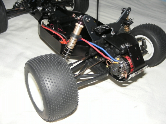

I just finished up the truck. Far from perfect but a long way from what I had started with. Still need to test drive but had the truck moving around here in the hobby room. Bet it woud of gotten a few votes in the pos pole. :?:
