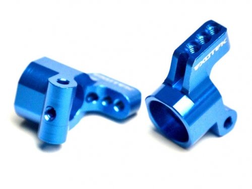

so im trying to set some wheels that have a really deep offset on my 10. The issue is because of the offset, im rubbing the turnbuckle on the rear carrier. Is there a compact version of these that is shorter or am i left with just modifying the ones i have?
Im running 3/16 UJ's so newer stuff can work too, it just needs to be shorter.
I can modify, id just prefer not too if possible
I think i should check my gold and silver build too. those might not have as deep an offset.

i guess i should have clarified, it would hit the rear carrier too if i were able to fully tighten it down. I need to find a rear hub carrier that is in general shorter in height. something like these but in plastic.
The B5 has a custom rear hub that is really small too. im not sure how well it fits though.

ive not used any custom works parts yet, how do they compare with assoc parts as to fit.
you were meaning these i take it.
http://www.customworksrc.com/ProductDetail.jsp?LISTID=80000415-1200011239

yes, those are the ones. I know they have been used for the WOIN builds but I don't know for sure how they compare to the stock hub. I do have a pair, if no-one else chimes in, I can take a quick measurement, but gonna take a little time to figure out where I put them.
the other option, is to just modify a stock pair. trim the top off, and drill a top mount ball to get you kind of close to stock geometry. you can also lower the ball on the bulkhead to compensate.
