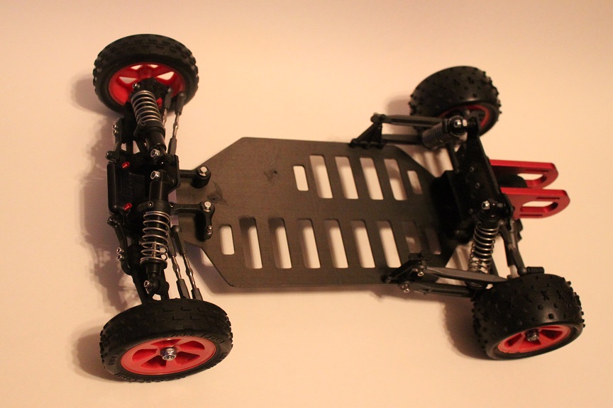

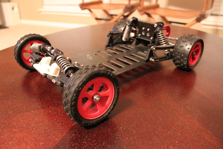

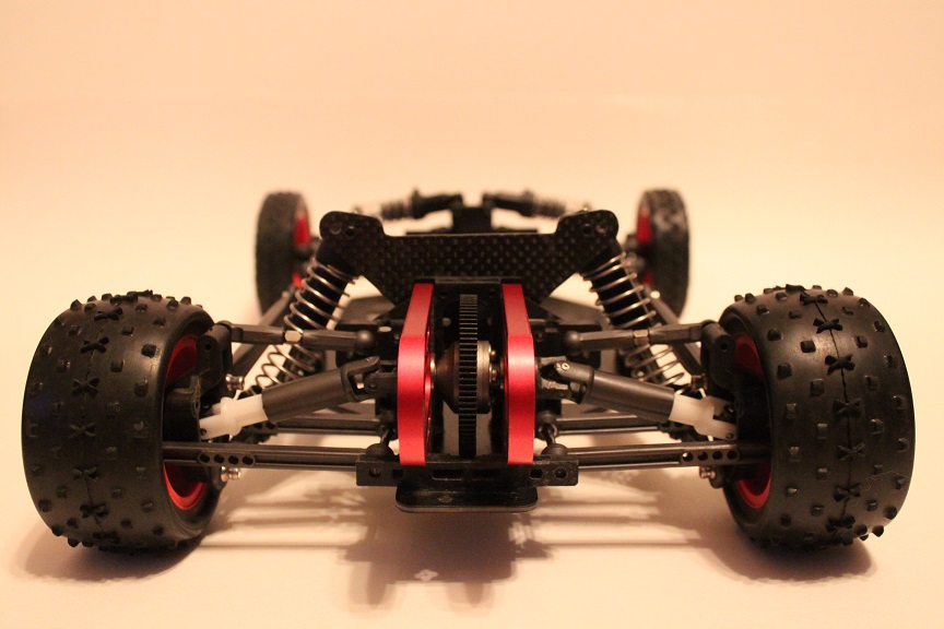

I'm currently building two different JRX cars on two different types of oval chassis. This is the first. The chassis is the Bullet Racing 7+4 oval chassis, more commonly known as the "where did I put my batteries" chassis. It uses the 5 link rear end with a JCar direct drive. The turnbuckles are Lunsford Punisher titanium and use metric ball studs and ball cups from the 22. The bellcrank is RPM. More info to follow.

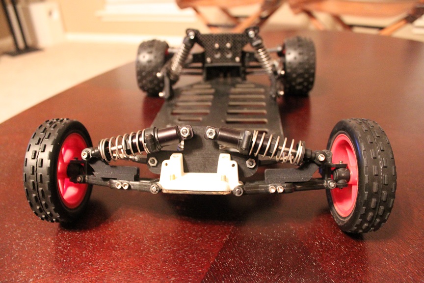

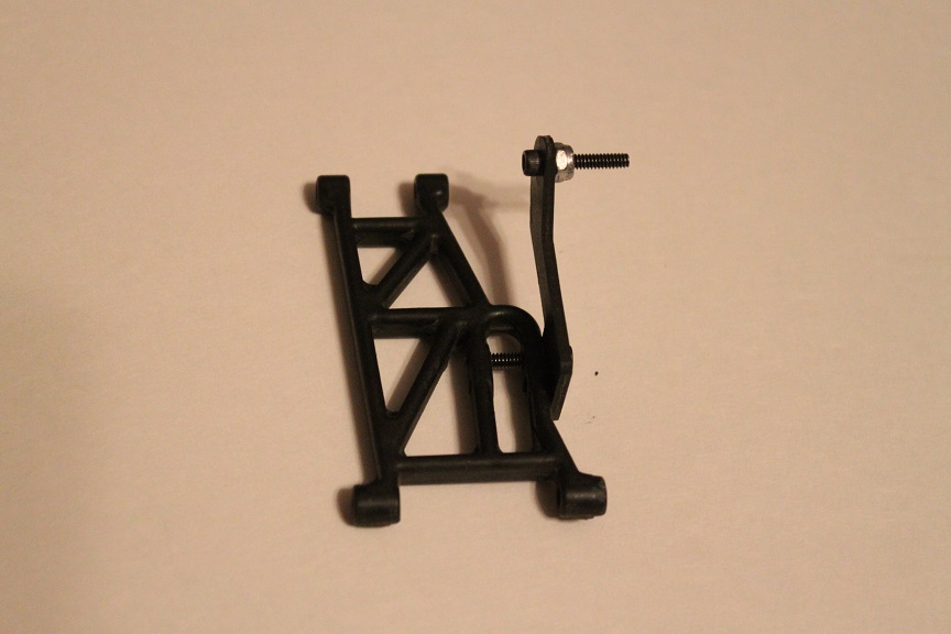

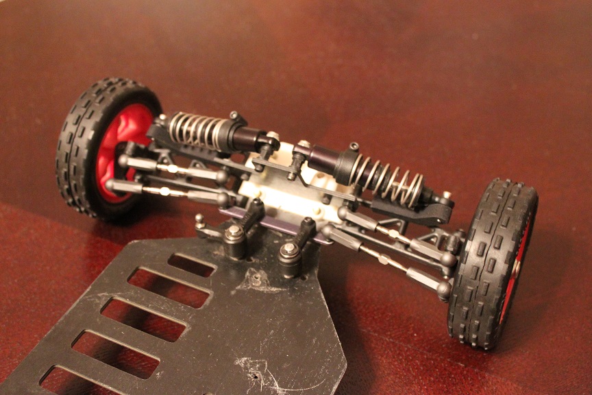

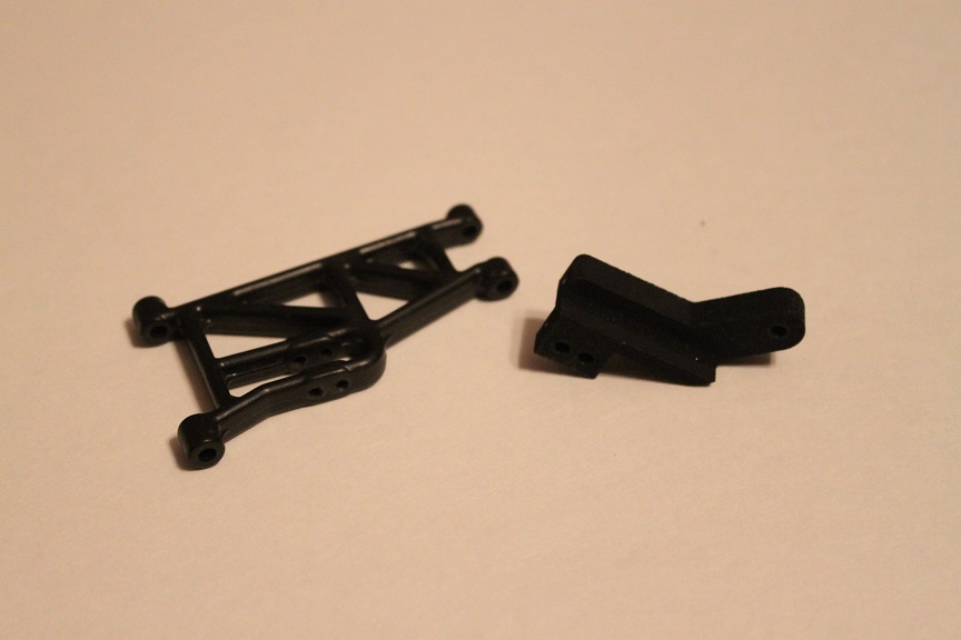

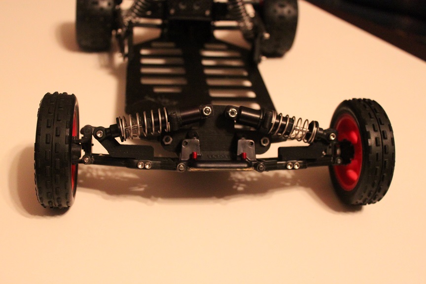

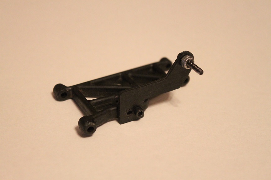

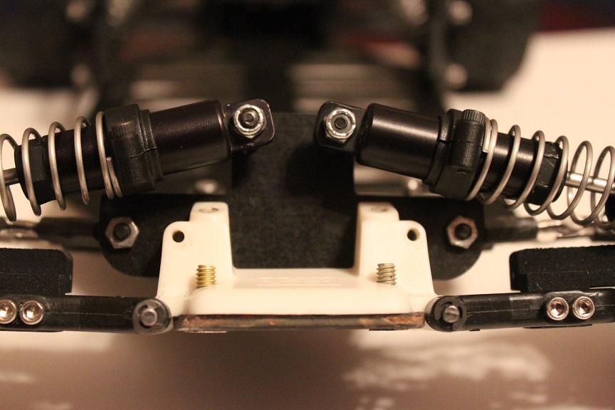

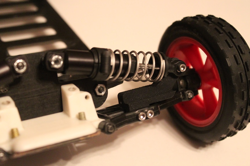

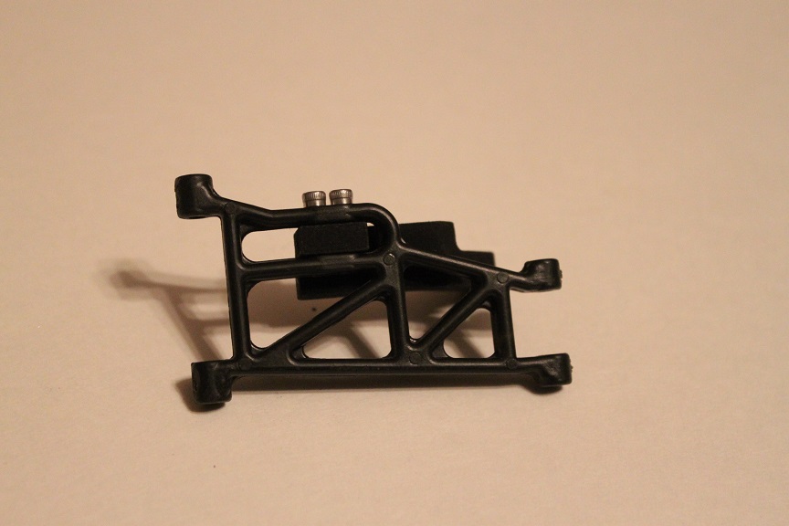

The lowering kit is custom. Barry Raborn (founder of Bullet Racing) used to custom make all kinds of things. I found a couple of rear lowering towers in his boxes of parts and thought that one would be perfect for this build. I also found a front lowering kit too but it was quite crude. The stock front tower is replaced by a new shorter one that lays the shocks over. Barry used graphite mounts screwed onto the front of the arms to fully allow the shocks to lay down. The problem was that you really had to limit overall steering throw since the tires would easily hit the shock. I didn't like this setup so I designed a new mount that could be 3D printed. It lines up the shocks in a straight line as viewed from the top but the shocks now mount to the front of the mount rather than the rear.
Here are some photos of his solution and mine. Ignore the location of the screw in his graphite lower mount. It points forwards but I quickly mounted it to an arm to take a picture of and didn't pay attention. The new mounts look and work perfectly. It only took me about 20 minutes to design and load them to Shapeways. These are the very first prints and they are perfect!
More to come on this car. The front bulkhead will be replaced by a black one. I have new 8-32 screws on order that are anodized in red to match the wheels and JCar DD. I've still got a few e-clips to install and some superglue to get off of the chassis. Someone had actually glued the servo mounts to the chassis.

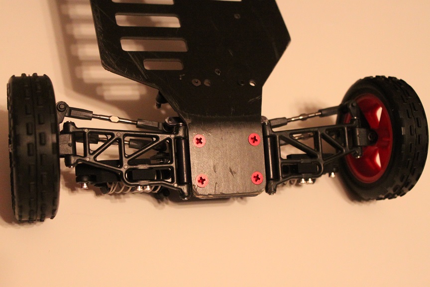

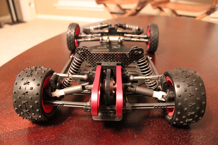

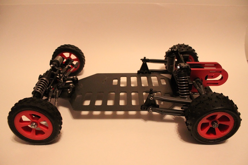

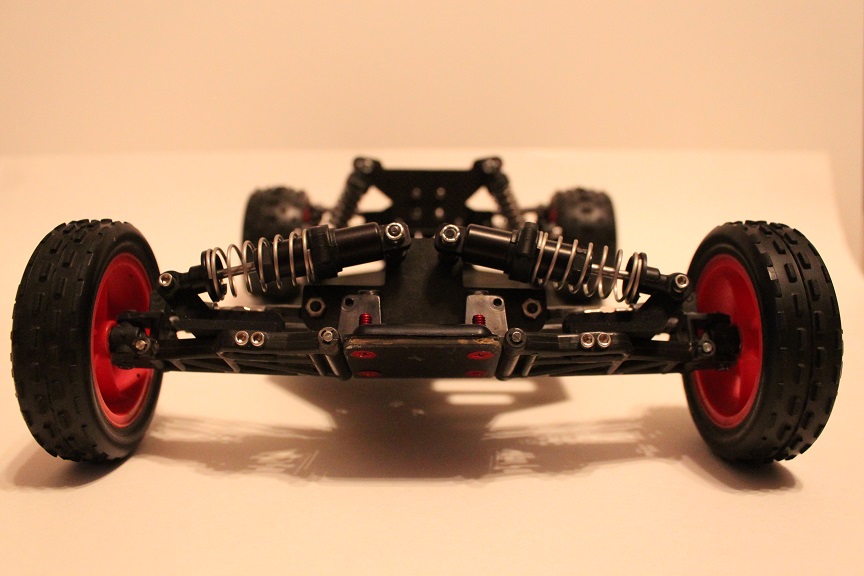

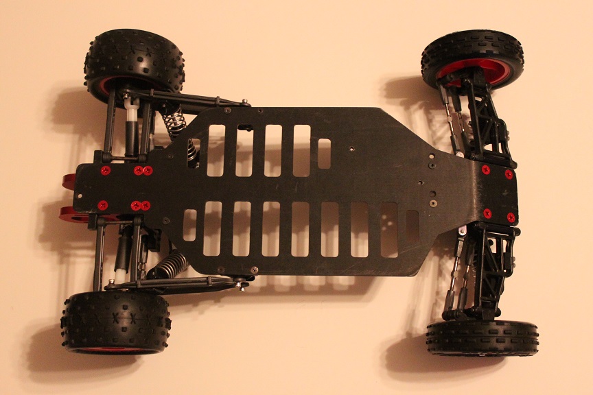

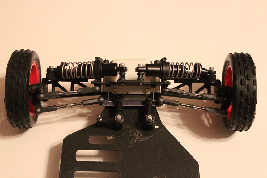

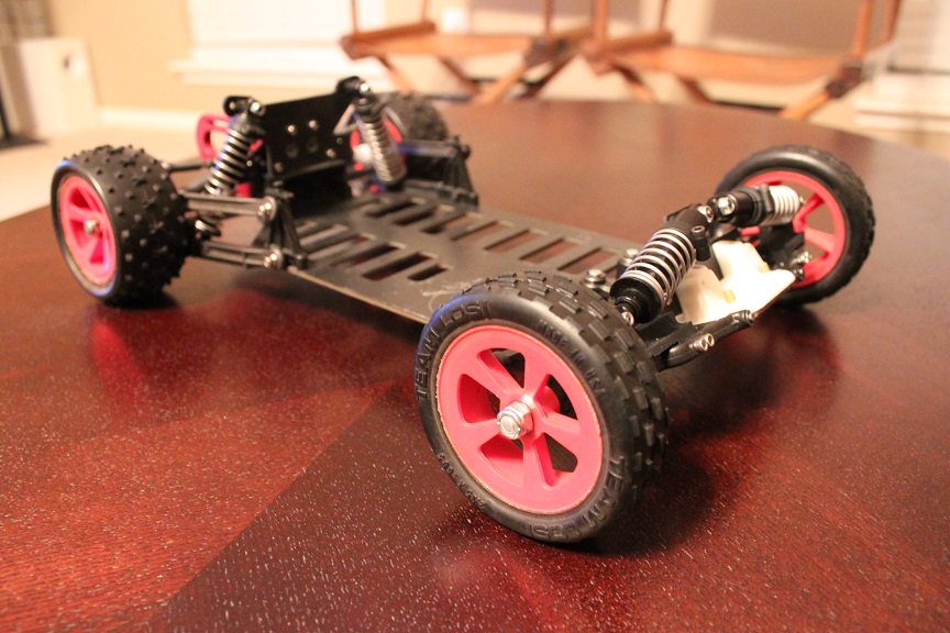

These are the final shots of the car as I'll have it. I suspect it will just sit on a shelf as a display so I doubt it'll ever have a body or will run again. We don't have dirt oval here anyways. You never know though.
The front bulkhead is now black and the 8-32 screws are now red to match the red JCAR direct drive and the red wheels. I really like this car so it's hard to let it go. At least I get visitation rights!

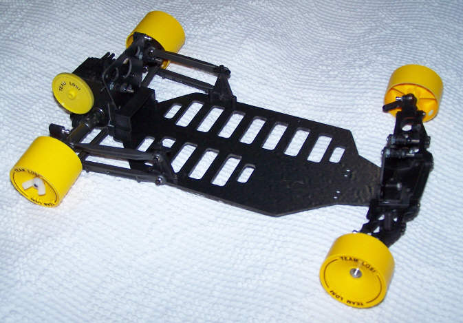

I also have that chassis, but I always thought it was a composite craft. Mine is currently sitting on a shelf waiting to be completed. Originally wanted to d a red car to match the bell cranks, but I couldn't find the rear wheels to match. Had a set of yellows...so I went with that instead. Latest plan was to get a set of the re-released A&L bell cranks since the yellow is now closer to a losi yellow instead of the florescent yellow.
