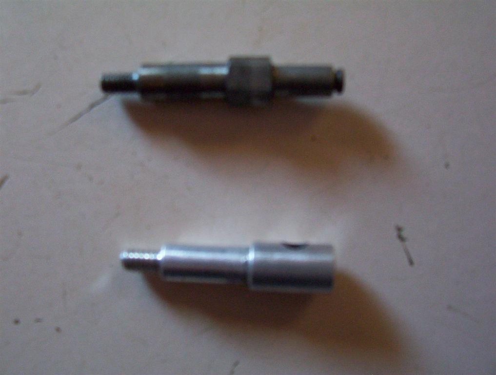

Re: turnbuckle camber
Hi ntstock93,
Sorry the pic is a bit fussy but,
6216 uses a Hex axle same as one at the top of the pic.
6221 also available in white 6225, uses a aluminum axle same as bottom of pic.
Cheers, Dave.
Cheers, Dave.
