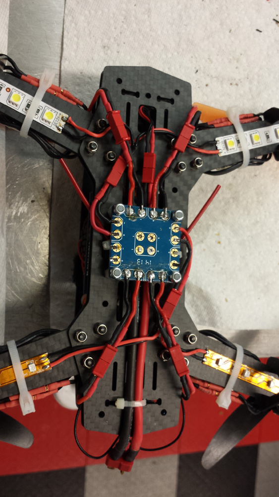

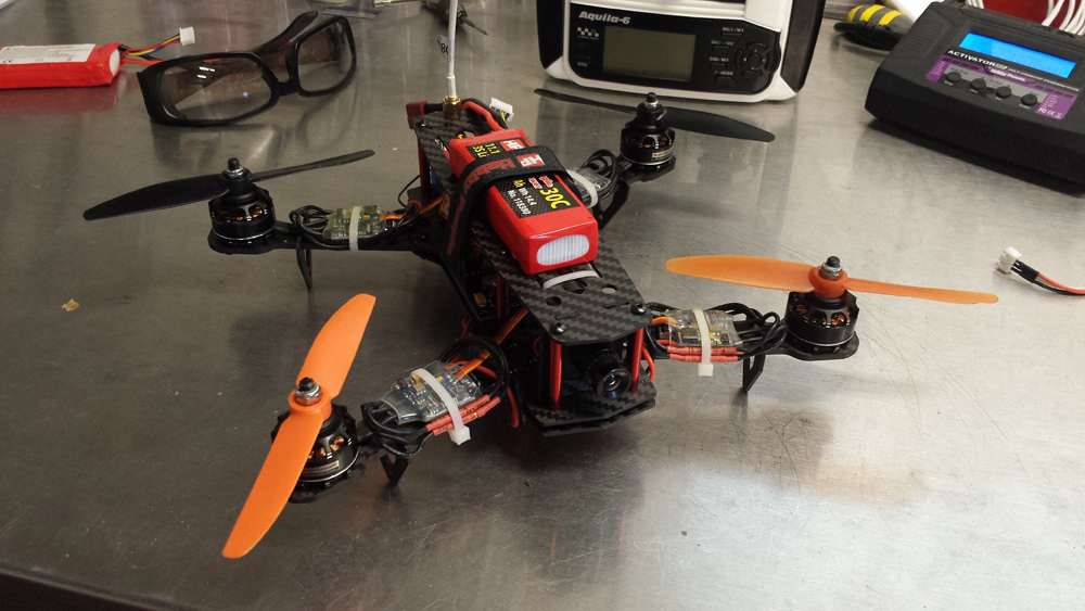

About a year ago I bought a $40 rtf quad from my LHS. From there I bought a couple more RTF quads and have been really enjoying them, but eventually found their limits. So I decided to take the plunge and build my own. It's a 250 size "H" quad set up for FPV and aireal video. The frame is a ZMR250 and I'm using 2204 2300kV motors, a kk2.1.5 flight controller, 12A ESCs, and an Airtronics radio system. Not shown in the pictures is my Mobius action cam, which mounts up front on top. For FPV, I'm using the Skyzone plug-and-play set from Hobby King, which I'm quite happy with for the price ($100). So far I've only flown about 5-6 packs though it, but it's really powerful and stable, more than enough power with this setup, even with 5x3 props. There is plenty of room for 6" props, and I've flown it a couple times with 6X4.5's, but honestly it was a bit much for me since I'm still getting used to it, so for now I'm sticking with the 5x3's. Haven't flown fpv with this one yet as I'm still getting used to it.
I've added 3LED's to the bottom of each arm, white up front and red in back for visibility and orientation. I do most of my flying at night (non-fpv), which is a total blast.
