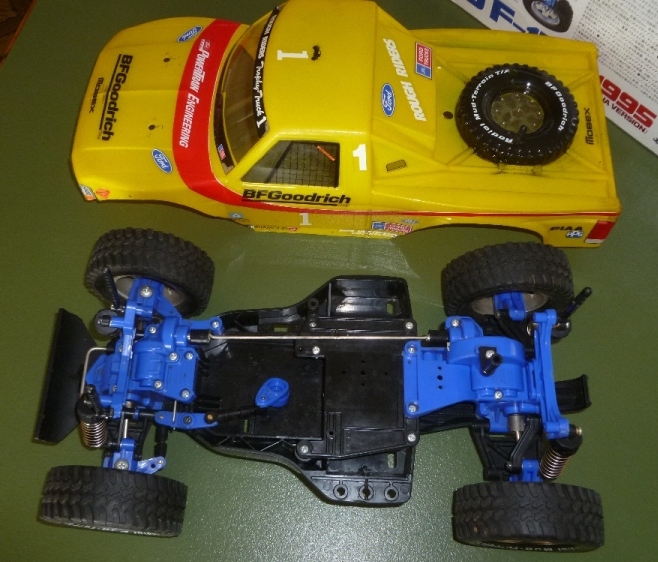

Posts: 3652
Has thanked: 1695 times
Been thanked: 1125 times
Re: TA-02T Ford Ranger
Jeff,
Looks a lot like the one I just got myself, apart from mine being a blue chassis..... need to find replacement front and rear shock towers on mine, both came broken :x

Incredible_Serious wrote:Jeff,
Nice! That looks really cool with the blue parts Alex. Funny, mine had a broken rear tower too. I picked up parts tree B, TAM50478 to replace the rear tower from the bay for 12 bucks. I don't remember seeing any blue one though when I did my search.

I started tearing everything apart today and degreased everything. It was a tedious task but needed to be done.
Found out the motor mount was broken as well. Good thing a new one is on the B tree I ordered. Also the chassis was seriously warped from heat from the battery at some point. The parts chassis will be swapped out for the bad one.
