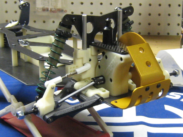

There is a gold motor guard that bold between motor plate and chassis on the graphite team cars.Keyz wrote:Hey all,
Regarding the rear motor plate, is there some kind of seperate gold aluminium piece that bolts between the chassis and the motor plate heatsink? As in the tub has the bend in it at the back, but the graphite chassis are flat, so is there another bent aluminium piece that replicates the bent rear of the tub?
Jim
i have a mint graphite 6 gears, it does not have the motor guard: the chassis is drilled but not countersunk for it.
This part is really hard to find : last time I see one on the bay, it goes around 50$.

I do still have some MINT black rear motor guards for sale. Gold ones are a little bit difficult to find and pricy. PM me if any interest

Re: Graphite Chassis Questions
did you put that "one" battery box whole in the chassis, or did you get it like that?
this is the motor guard.
