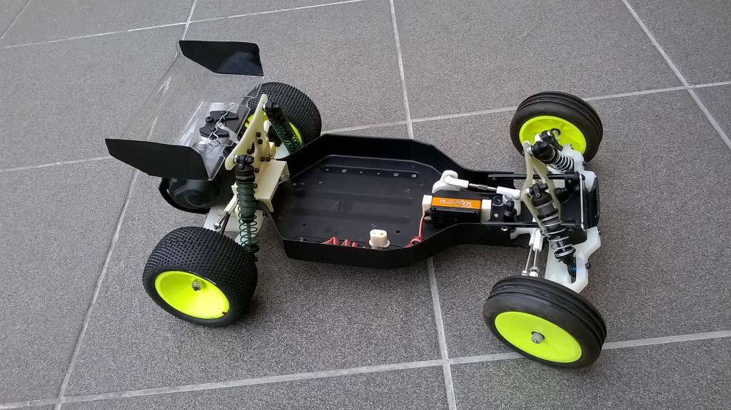

1. INTRO
Build is closely related to "Scr8p's Worlds Re-re / 91 Worlds Conversion"

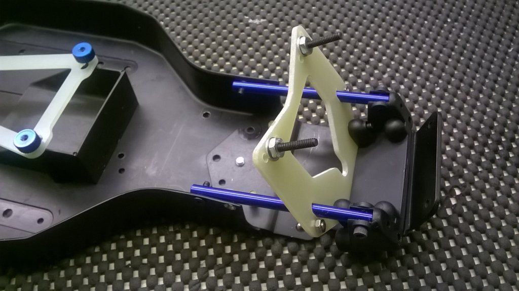

2. PARTS
#6002 Worlds Car Kit
#7305 Nose plate (10T/GT) (Thanks DennisM !!)
#7207 Front bulkhead (10T/GT)
#7315 Nose brace tubes (10T/GT)

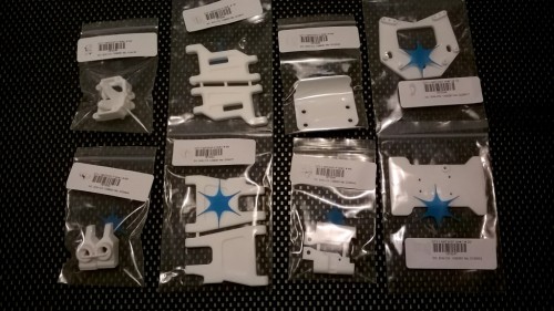

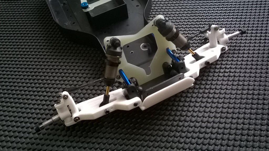

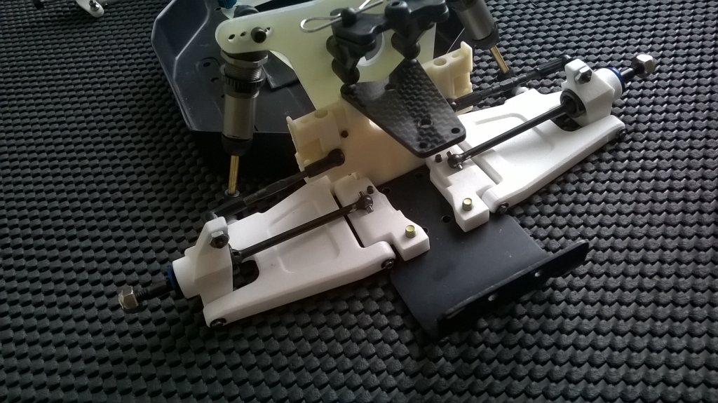

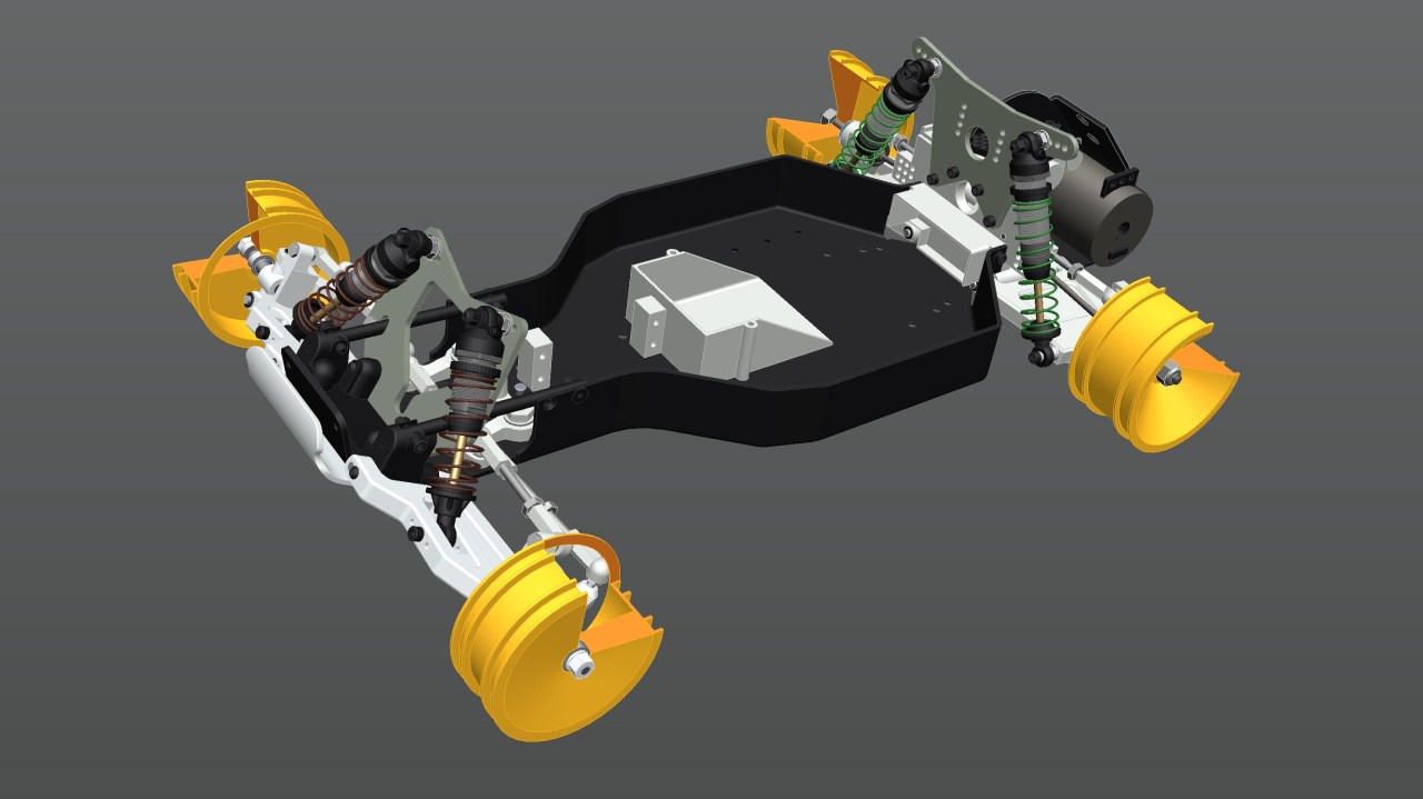

Front shock tower NIX80031 and rear tower NIX63772 machined by gomachv was used on this build. SLS parts:
'91 Worlds Conversion - Caster and Steering Blocks
'91 Worlds Conversion - Rear Hubs 2.0
'91 Worlds Conversion - Front Arms 2.0
'91 Worlds Conversion - Rear Arms 2.0
Bumper 2.0 for RC10T nose

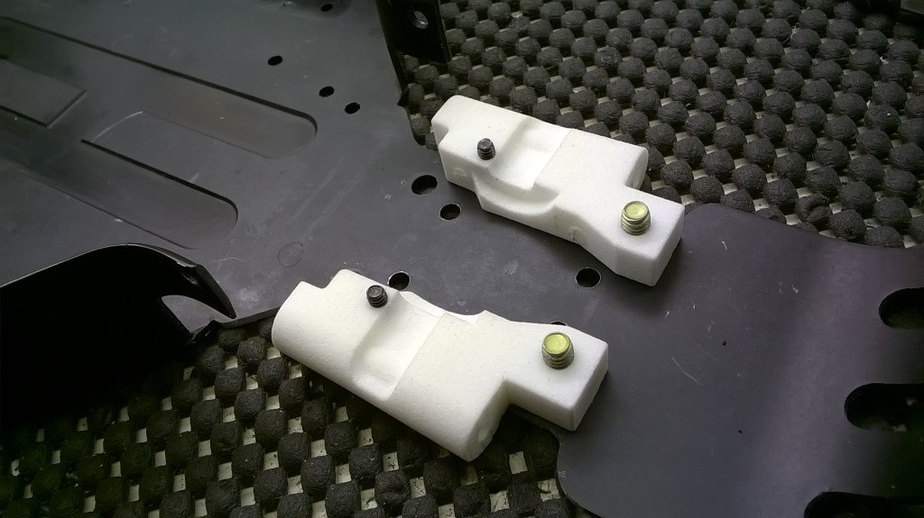

'91 Worlds Conversion - Rear Arm 3-3 Mounts
NIX80031 Front Tower Cutting Template (not needed if CNC cut parts used)
'91 Worlds Conversion - Chassis Cutting Template

Looks great so far Niki!

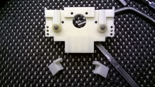

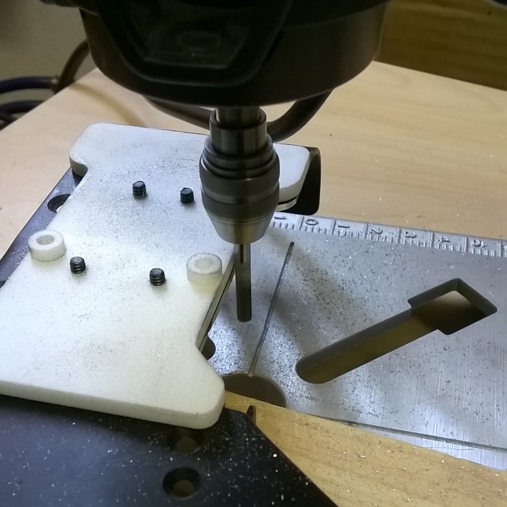

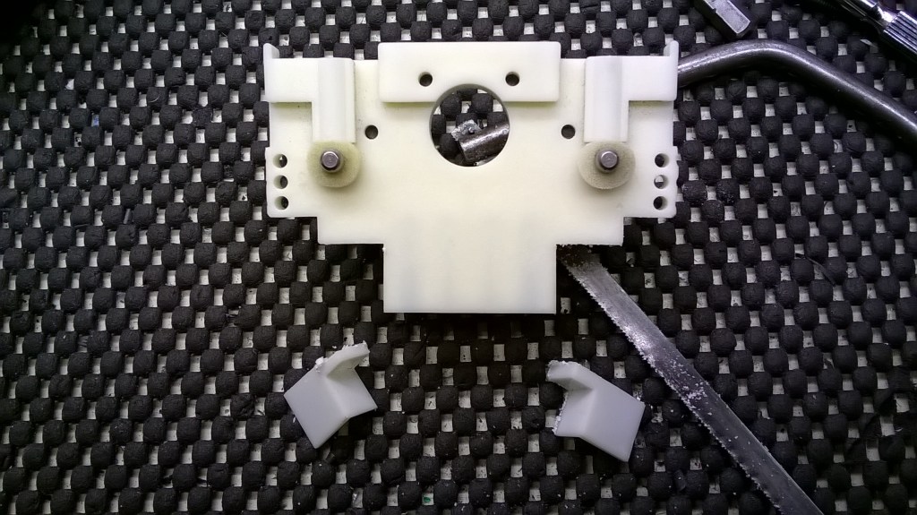

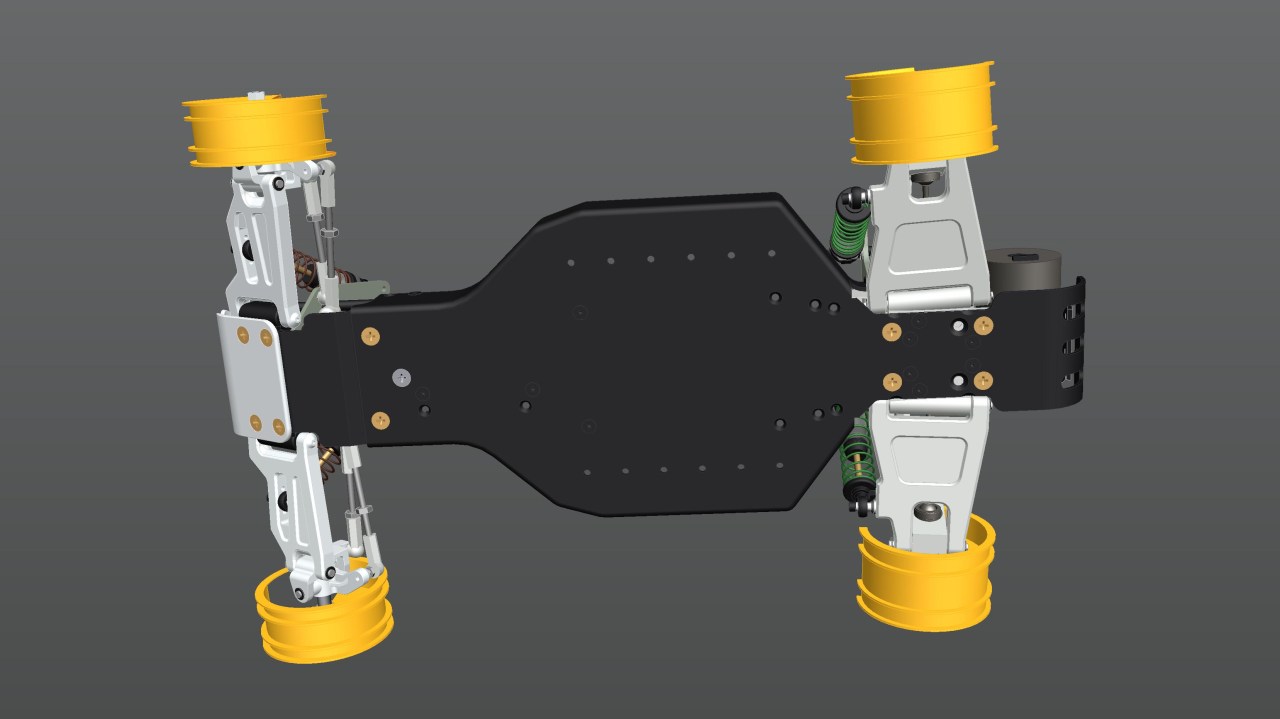

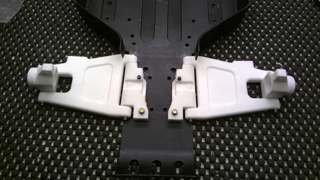

One thing you will most likely run into is the right rear arm mount and motor plate hitting by the lower gear cover hole because of the squared off shape of the mount. Either the mount or the plate has to be clearance a little bit. Since my parts were already dyed I massaged the motor plate and gear cover.

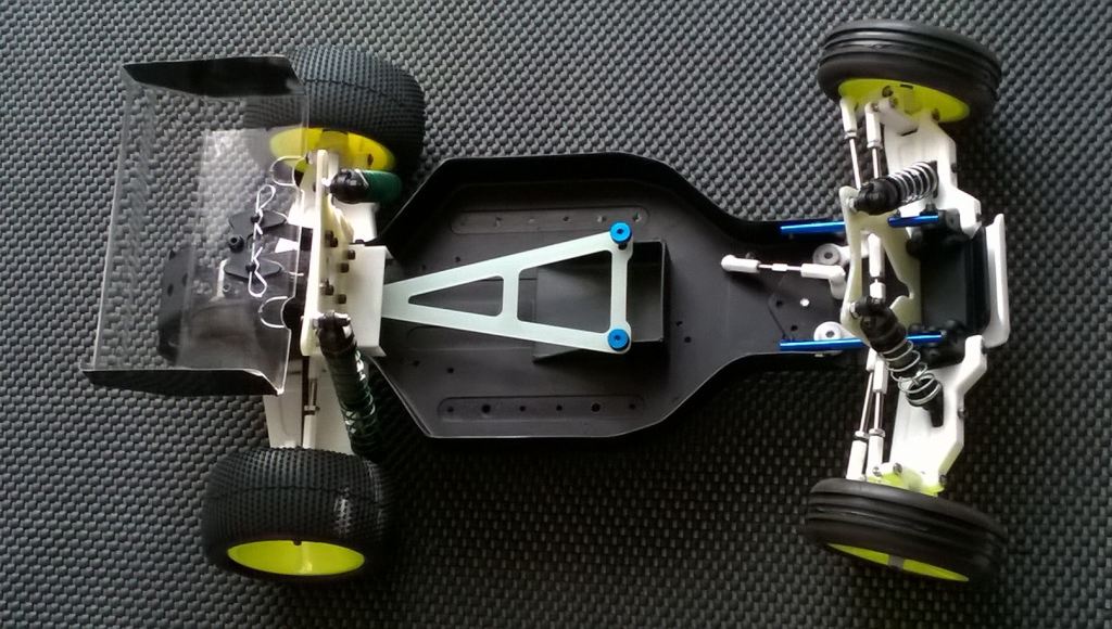

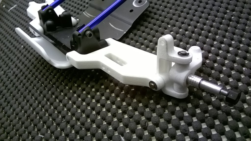

Just curious why you needed to narrow the chassis in the back? Isn't it going to be really weak with those arm mounts so close to the edge too?
It looks amazing, and I'm guessing it could never be a racer, just a shelf queen.

It's a copy of the rpm worlds conversion. Based on the rc10 stealth cars..... narrow chassis, long arms.

It will definitely be a runner ! For a long time I have been interested how '91 Worlds conversion tub RC10 actually runs. Soon I will find outRC104ever wrote:...I'm guessing it could never be a racer, just a shelf queen.
And best thing is I don't need to worry about rare and pricy original conversion parts. New spares can be printed any time.
-Niki-

Motor plate hitting arm mount issue solved. New models uploaded to Shapeways site.

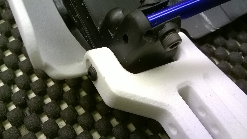

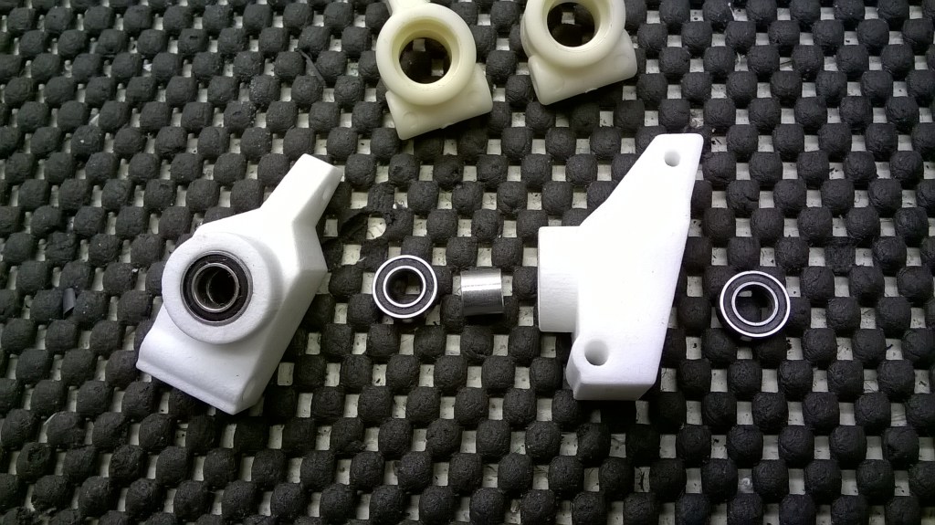

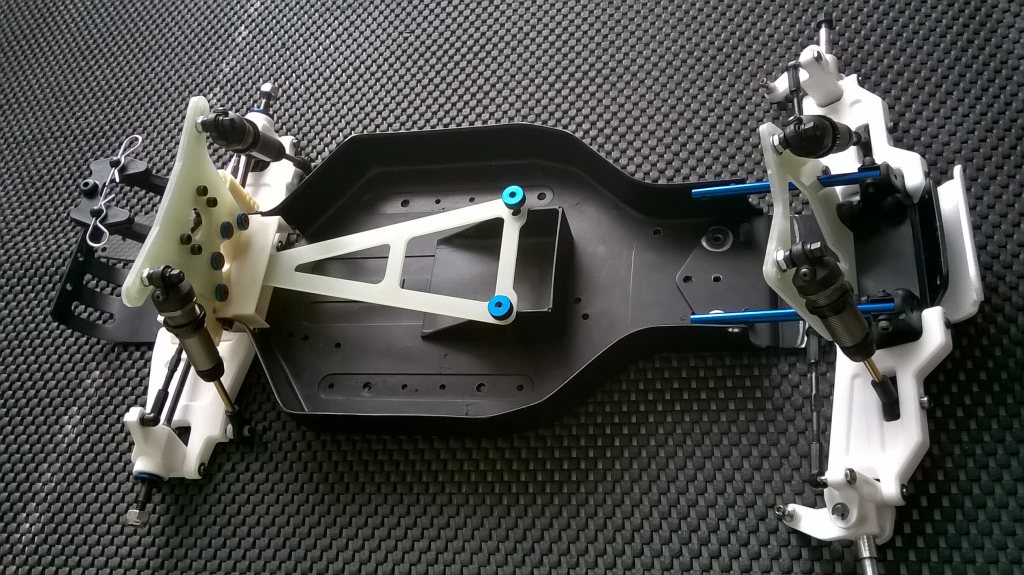

There might be a vintage race in the horizon so I desided to make a race version of this car.
Dynotech Klein arms and CustomWorks #3241 rear axle carriers will do the job.
RPM #7077 info sheet advise to use AE 25deg. caster blocks as basic set-up in front.
