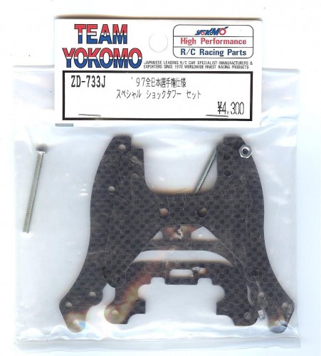

Another question. Ive just reprod the 95 wcs camber plate, is the 97 different?
Very interesting trying to duplicate Yokomo parts. Many compound arcs. As much art as engineering in the design, hard to nail every minute detail without actually reproing the design process itself.

No, there appears to be a difference:
picture courtesy of aip47-2008
