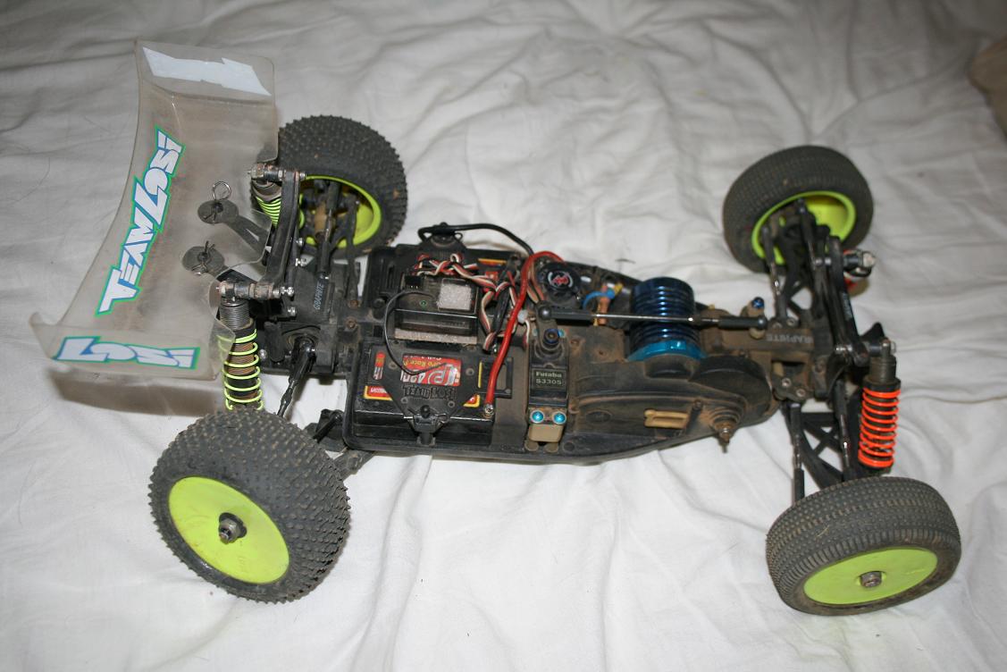

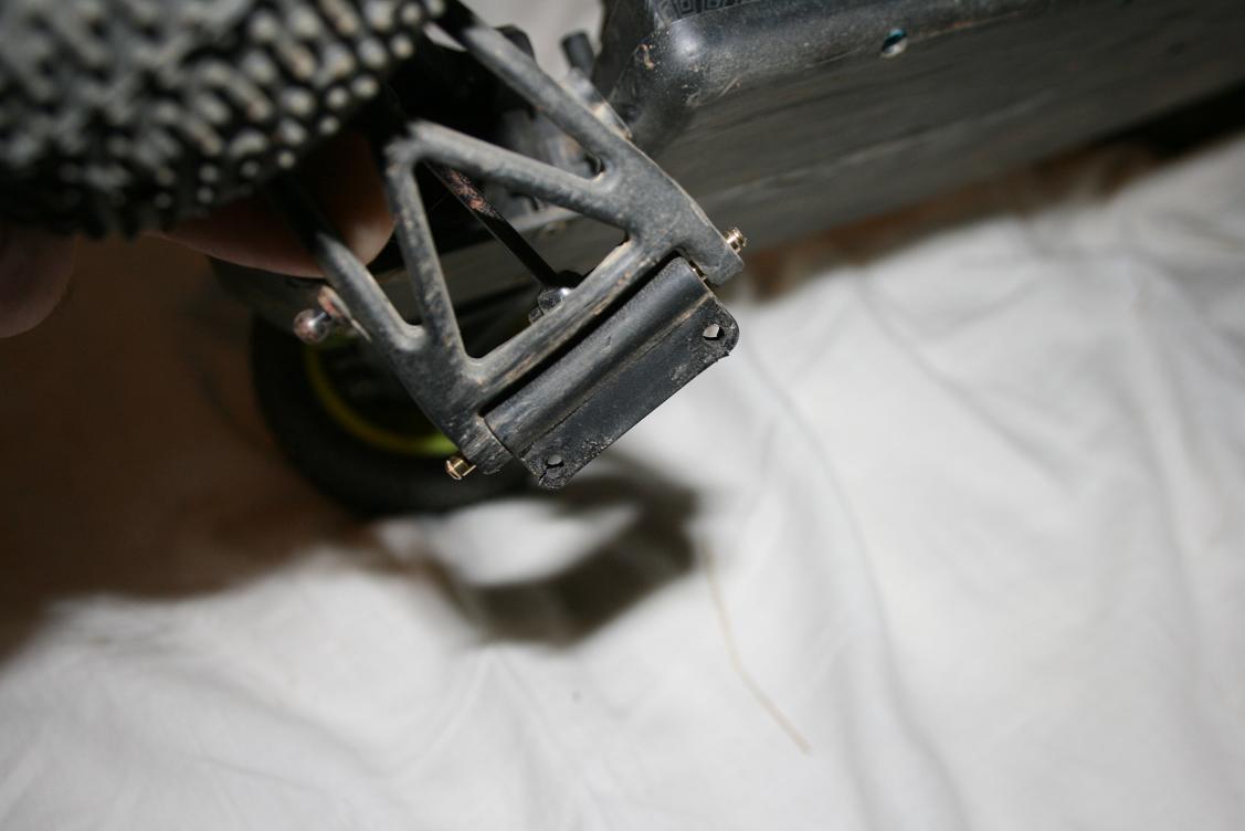

Heres my trusty XX4 fresh off the track from last night.I havent raced it much in the last 5 years but just moved close to a track and started up again and really enjoying it.Trouble is Im breaking a rear pivot block every meeting,some snap and some pull past the screws like the one in the pic.The car is fast and Ive got it working well so dont want to just buy a modern car.Is there alloy or any other stronger one made for this car?Thanks in advance.

I had one I had bought for parts awhile back that must have done this with the PO. It looked like they drilled out thru the top part of the rear bulkhead and installed longer screws with lock nuts on the top. Looked wierd and I have never really ran one of these all that hard so I really was only guessing that it was for a reason similar to yours with the screws pulling out. Now I have another one sitting here lookin alot like your picture with one broken eye on the pivot and the other sided pulling out thru. It doesn't fix the broken ones but it will keep it together until it gets broken if that helps.

you have to run a rear brace! And if the screws seat loosely in the pivot-block and rear tower, it can break the chassis...
do you have a rear almn brace? and are you running 3deg rear blocks for the xx4?
There is an option, to run a mod that use more modern xxx(t) pivot blocks, but it narrows the rear hingepin distance.

I was running the 2 degree ones but ran 0 degree last night as was all I had left.There is some alloy braces with the 3 degree conversion a2208 I bought so I will definetly be running them but they allways seem to break out at the front for me.

One of the ways I bulletproofed mine, using 3mm flatheads screws instead of the 4-40 gear.. The molded holes are already a little loose for the 4-40 hardware & will easily strip. The slight wiggle can cause the screws to backout, or increase the chance of impact to break.
This is why I keep my pivot blocks where the screw would thread into them, then continue to thread into the rear tower.
I found that the 3mm screws fit just right, no wiggle, & do easily strip.
Wiggle causes the front chassis supports (that hold the steel insert) to chip or break also. I use a tiny drop of Thin CA to glue the insert into the chassis.
I have a few other things I do too..
Plus, I water boil ALL plastic parts for ~1hr, and let them cool in the water. Re-hydrates the nylon.
Boiling fixed my constant caster block breakage.
