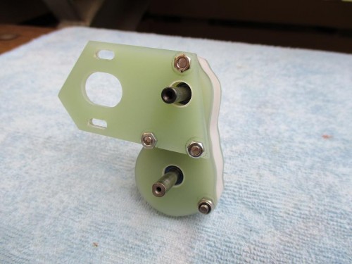

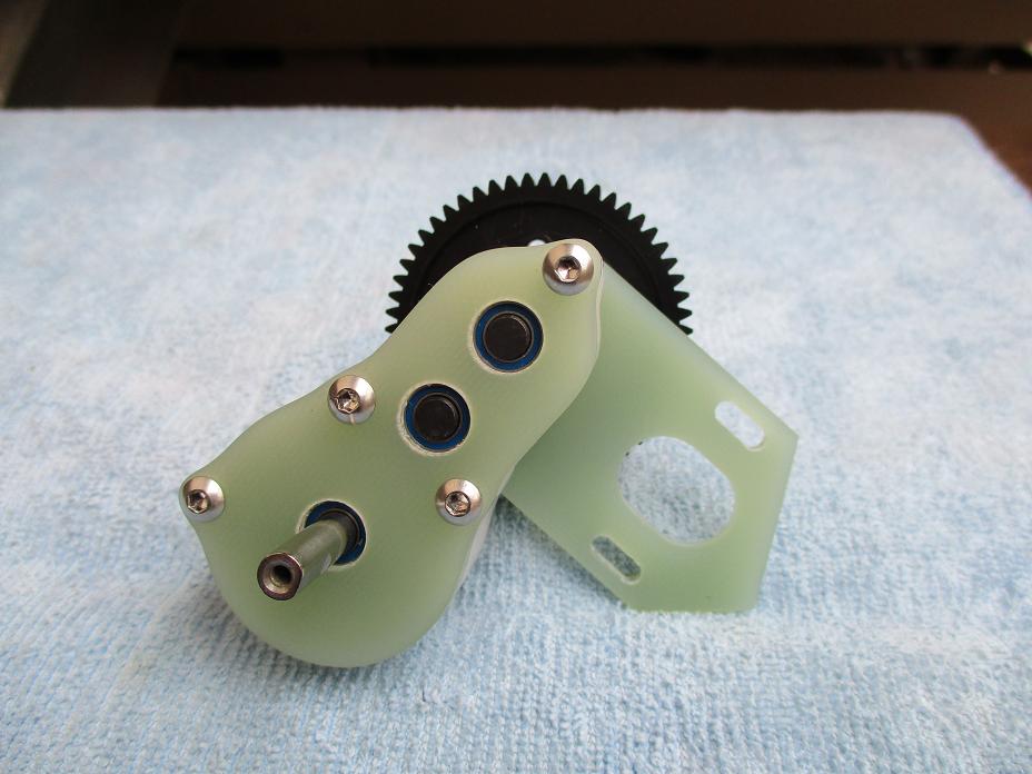

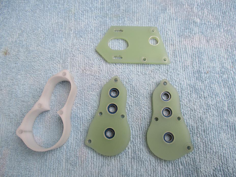

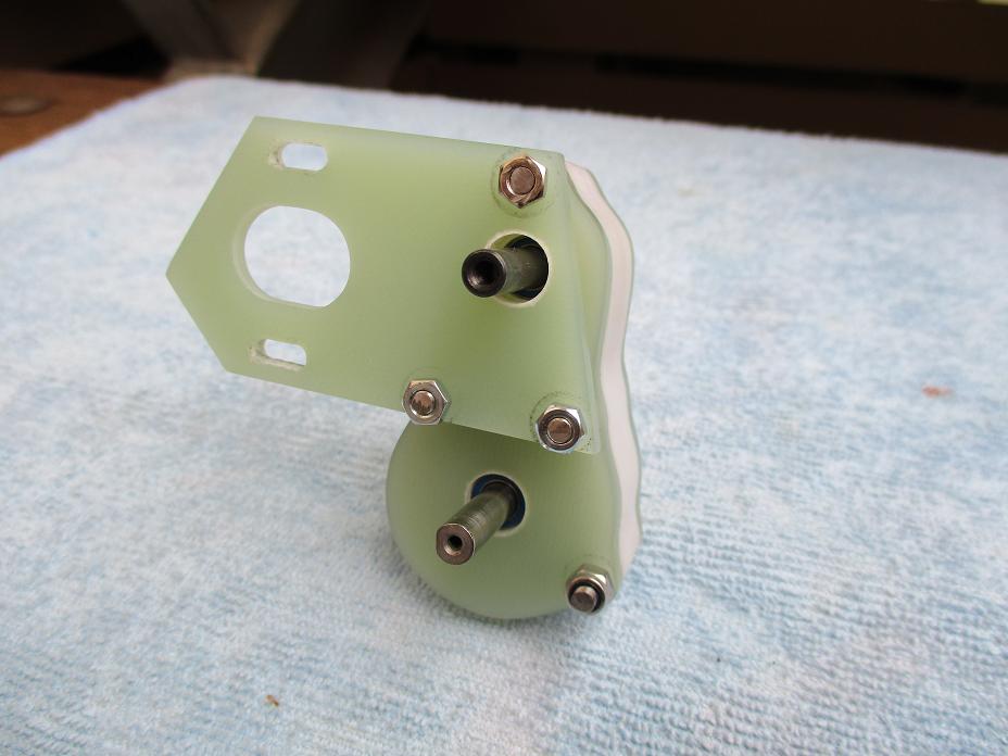

Here's some pics of a cool project I just finished. It's based on an early MIP gearbox. It uses two pieces of G10 for the sides, one piece of acetal for the centre spine and another G10 plate for the motor mount. The bearings are 8x5mm flanged.
The pieces.
And assembled with two tamiya gears and a Thorp diff.
And the other side.
Just got to make up some mounts for it now and then find something to put it in. :D

Dan, I drilled out the acetal and then finished taking out the rest with Dremel sanding drums. The drums are the longer 3/4" ones with the thicker shafts. This was all done in a bench drill press.

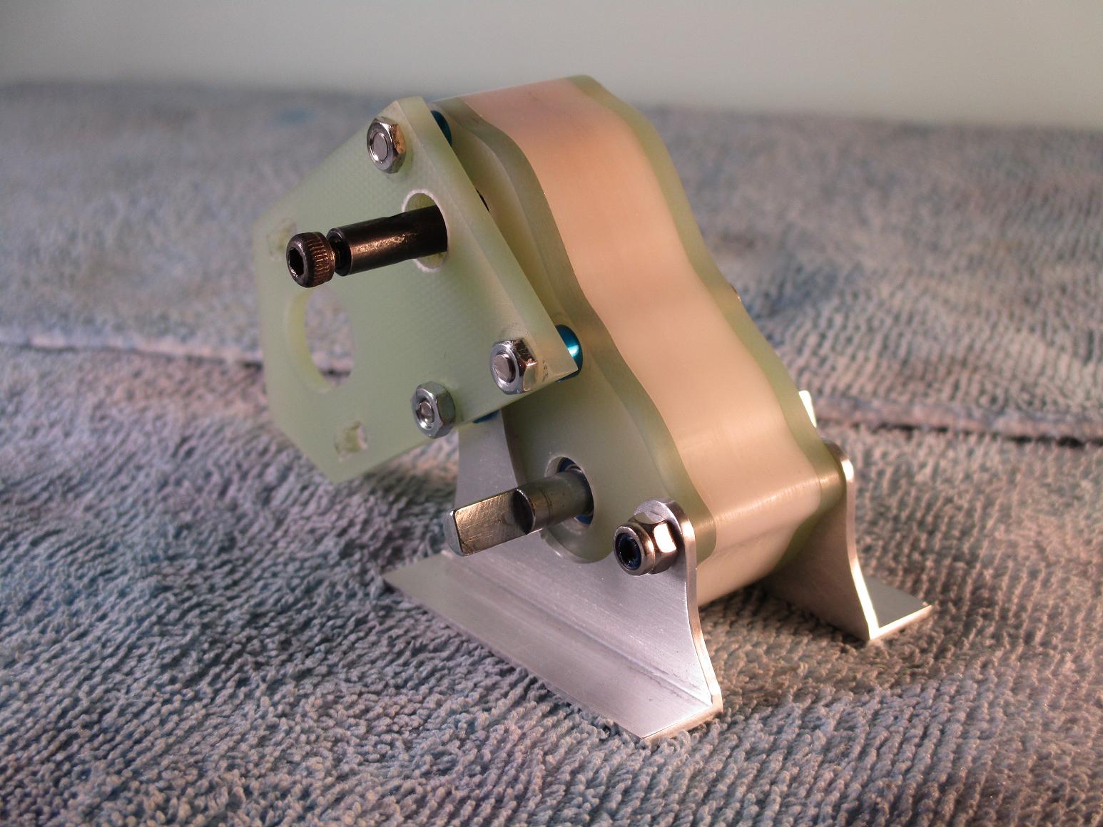

Thanks Don. That's pretty much what I had in mind for this one. Just got to duck down to the hardware store for some aluminium angle.
I certainly will Jerzi, just as soon as I make the mounts.

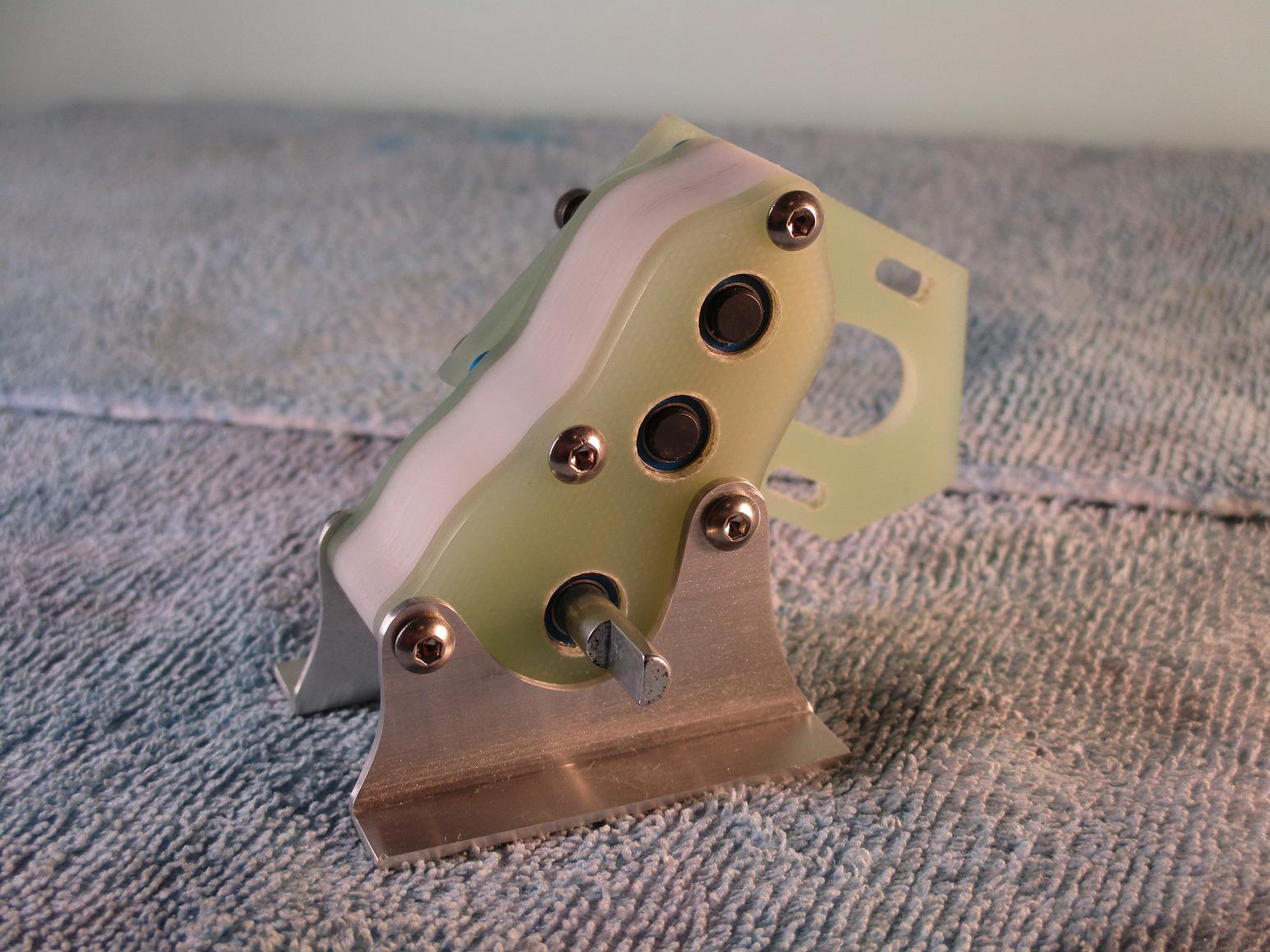

The local hardware store has angle that's 1.4mm/.055" thick. I'm going to use two of the screws for mounting as the gearbox will be angled back 30 degrees to lower the CG. That'll do the job nicely I reckon.

Finished the mounts today. I'll drill the mounting holes to bolt it to a chassis when I decide what it's going in.
